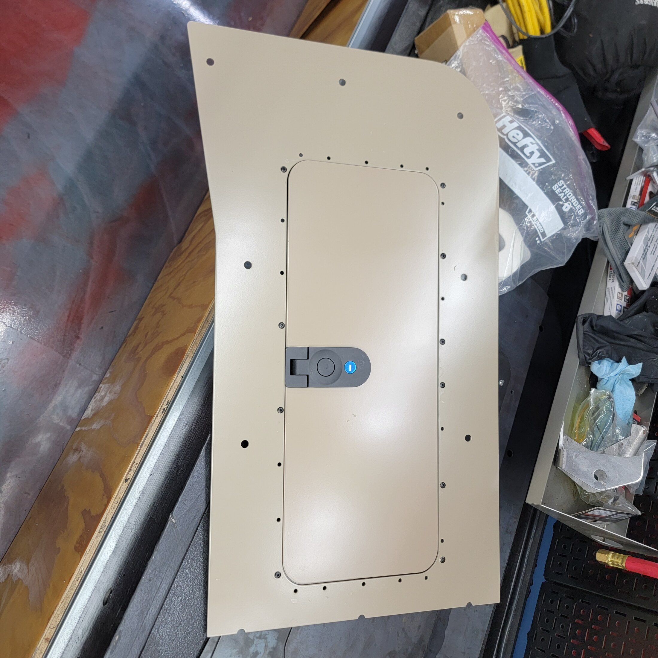

Tail gate storage: I've finished the design. Played with a ton of ideas for the hinges but ultimately decided to undermount the hinge and cut a notch for the barrel. There are lower profile hinges available but the ones I chose are fiction hold, meaning there's no need for a strut or strap to hold it open. I'll deal with the plastic gap filler flap.

Design is finished and I have the first complete, perfect version painted and ready to install on to my truck. I went with Krylon camo tan color, which is a perfect match for the 100's tan interior. Same stuff I used for my SGII mount from BenCC.
Since my truck isn't back yet and won't be until next week (ugh...), it'll be a bit until I can put it on.
But here's a finished pic of one side:
BTW that air riveter... ****ing awesome. I feel for you plebes that have to use a hand operated riveter. I was one of you until last week, and now I'm so much better.
