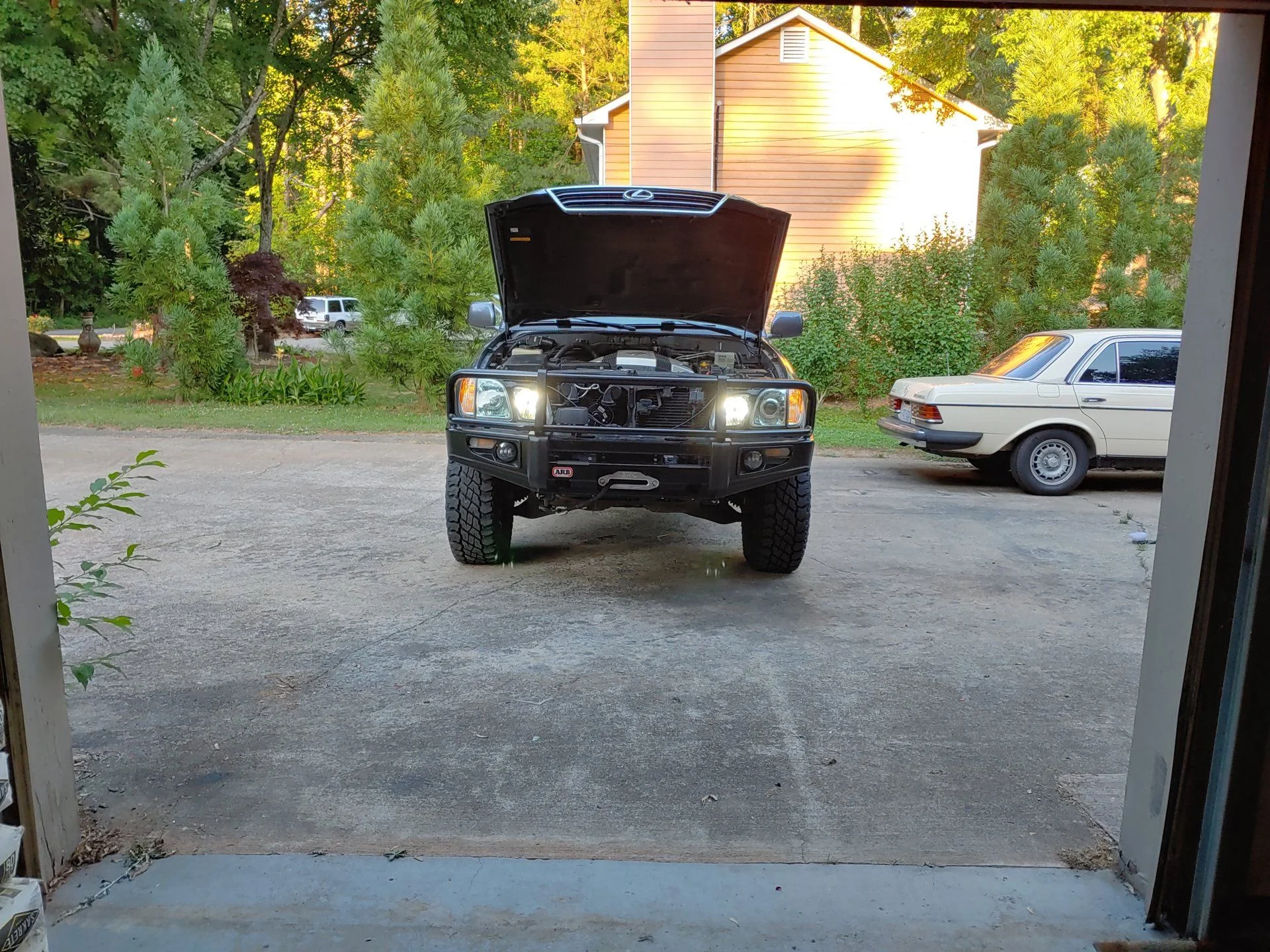

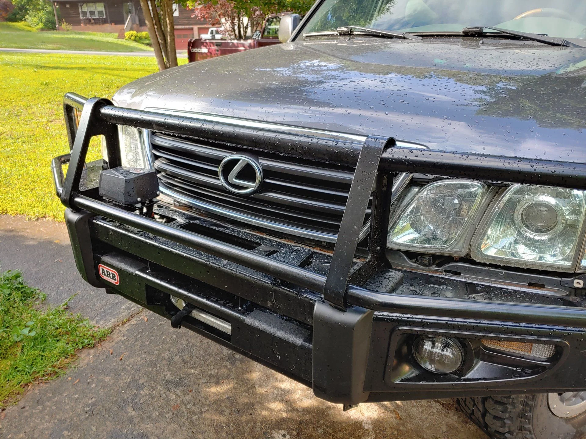

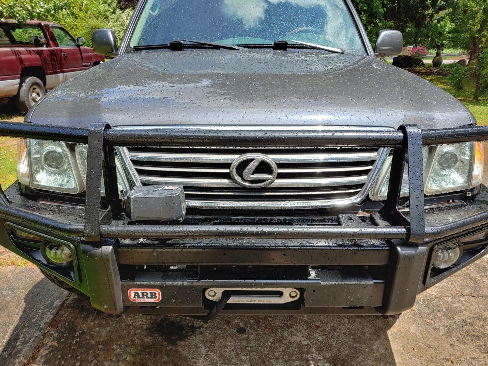

I also got my winch control box mounted. I wanted an external location that I wouldn't have to open the hood to get to. I made use of one of the light mounting brackets on my ARB and built a bracket to bolt to the bumper, then screw the box on to. I think it worked out well for a 15-minute design and build.

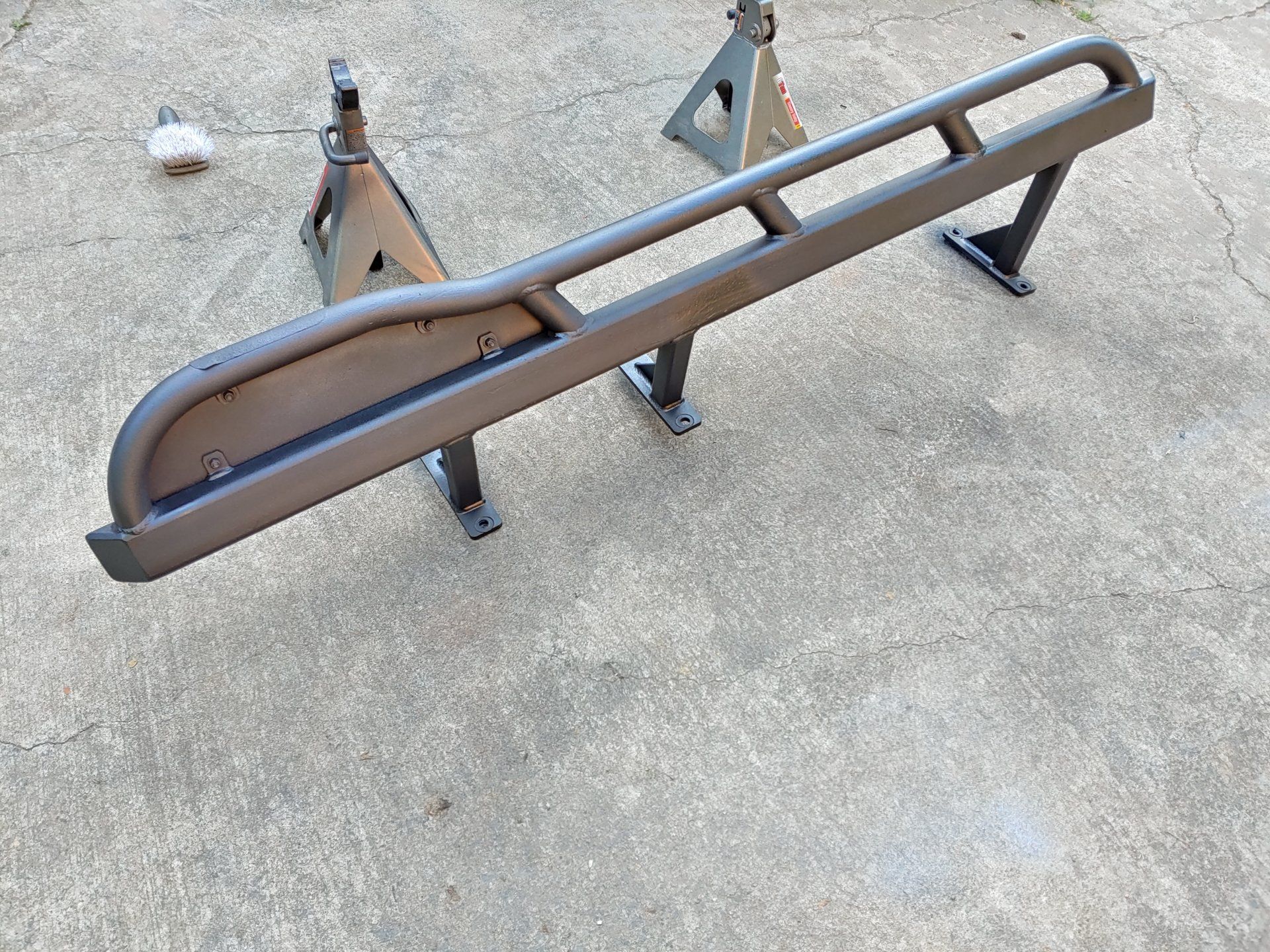

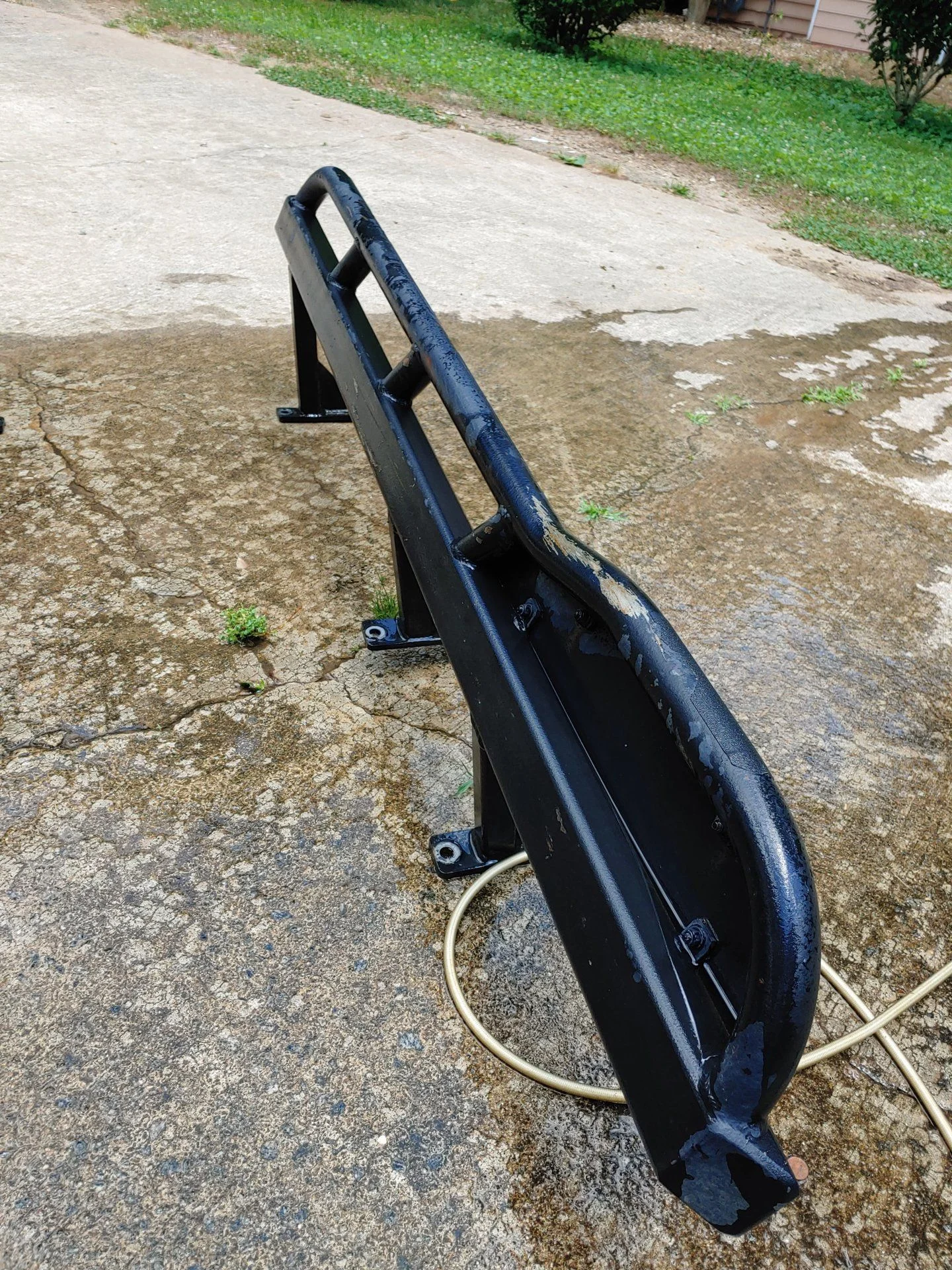

This weekend I did a respray of my sliders. After only 5 months and just as many if not a few more trail days, they'd seen some use. It wasn't until my most recent trail ride, though, that I had noticeable damage away from the bottom edge for the first time. I hit the rusty spots with some rust converter primer and topped off with rubberized bed coating and satin black paint for consistency.

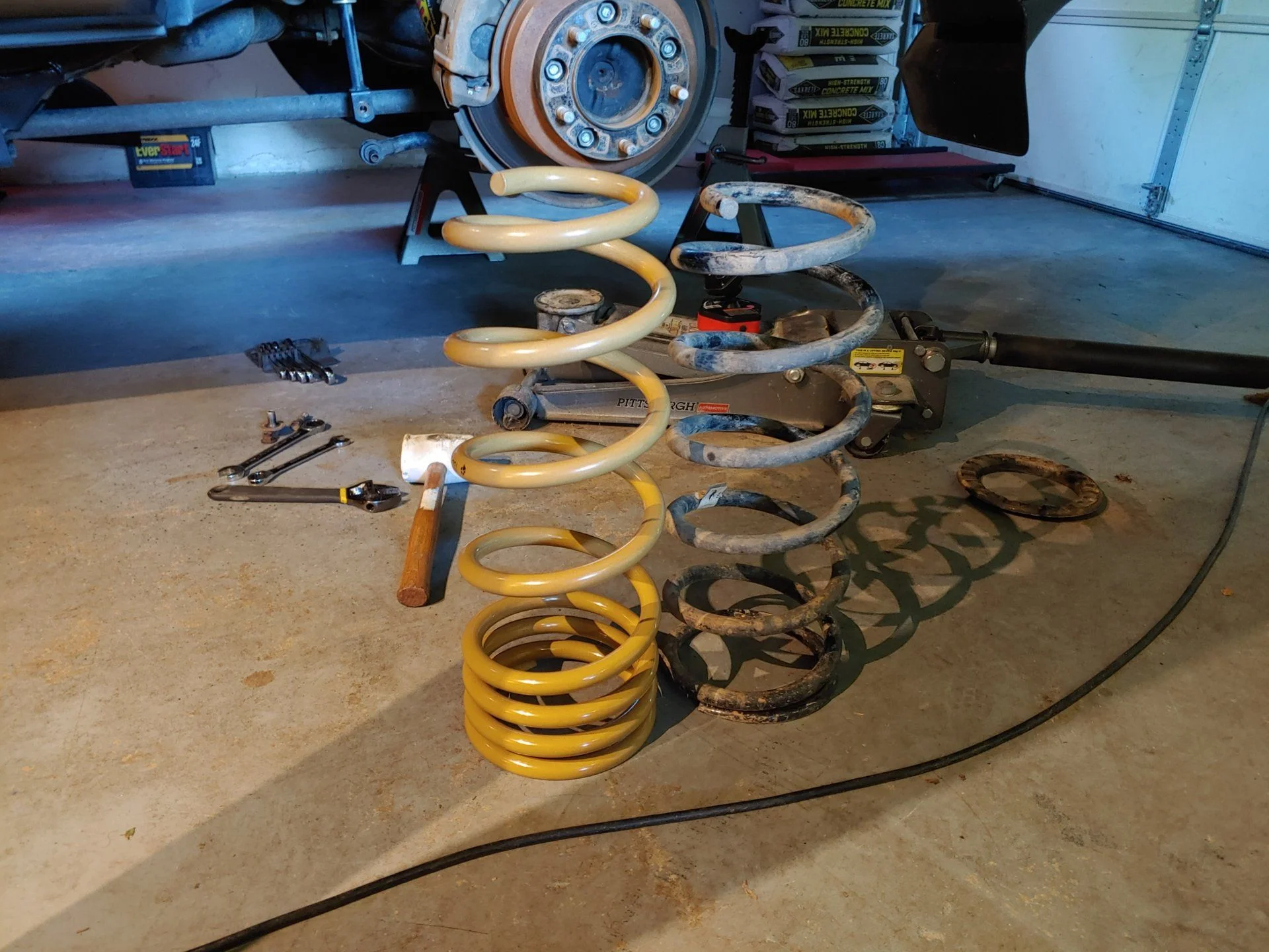

Swapped in a pair of Tough Dog gold medium rate coils, replacing a set of OME 865. The 865 were great, very comfy, but after being broken in a bit, they weren't quite up to the task of holding my extra weight up. I'm a fan of the gold coils so far- noticeably less lean in turns and a bit more stable at speed. If anyone's interested in these 865 coils for a stock-weight truck, PM me. I'll sell the pair with a brand new pair of 10mm spacer rings for $100 local.

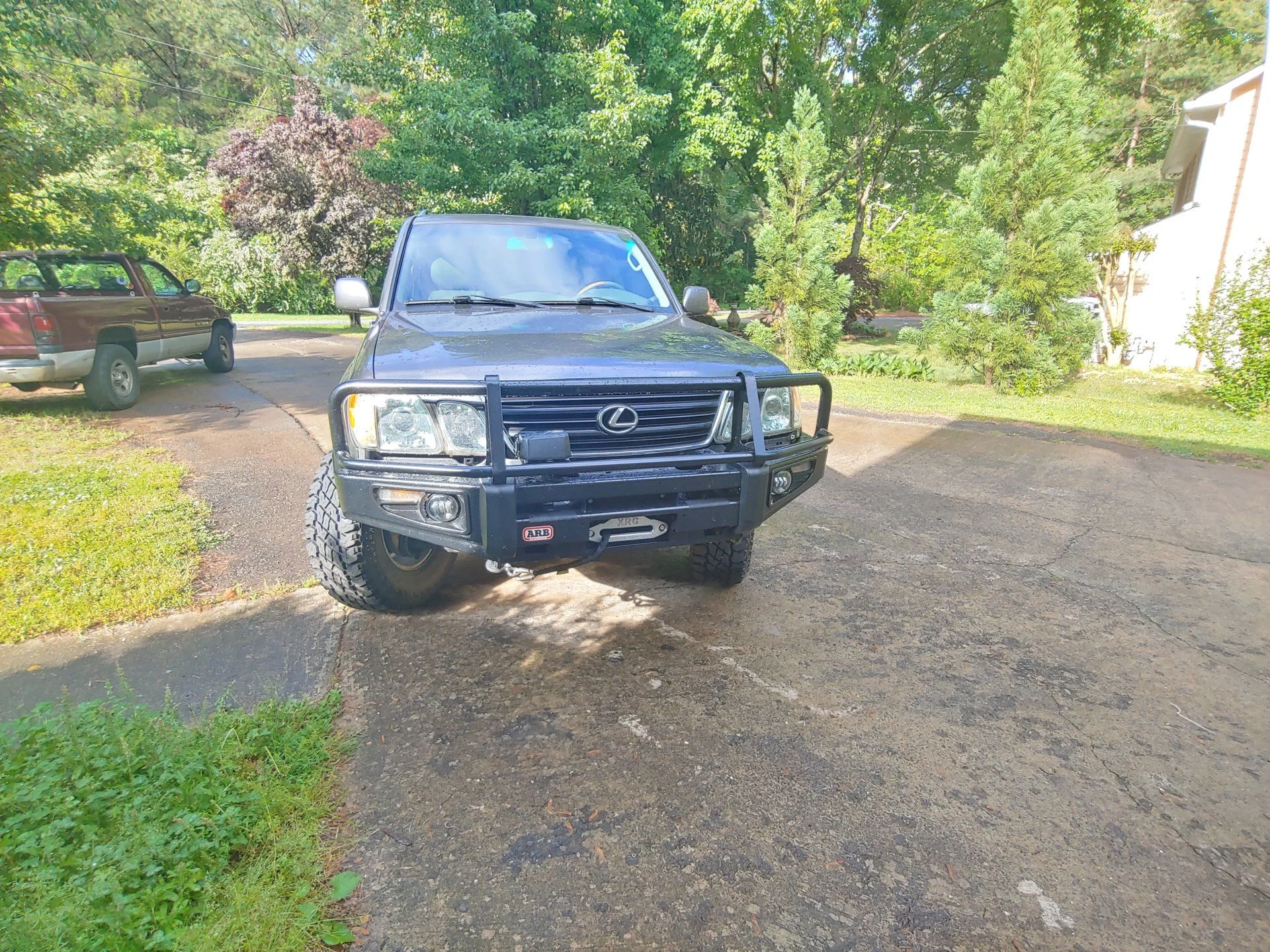

Gerry took an L on Beasley Knob in N GA a few weeks ago. I'm none too thrilled with the body damage and it won't be staying long.

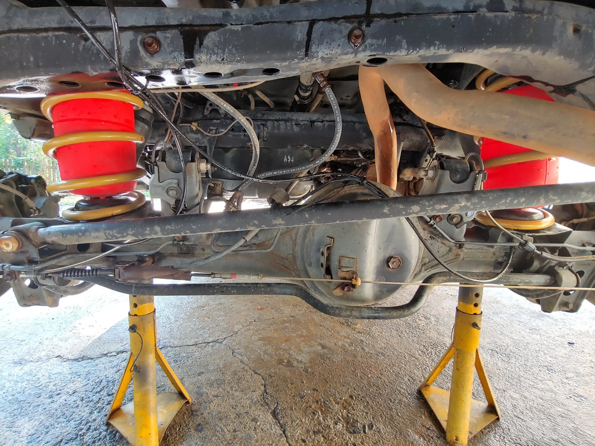

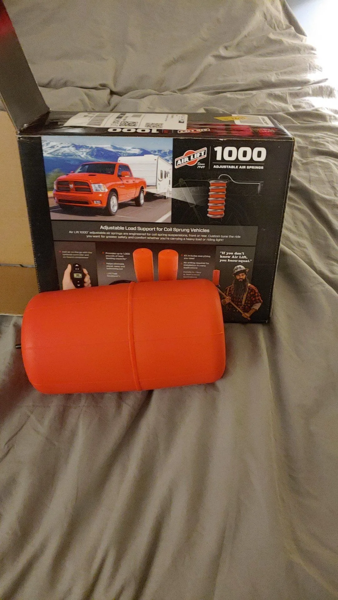

I also have a set of Airlift 1000 bags to go into the rear. I'll be pulling the wheels and installing these over the weekend.

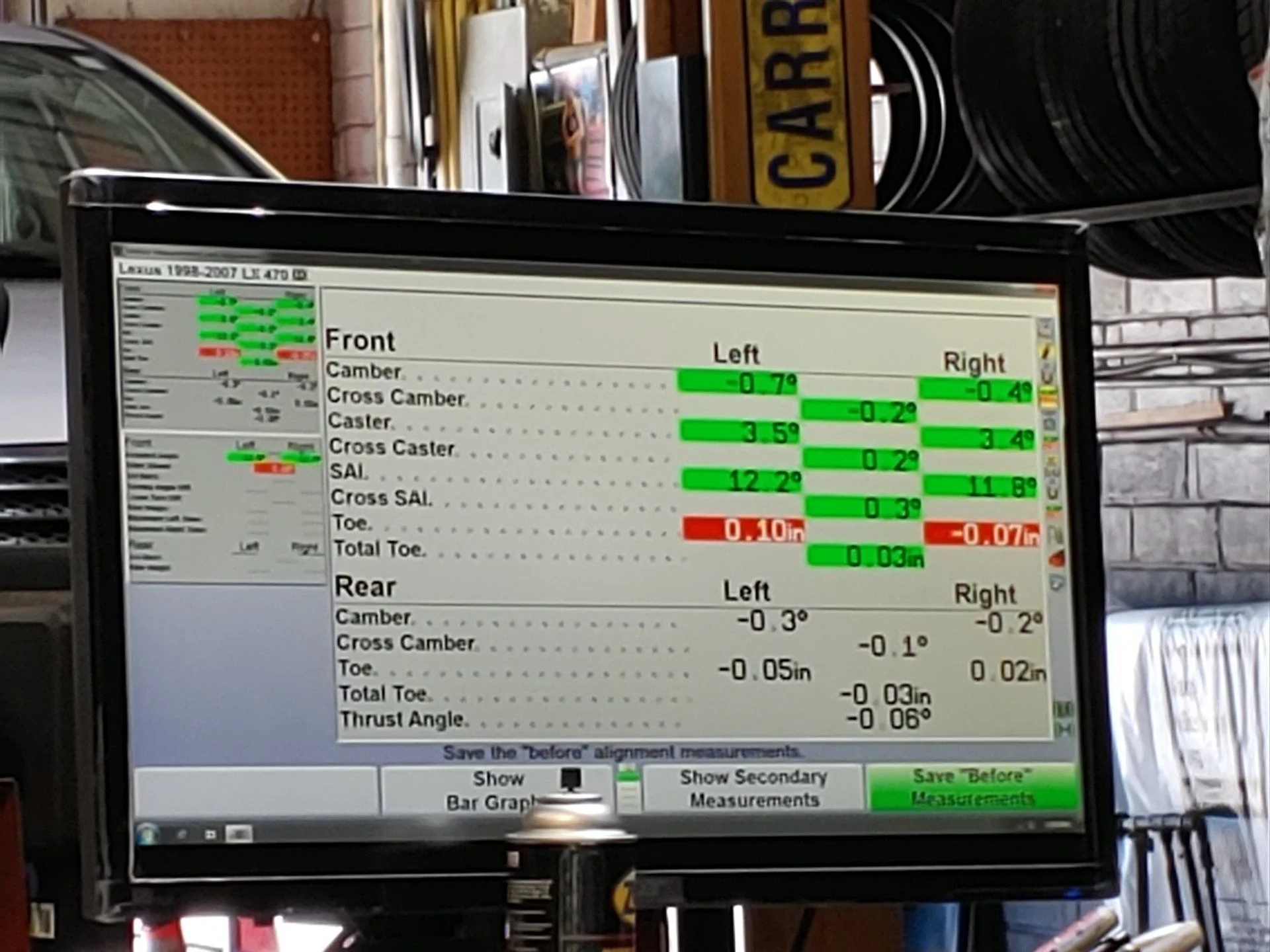

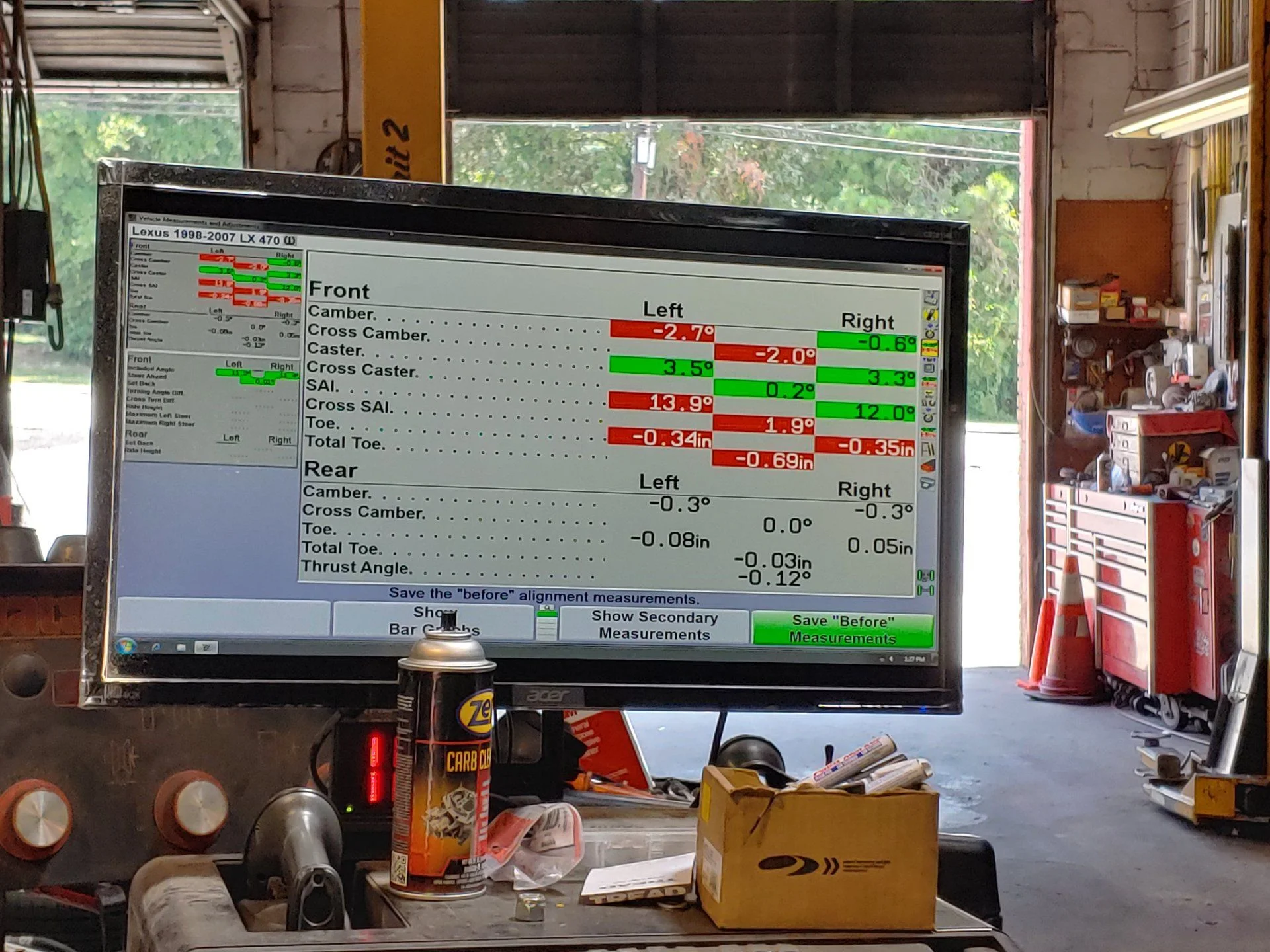

Gerry did great on the trip to Uwharrie. I did manage to tweak one of my SPC UCAs and throw my alignment off, but nothing a trip to Gran Turismo East couldn't fix.

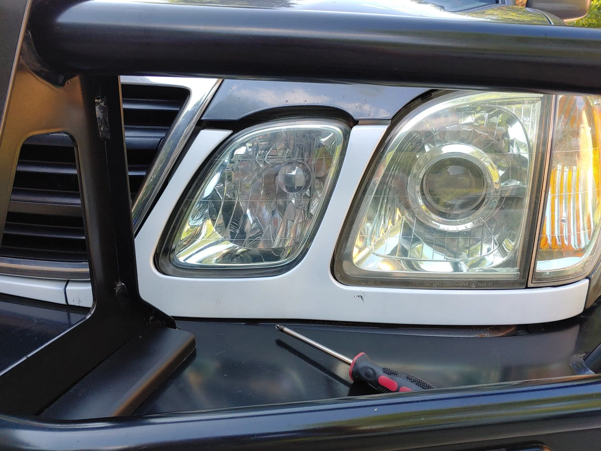

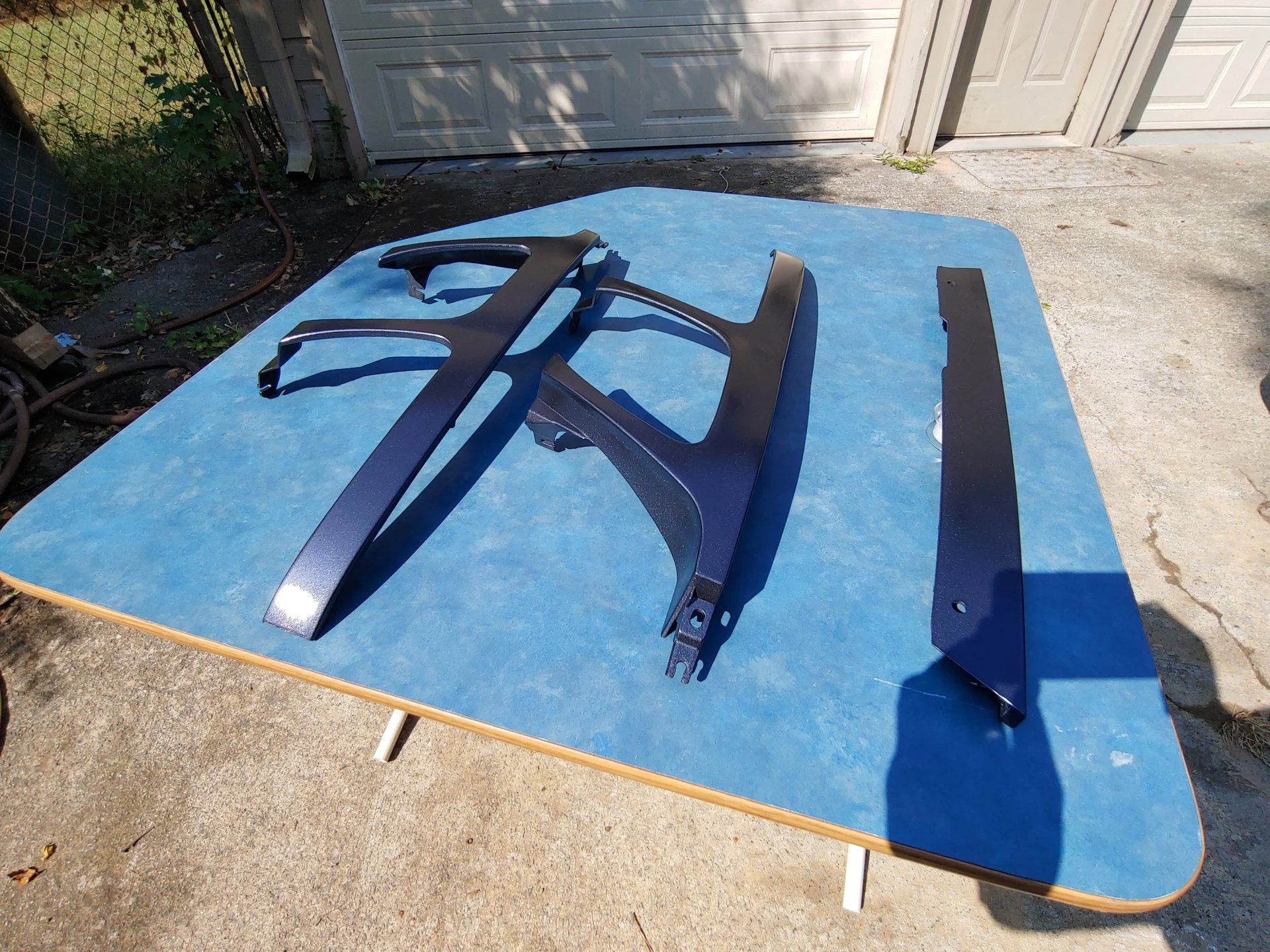

But, I did get the front headlight and grill trim finished. I've had these parts and paint for like 6 months. I finally bought all the new clips, painted the parts, and installed. Considering they're mainly hidden by the bumper, it'll work for me.

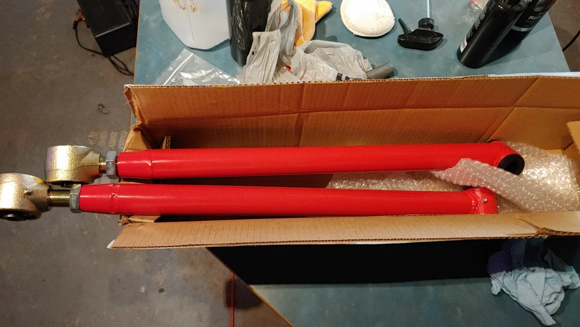

Next up for Gerry are a pair of Jason's adjustable rear LCAs. Getting that order placed tomorrow and installed asap. I've got a lot of torque steer, especially uphill. I've also got some vibrations in the back. Drive shafts are balanced, U-joints are new so... good excuse for new bling.
I too have a small leak in my rear axle. Did you have to take off the bearing to replace the inner & outer seals? I was under the impression that you only need a special tool to take off the bearing.

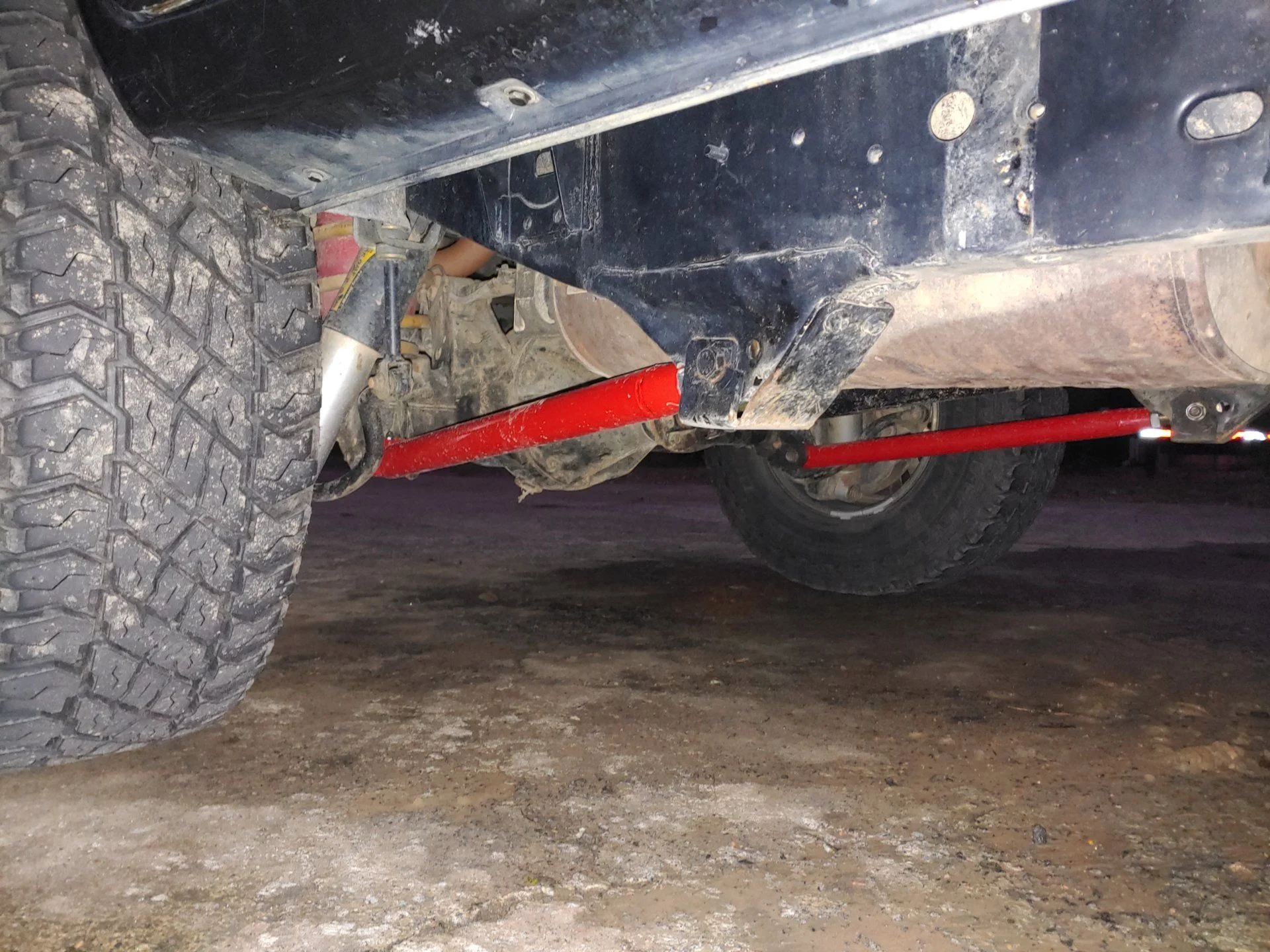

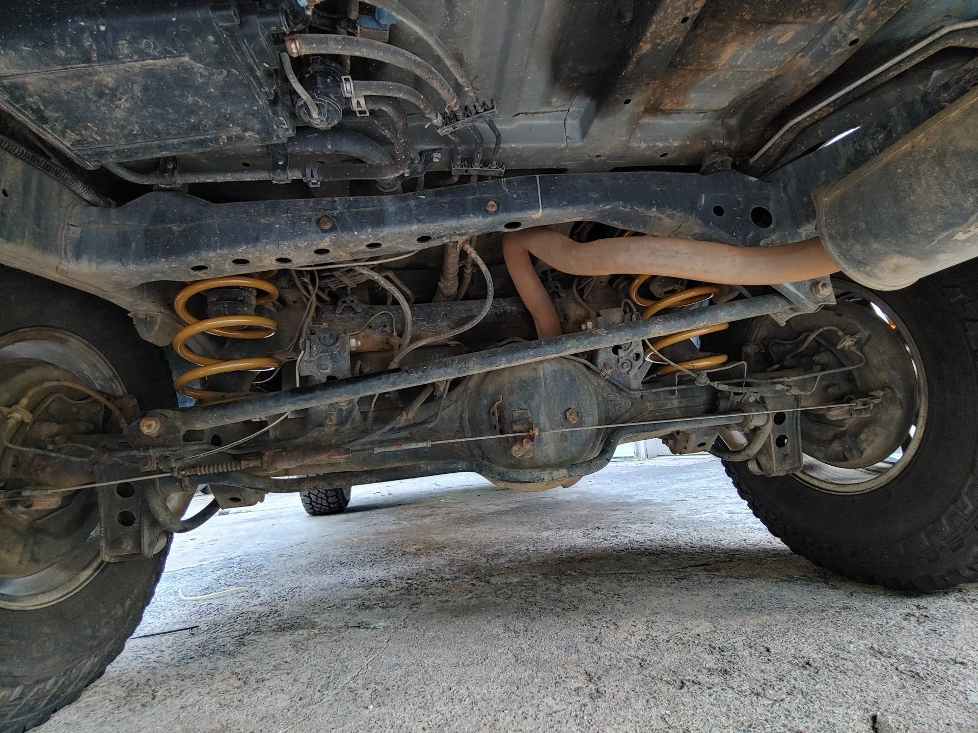

New adjustable RLCAs from TRAIL TAILOR arrived on Monday and I installed them today. They're pretty substantial pieces of metal, and the red color is pretty sweet.
No need to jack up the truck or remove the wheels. Front nuts are 22mm, rears are 24. Keep the grease zerks pointed up when installing. I do suggest adding a 90 degree zerk for the Johnny Joint. With my straight-tip grease gun, it's impossible to reach.
I noticed a tighter feel in the back end for sure. It could be psychosomatic, but I felt it leaned a little less in corners as well. Will be getting a pair of the RUCAs from Jason in the next few weeks. One thing I noticed- the tightness from the back definitely high lighted the looseness in the front. I know my lower control arm bushings and ball joints are not doing their jobs well anymore.
