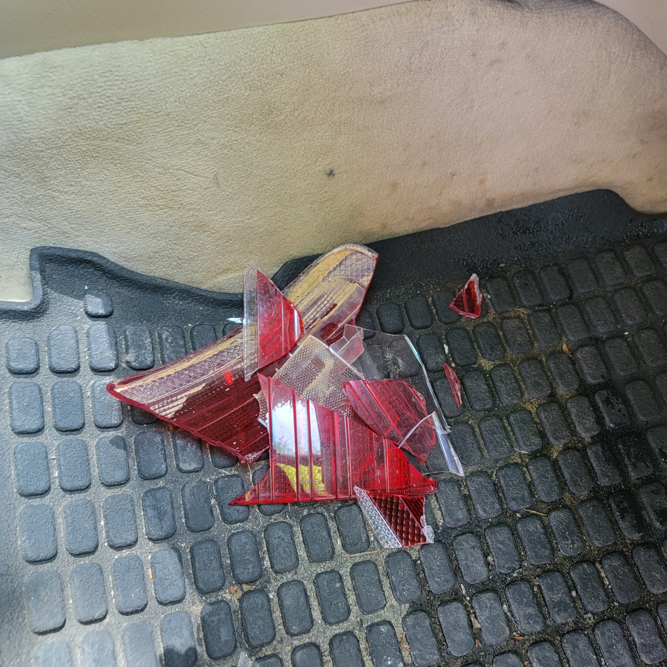

Was touring 2 of my renovations with my contractor today. While leaving one neighborhood to go to the next, he wasn't paying attention at the exit and idle speed ran in to me. The Trail Tailor bumper has nary a scratch but the outer passenger tail light lens got crunched. His F150 will need a light and plastic bumper.
Sigh. It's not a big deal but damn... this makes 3 times someone or something has just run in to her in the last year, 2 of which in the last week. At least my bulbs can be swapped over.
He felt terrible but I reminded him that I've done worse to her myself for the sake of fun.

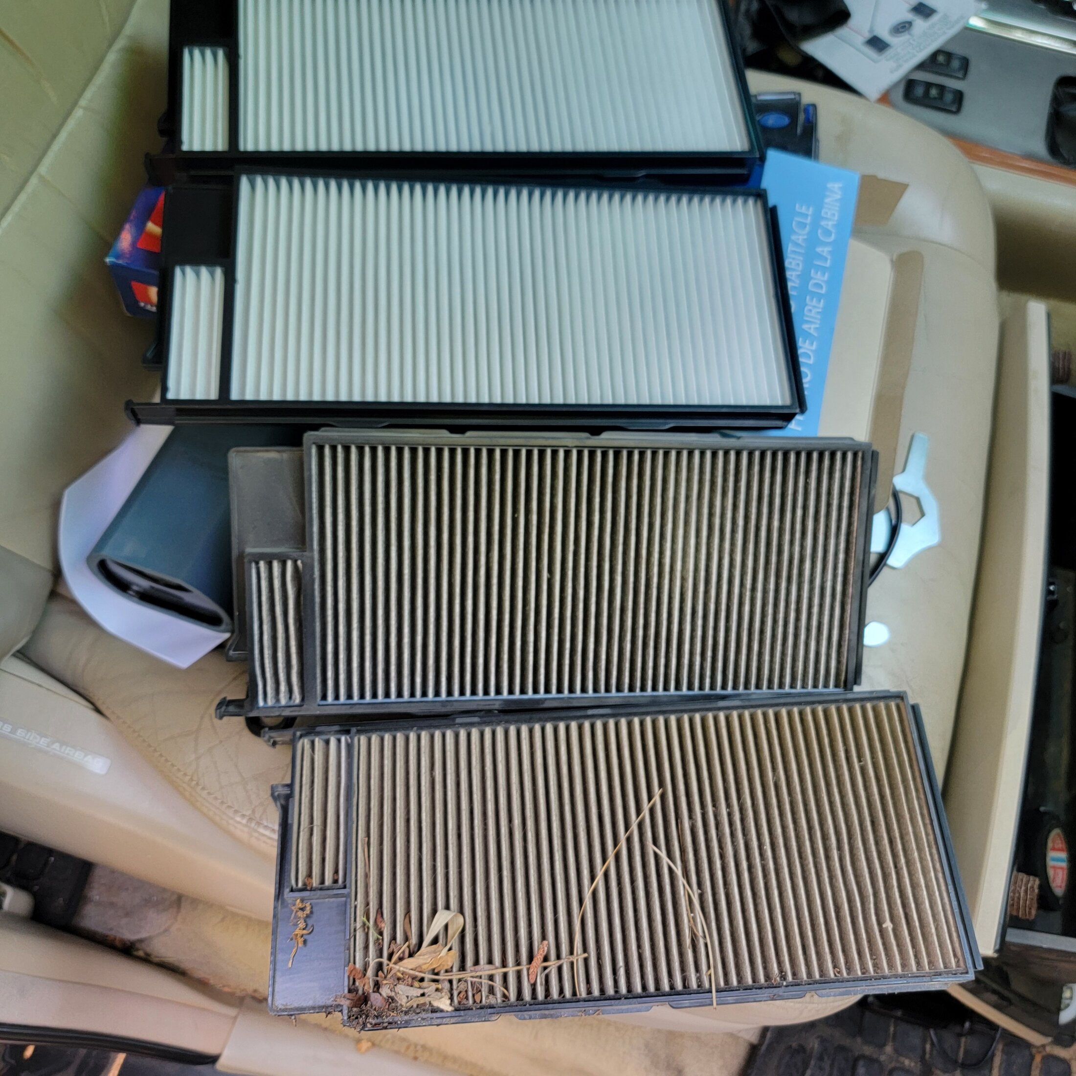

While in there, checked my cabin filters. Good thing 😳

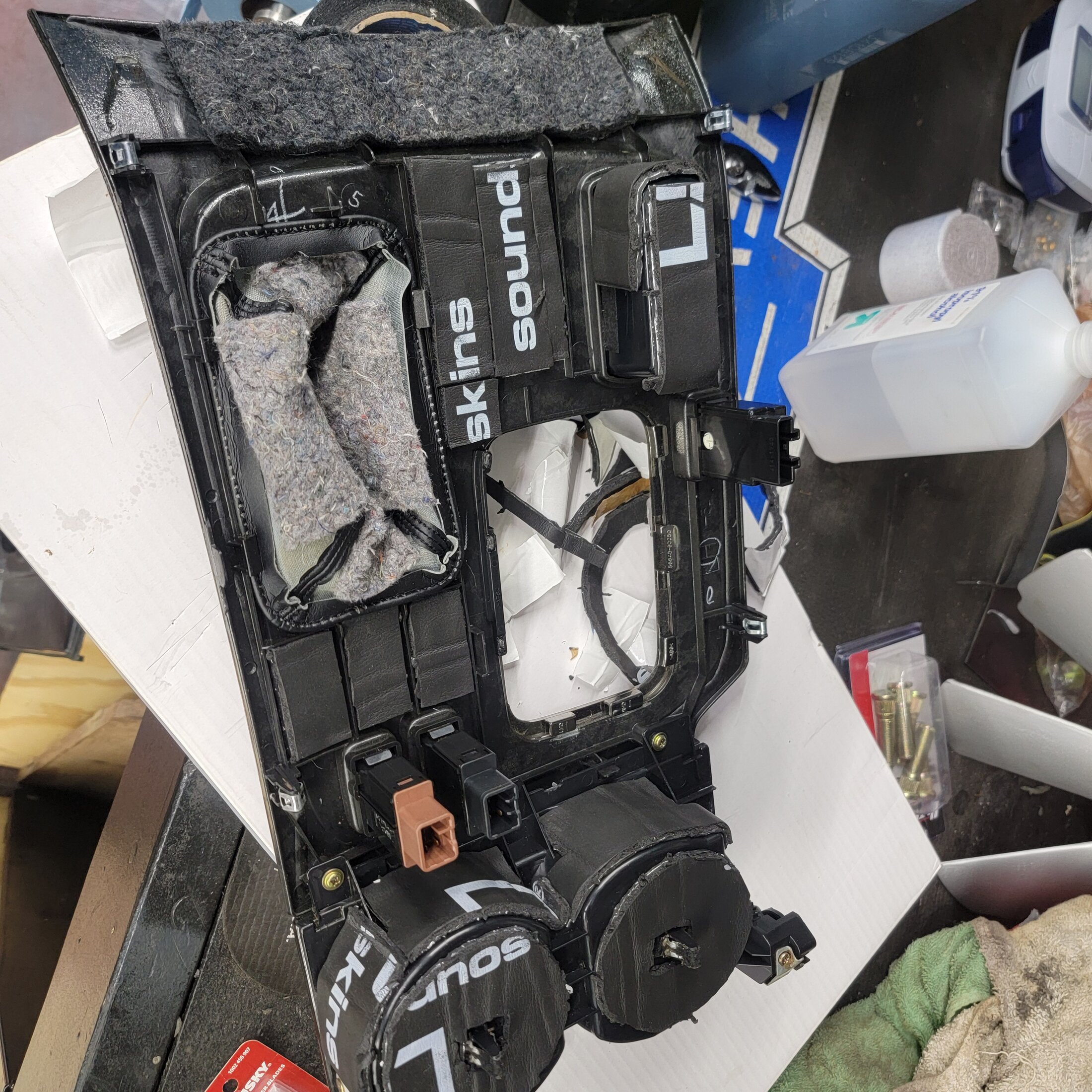

Final item today was to insulate the bottom side of the center console. Tired of plastic on plastic squeaking and my drink bottles getting warm. Pulled the console out, chopped up a bunch of tiny pieces and laid them out under the console panel. We'll see if it helps at all 🤷

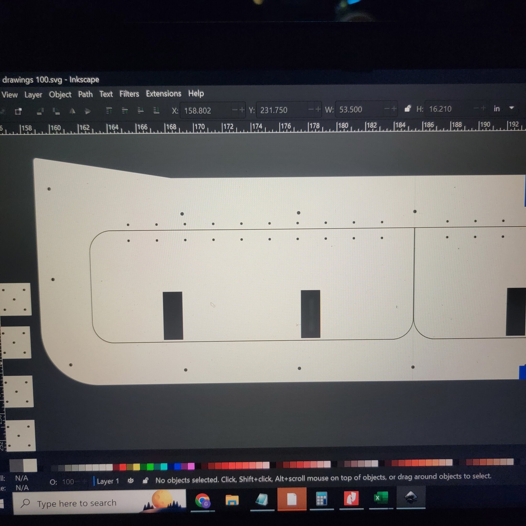

I've also been dabbling in a little project. I've resisted doing tailgate storage because I went to close a buddy's tailgate once, and the damn thing was 100lbs of damn near impossible. I figured my Ms would never be able to get in and out of the tailgate. But @LJE inspired me with his soft-close addition, so I stole his idea and ordered a pair of struts for the tailgate. This enabled me to finally let me freak flag fly and chop up my tailgate.
Since I'm doing this myself, I had no template to use as if I'd ordered the Huracan kit. So, I just copied photos from install DIYs. @Wermz came by because it seems like I never cut any sheet metal without him around. Thanks, buddy.
And then I sound deadened the entire cavity. While in here, I had to rig a solution for a broken plastic holder for one of the rear latch cables, and I (actually Ryan) fixed the horrible rattle that my reverse light panel has been making forever. Now I get a nice solid "thnk" when I close the tailgate and hatch, with no backtalk.
Here's the fun part: I designed the storage system and will be completing my prototype this week. My plasma table is only 4' wide, so I am having to do it in 2 pieces, but I actually prefer the idea of 2 doors vs 1 so you can access items on one side and still have flat area on the other. I also kept the center support of the factory sheet metal, so this will give me 4 sides of ledge to support the access door.
The image above was digital v1. I cut a test panel, made some adjustments, and went for test v2. I just needed one small adjustment on one of the bolt holes, I reduced the bolt holes from 5/8" to 3/8" (using 1/4-20 nutserts in factory push-pin locations) and otherwise it's about perfect. I have piano hinges and latches being delivered today, so I will make final design changes to account for those 2 items. When this is complete and I've used it for a while, I will begin offering this as a very discounted alternative to a Huracan or similar type of product. I'm using 12ga steel for this prototype, but I can also consider aluminum.
