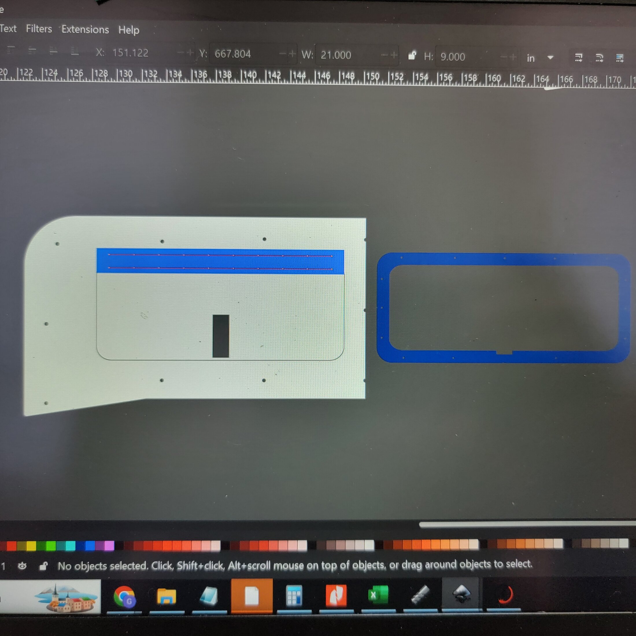

Here's the design process, from beginning to end. I've had about 20 iterations digitally, and trying to tighten it up fast before cutting a lot more.
This is where I'm at as of now. I've gotten the bolt holes dialed in and reduced to 5/16". I have 1/2" head low-pro bolts and wanted to avoid using a washer. There's a kerf-width of gap around the lid and main panel, which is perfect, and I'll have 1/2" lip on all 4 sides for the lid to rest solidly atop (in dark blue to the right). I'm just waiting on my piano hinge to arrive so I can get hole spacing from them and add those holes to the design. I hope to have a complete prototype this evening (half, at least. It's symmetrical).

I ended up redesigning it all this evening to include a 1/2" lip welded beneath the surface panel for the lid to rest in. I think it should be plenty strong at that point. 14ga may be reasonable to use, I can try that v2.

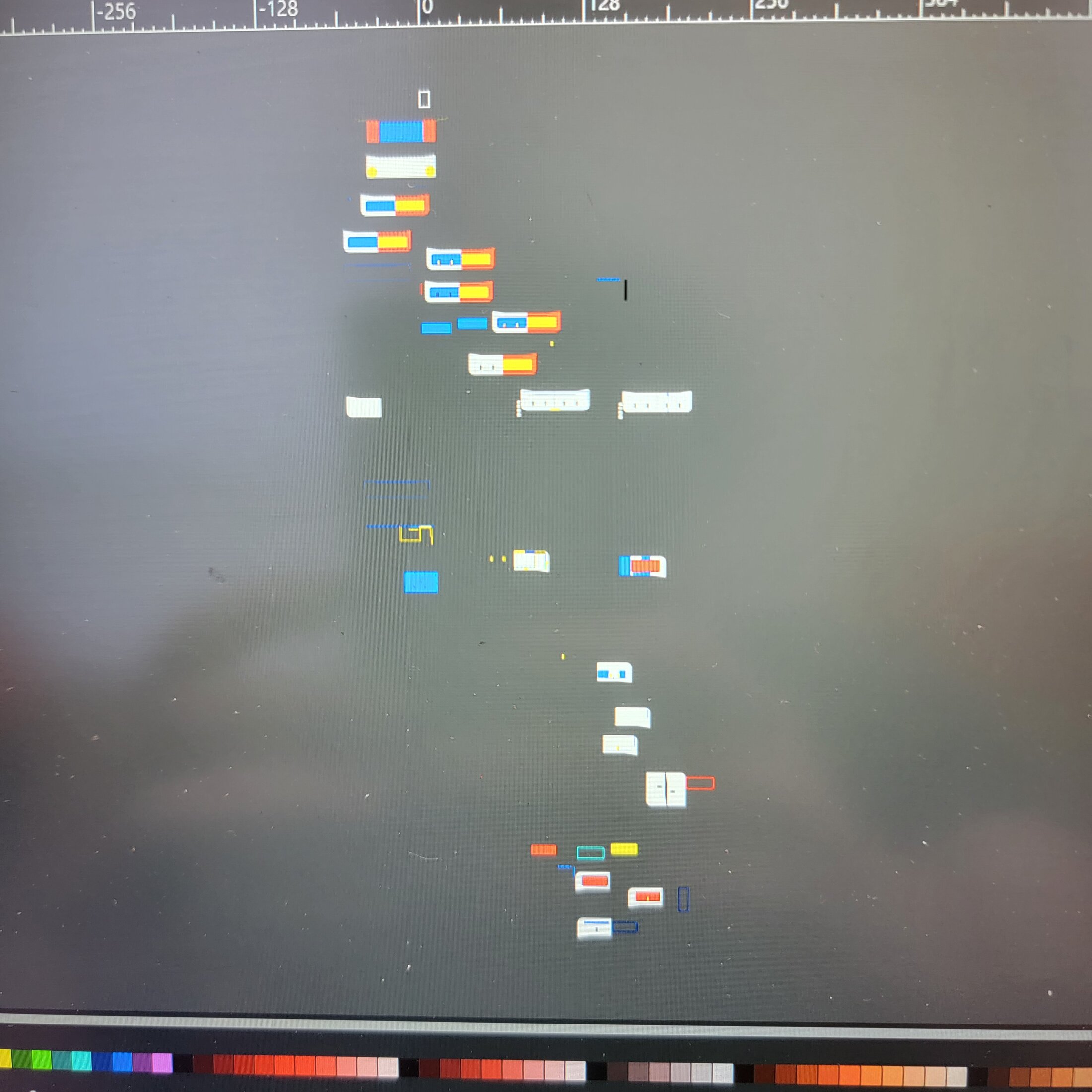

I have designed this simple 2D part about 20 times before I ever cut anything, and I've redone it a dozen times since I started test cuts. Now, I'm no engineer, for sure. I'm also not any kind of creative designer. But I have to imagine I'll sell some kits, redesign/improve, wash rinse repeat. If you get one of these next year, odds are it'll be different than one that goes out in the next few weeks.

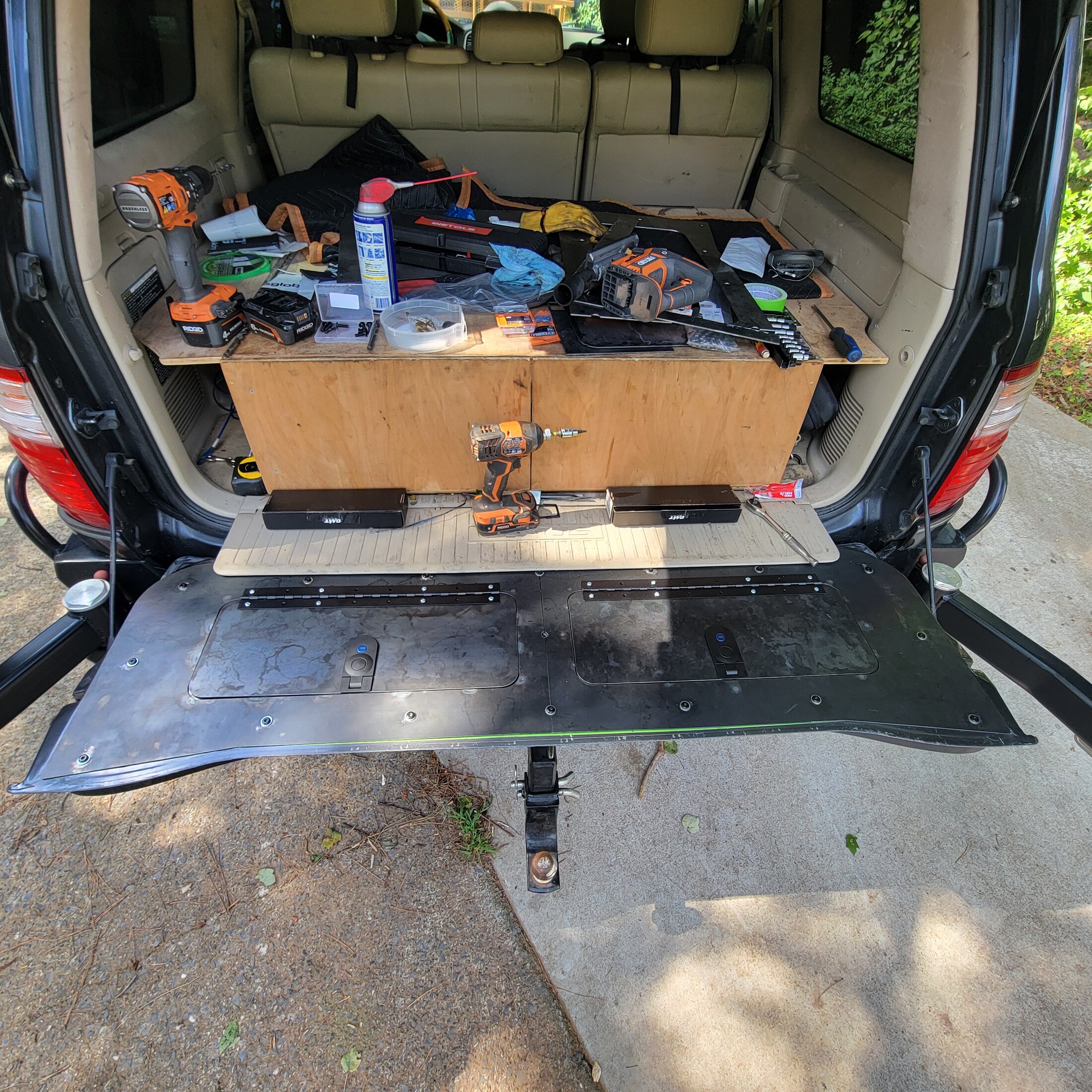

So anyway, I completed a prototype today. Kind of. I mocked up a completed unit, at least. Here's a pic:
Again, not an engineer, not a designer. But I'm pretty happy with this product as it sits currently. Since the photo, I taught myself some new tricks in my processing software to make the whole thing cleaner and... toighter. The lid doors now fit closer to the dimensions of the lid door openings, and I've streamlined the support lip that lives on the bottom side of the top layer. I have designed it in 2 ways- one is a full bolt together job, with 39 bolts per half and 3 shared. I also designed a weld together version, which only utilizes the original 16 push-pin holes, plus one more in the center of where the 2 halves meet.

That looks good! How well does the 'gap flapper' (lol) ride over those hinges when you go to close? I seem to remember that being some people's beef with the Huracan fab one.
Trying to fit the struts in there is definitely a challenge - not much room at all, especially with the support cables there too. I mostly just got lucky with the kit I grabbed, haha.
Same problem on this one. The flappy panel catches on the hinge and the latches. I'm pondering solutions. Easy is to remove the panel, but that's a half assed measure.
I am both an engineer and a designer and think this looks really good. One improvement I could see for the future is to hide those hinges on the inside.
I was thinking about that too - would probably take a different type of hinge, but I think that would be SWEET. Would help with the flapper getting caught too - the total fix for that might involve making some sort of 'ramp' on leading edge of the latches in conjunction with the recessed/inner hinges.

Sup tall Kyle. I fully agree, the hinge rod on top needs to go. Wouldn't you know it, a hinge welded to the bottom side was my last version attempted yesterday. 2 issues I ran in to though (not the fault of the design) : 1- the hinges I used did not open beyond 90° in that orientation, and I think the door needs to be able to open further. 2- I accidentally welded the hinge to the wrong side and all of my drill bits to drill the welds out broke and I got mad and decided to clean the garage and go inside at that point.

A ramp is a decent idea. If the hinge can be taken out of the equation, it would only be needed on the latches. I also like the idea of using super low profile rivets where possible.
