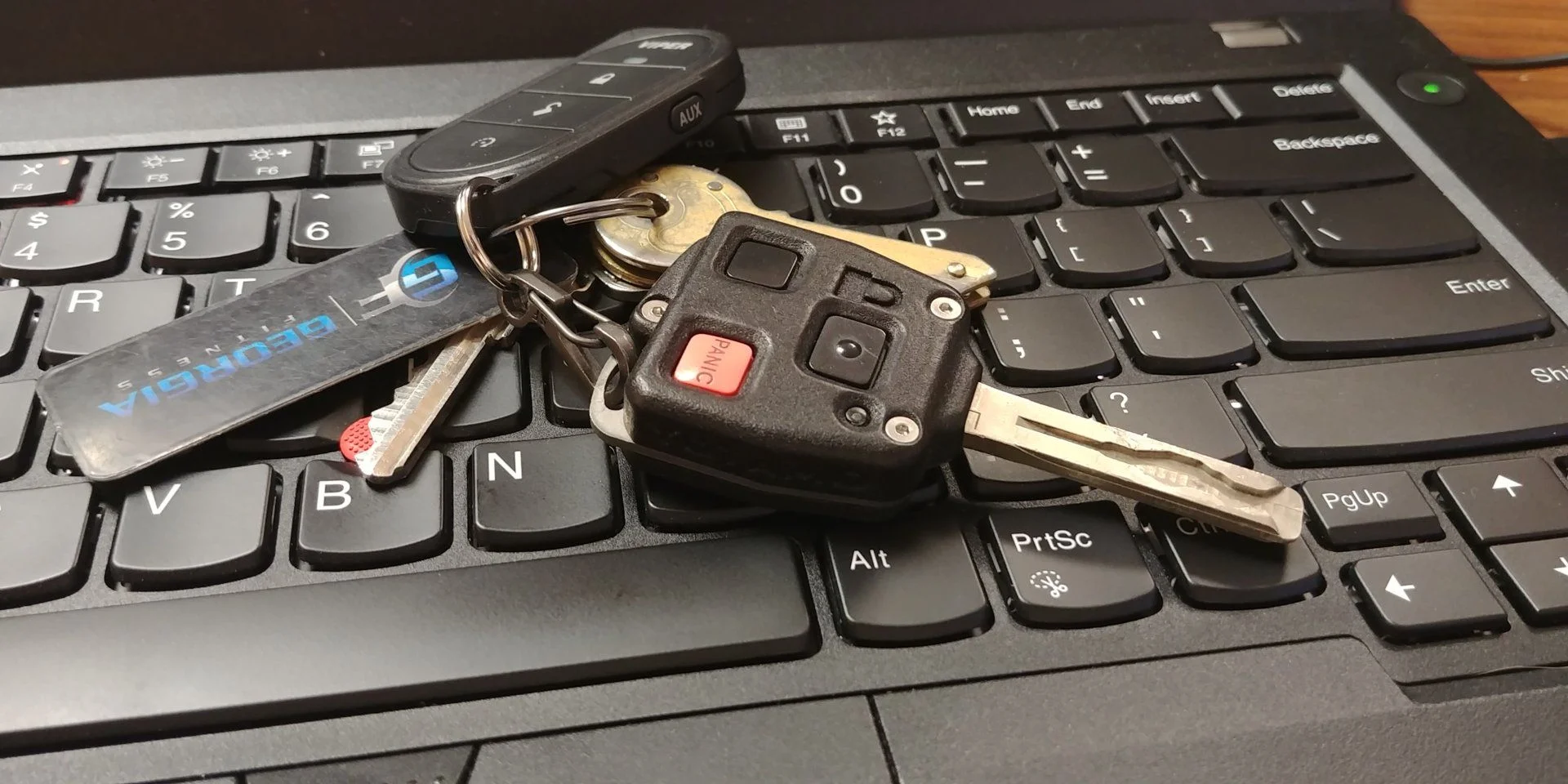

Also picked the Yota MD fob last week on the Black Friday sale. Nice and sturdy. This was mostly preventative as both of my fobs were still like new, but I've had them glued together for dear life before on other 100s.

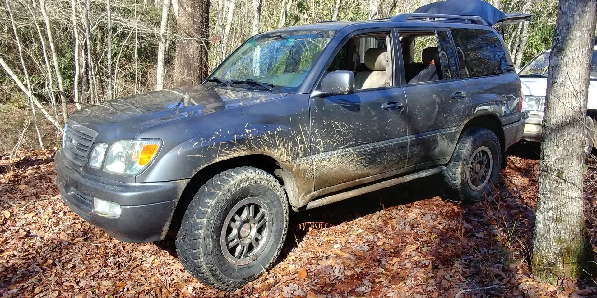

Last weekend I was able to give Gerry a try on some trails. She did beautifully with nary a hiccup. Can't wait to get out more often.

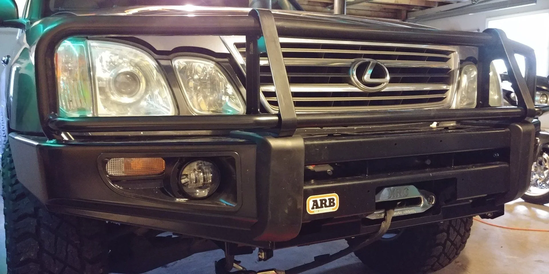

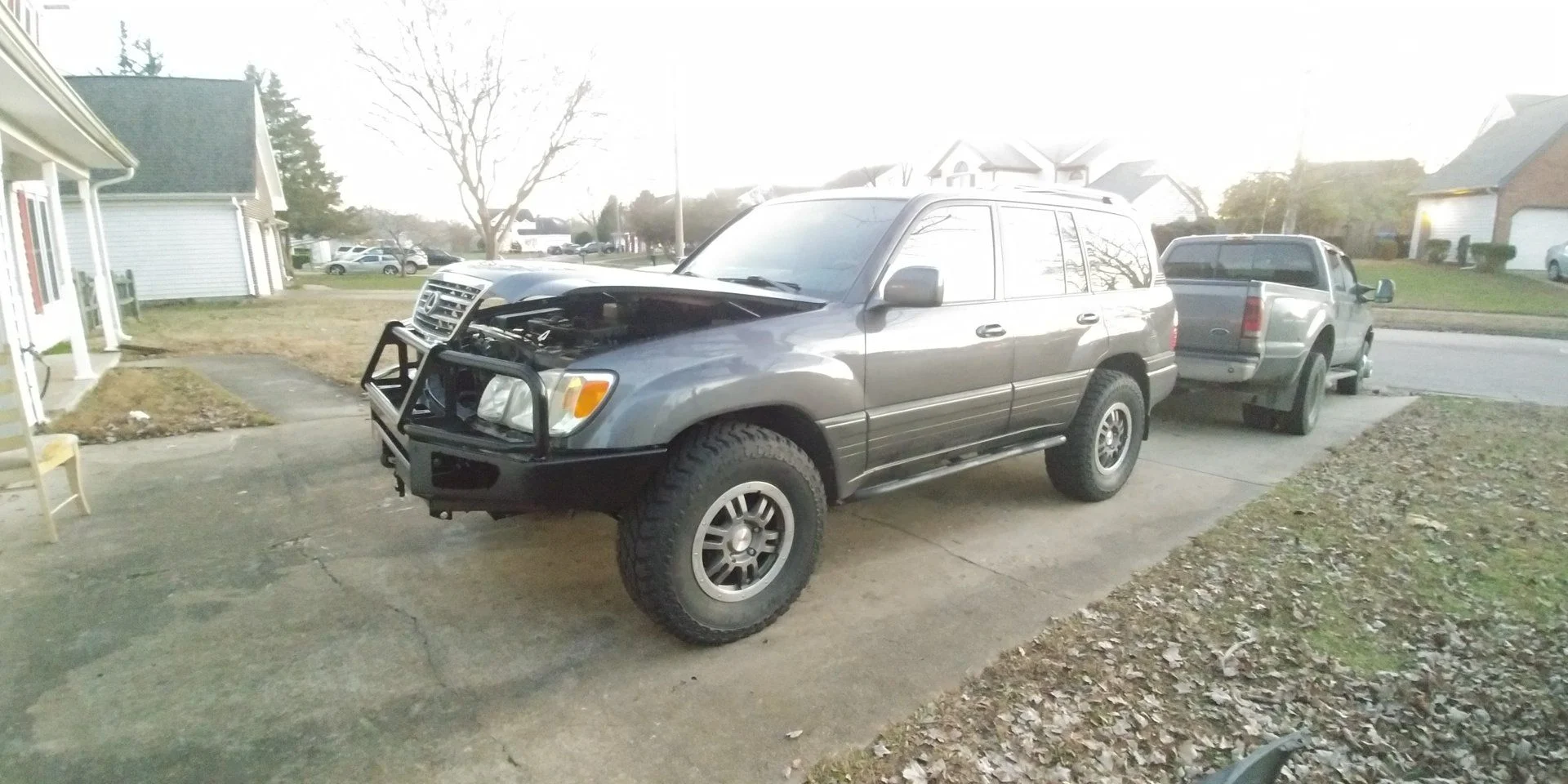

Got the winch completely mounted today. I found that my hardware pack was short one square nut for mounting, so I spent a lot of the day trying to track down another one. Got it set and finished up some wiring for my turn signals. I opted to wire both bulbs in the ARB turn signal housing to flash with the blinker. I just need to find a correct amber bulb for the clear lens portion.

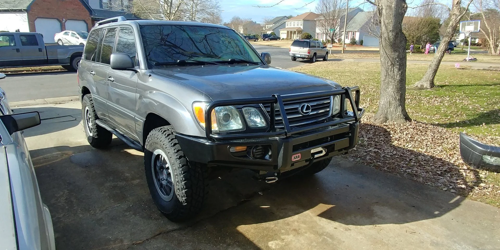

Bumper got mounted up with a little drill bit finessing. No thanks at all to the supplied instructions. The pictures were largely useless. First impressions of the ARB bullbar: it's big. It's heavywith the winch, weighed my truck down about 3/4" in front. I need to crank on the bars tomorrow. I wish it were a thicker gauge steel and I think the build quality left something to be desired. I was a little underwhelmed, actually. But for $850 for a brand new bumper wrapped up in a box, I couldn't sneeze at it.
Lights are in and bars are cranked. New fogs are supposed to arrive tomorrow so hopefully I'll be able to get them in before leaving to go home to Atlanta on Saturday.

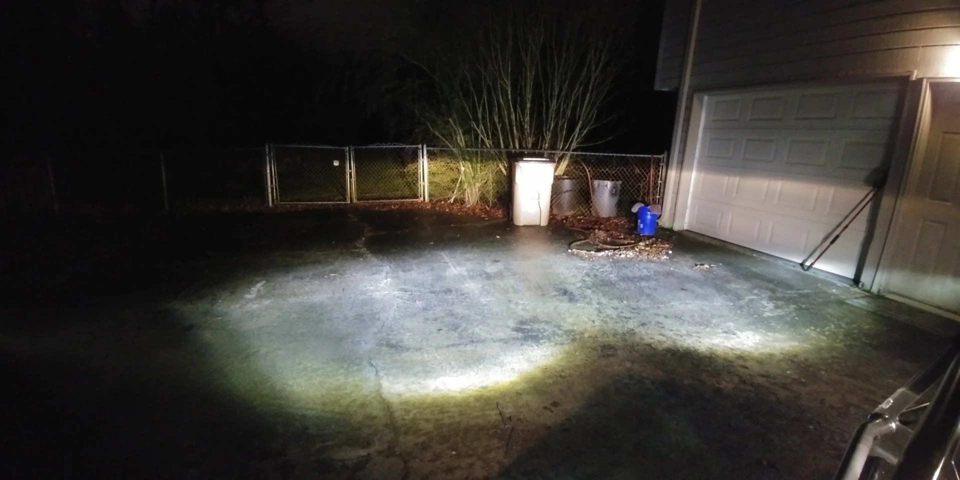

I'd ordered a set of these $40 LED fogs from Amazon while I was still in VA and luckily they got there in time to install before heading back home last night. https://www.amazon.com/gp/product/B01I68J832/?tag=ihco-20

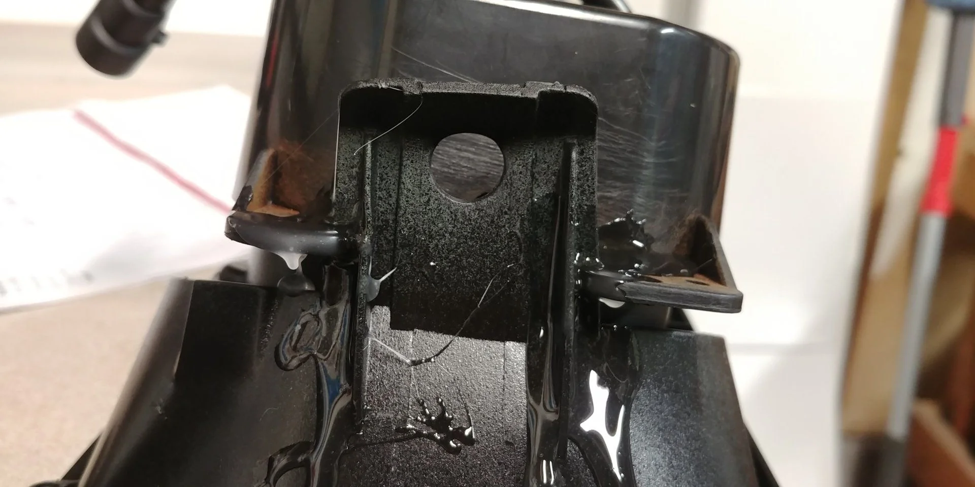

They're not directly compatible with the ARB lighting inserts so we made some adjustments. I basically just cut one mounting tab off of each fog light and then notched one of the ARB tabs to accept the brackets from the fog light. Since there were no places to put a screw or bolt, and I didn't want any hardware exposed on the outside, I epoxied in a little plastic covered nut that I think was originally used to assemble a plastic dog kennel. In the pics I have the screw just positioned to hold it while the epoxy dried. Ultimately I ended up with lights that were centered in the ARB trim and looked like they should be there. I can still adjust the light pattern in or out via the one bolt I put in, and up or down via the original hardware the light came with.
I still need to do some adjustment but they put out good light and have a very good cut off.

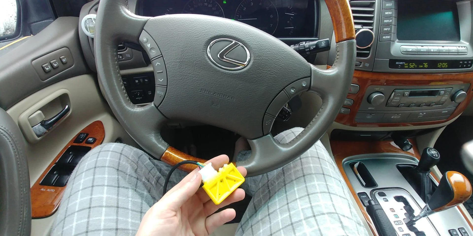

I also installed a Yellow Box speedometer calibration thingy. I was reading almost 9% off with the 34" tires and it was really throwing me off. 5MPH off I can deal with, but 6.5 at 70 is a weird number.
Easy enough install. Took 30 minutes to get out of bed, put on PJs 'cuz it's Sunday and rainy, read the instructions, do the math, install, and road test. I didn't feel like removing the console or doing any cutting ('cuz it's Sunday and rainy) so I just wrapped the module in a baggy and sealed it up with waterproof duct tape. It's now zip tied under the truck above and behind the transfer case out of the way of anything. It's dialed in perfectly so I don't care about immediate access unless I change tire sizes in a few years.
