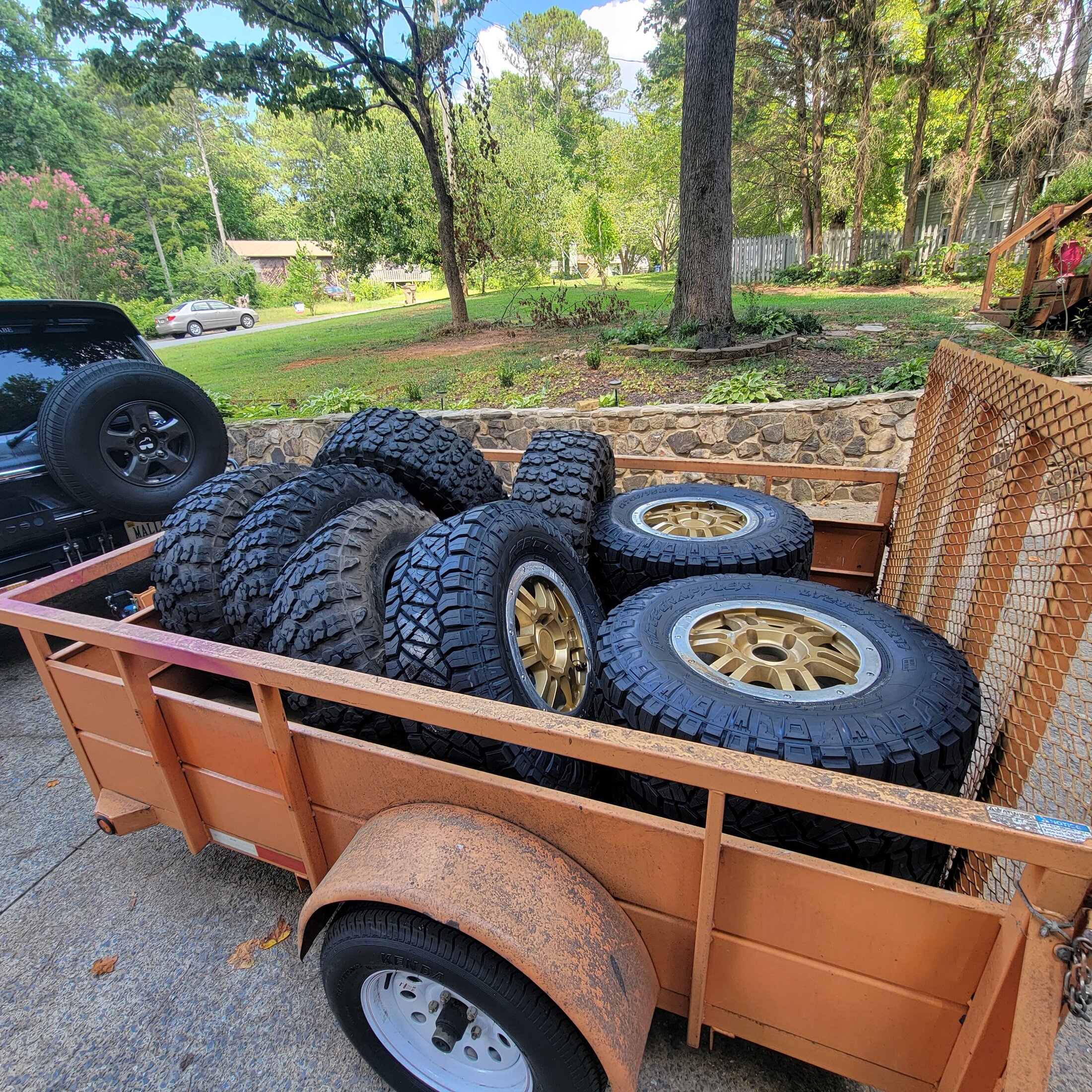

Read a ton of reviews, watched a bunch of videos, and I just placed an order for a set of 5- 285/75/17 Nitto Ridge Grapplers. I'd always assumed these for tires for Bro-dozers on 14-wides, but turns out they're actually supposed to be pretty great off road as well. They'll be installed on my RW wheels this week.
I run the RG's, for how aggressive they are they are very quite. While they handle standing water nicely, the one thing I've learned is these do not particularly want to stop quickly in an emergency braking situation when the road is wet. Dry braking is excellent, wet braking you are the passenger.
Got some rubbers and a rim job this afternoon. So that's 3 sets of tires for the 100, not to mention the other multiples I have for the other cars. I don't have space for this s***.
I haven't really put mileage on them yet. Around the block they felt fine, but it'll be the highway driving that I'm judging.

Interesting how these “smaller” tires actually make the truck appear more lifted than before - In a good way. I guess stuffing too much tire under the fender takes away that gap ? Idk if that makes sense but what I’m trying to say is that the new tires look proportional
FWIW I ran the RGs for a few years and they were great in everything except highway lane changes in NE snow
Something tells me you’ll be happy with this size 😜

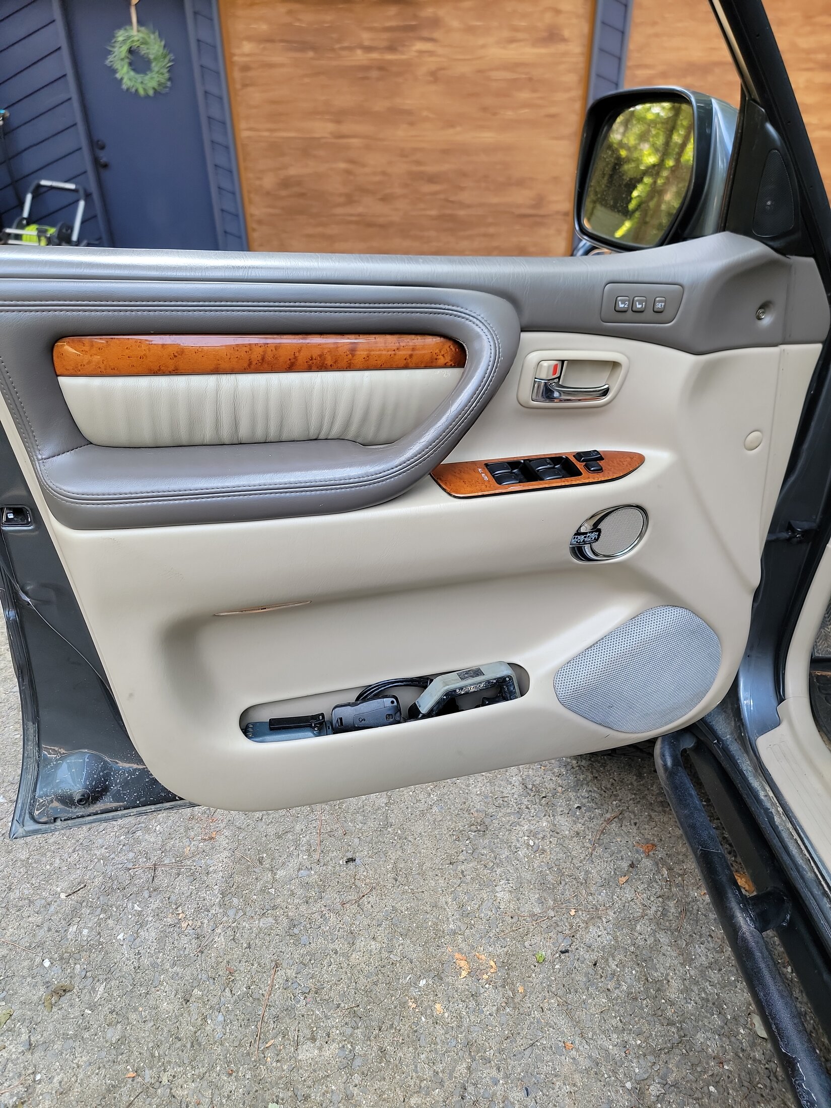

I reinstalled the repaired speaker today. While the door was apart, I went ahead and took advantage and added sound deadener to the inside of the door shell and inner facing surface where the door panel mounts.
I've used dynamat (brand) before and it worked well. This time I tried "soundskin" brand, which is actually 3 layers. Butyl and foil like dynamat, but also a closed cell foam layer.
Results seem good having only done one door so far. Bass and sound from the door speaker is much better than it's ever been. I'll likely do the PF door before the CO trip, and maybe I'll get to the rest of the truck in like a year.

Nice work! Love the gold wheels with the truck color. New tire size looks perfect.
Will be curious your impressions on the 3 layer soundskins vs dynamat. Did/Do you plan to cover over the access holes in the door? I've found it helps tighten the sound up and improves bass making the door as much of an enclosure as possible.
I should have. If not for the sound but also keeping a full barrier for moisture. When I do the passenger door I will do this, and eventually I'll pull the driver's panel off to add.
