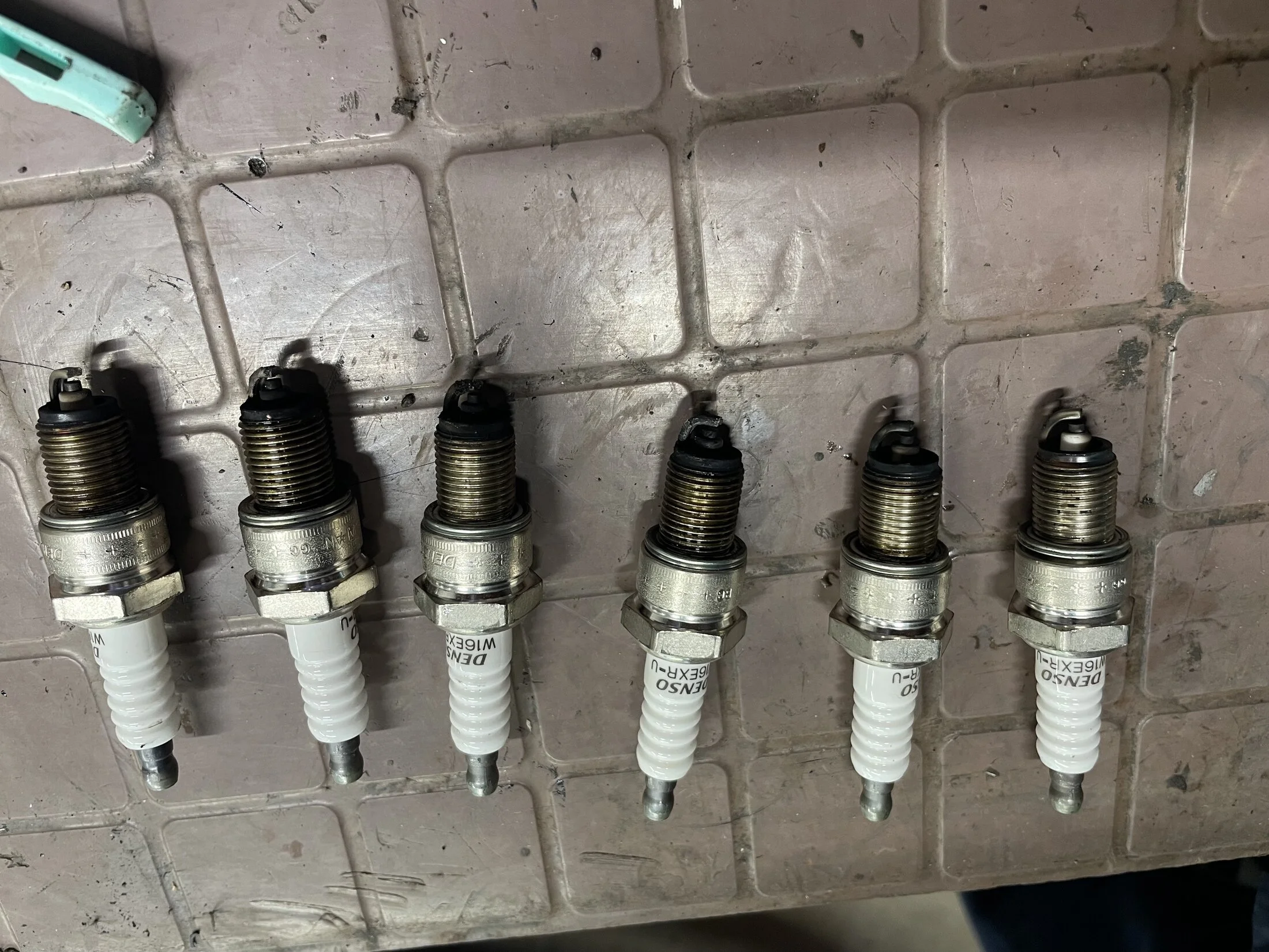

Got a few things done today. Changed out spark plugs, here is the set that's been in there since I redid the valve seals in July. Showing 6-1 from left to right, looks like 3 and 4 had the most junk on them. This isn't really surprising, but I'm glad I replaced them.

any notable improvements ?
plugs # 3 & #4 will always be different in some minor or more then minor way on all land cruiser inline

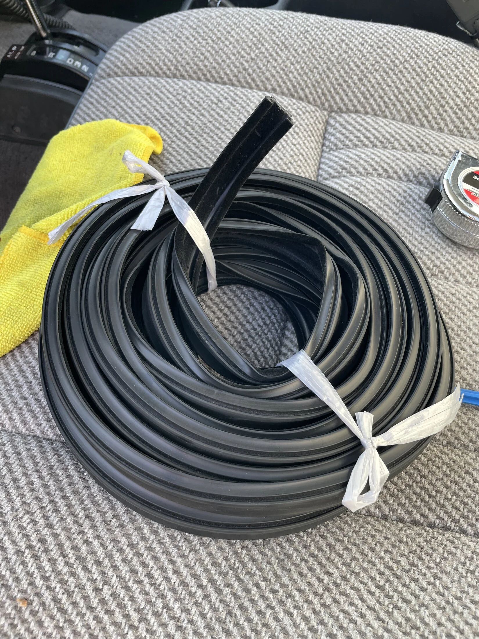

Next up is replacing the channel felts in the front doors, have that on order from Amazon and should show up this week.
Fun and easy project over winter break - replace the dried out weatherstrip in the front window channel with new felty goodness from Amazon. Here's the old stuff pulled, you want 89.5" for each side. 33" from one end, cut a 90* notch for the upper rear corner. I suggest pulling the windows off the regulators, will make it significantly easier to install.
And here's what it looks like from Amazon, I got 25' of it. I might be able to do one of the rears with what's left, but would order more if I needed to.
Link to the stuff on Amazon, takes a while to get to you but worth the wait.
Windows are still difficult to crank up and down, bought replacement window regulators to show up sometime in the next week or so. BUT, this should stop some of the wind noise and certainly the leaks just over the top of the window when washing the truck.
