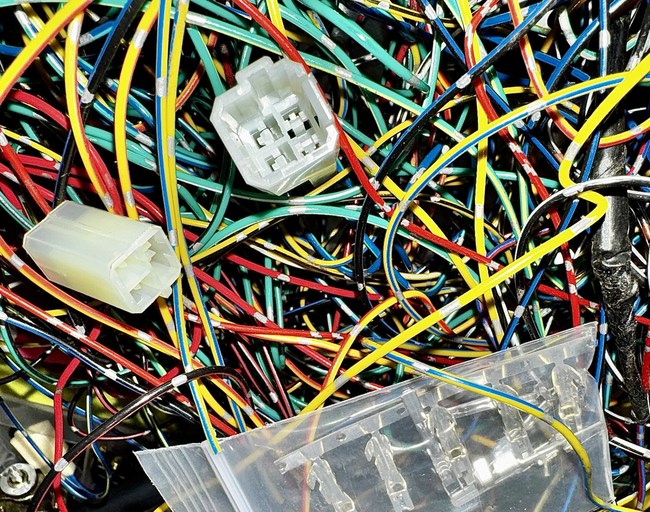

That would be cool @ToyotaMatt ! However I don't have the connector crimps, unless a pair of needle noses would work too?
The reason they get fuzzy is because there's a small vent hole in the inner rear fender right next to the plug location, and the plug itself kinda sits at the bottom of the inner fender... As water gets in there over many many cycles, it's just a matter of time before corrosion takes its toll.

so wait ...
what am i missing here ,,,?
i see 2 lopped-off HYBRID-Anti-Directional Terminal Bay Locations housings in your paws above ....
you know i would
Press-Master out the new ones with all oem genuine Sumitomo color coded tracer stripe wire by the FSM for you if the thought of mending those now 8 wires issue with them pink-panther-plastic butt connectors that @Spike Strip scooped up from Encino's 24 Hour CVS 's Automotive Supplies aisle he frequents late night .....

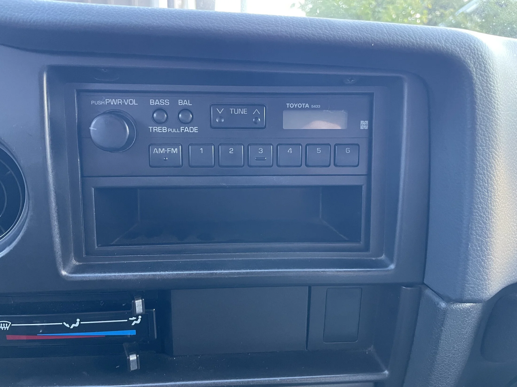

And ANOTHER radio swap, got tired of CDs and going to raw-dog it old school.
“Bluetooth? Naw, imma yellow toof it”
This is the headunit that came in my '89 pickup, it was a very not cool radio in highschool. In true 1993 fashion, it got replaced with a pullout Alpine CD player that I saved up a lot of money for lol
Awesome! And you had to lug that stupid thing around, leave it in your locker, hope it doesn't get jacked while you're in class... yeah those were the days! I spent a lot of coin in 1995 on a Sony head unit with the detachable face for my 1984 Accord, installed that puppy in my parents' driveway. It was amazing driving around with a CD player (!!), making trips up the coast from LA. Think I spent $200 on it, that's like $800 today or something insane?

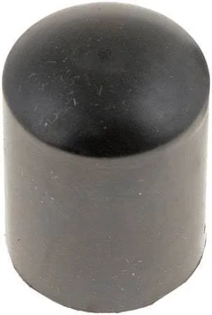

Not much new on the General, aside from plucking the new check valve off the air rail and putting it on my FJ60 project, then getting an AV8 check valve from a late '70s to early '90s Alfa as referred to by @Spike Strip for the 62. Threaded side is correct, but needed a little bit of extra girth on the bib to fit the hose, which was remedied by using one of those heater bypass caps with the end cut off of it as an adapter. Can't remember which one it is but I had it in a drawer on the workbench from rebuilding the heater in my BMW, when I was way more careful about making sure coolant doesn't spill, hah. One of these guys:
I am at the point with this hobby now where I can often enough find what I need by poking around various boxes and drawers and whatever in the garage. That only took 8 years or so!
