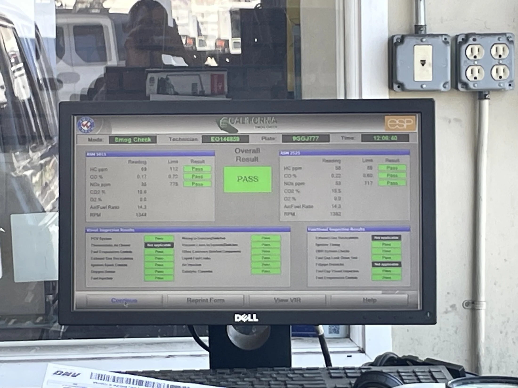

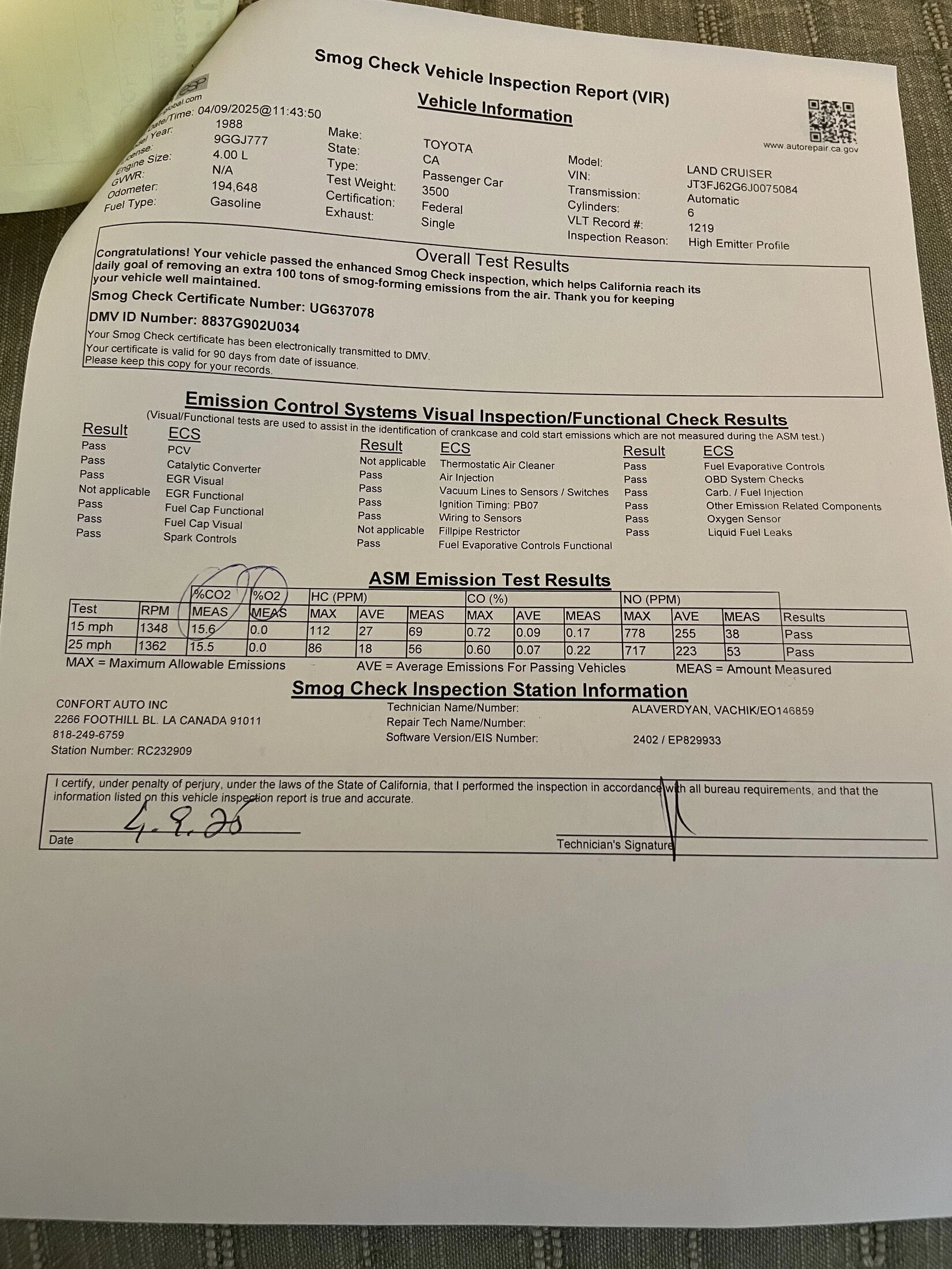

@Spike Strip Still running 0% O2 even after the B-Z rebuild of the smog pump. Tech said that it was actually good, but who knows. Results got slightly worse than last time, but I was running at 5* BTDC in 2023 and this year it was the normal 7*. Plus the cats are 2 years older, I don't really expect them to last decades like OEM. But whatever, I'll take it.
Tech says, "I remember this truck, didn't it catch on fire last time?" 😂 😂 😂
You're lucky. Rare for them to pass with 0% O2. There's something keeping the air injection from getting into the chambers. You got 2 years to figure it out. You have new check valves correct?

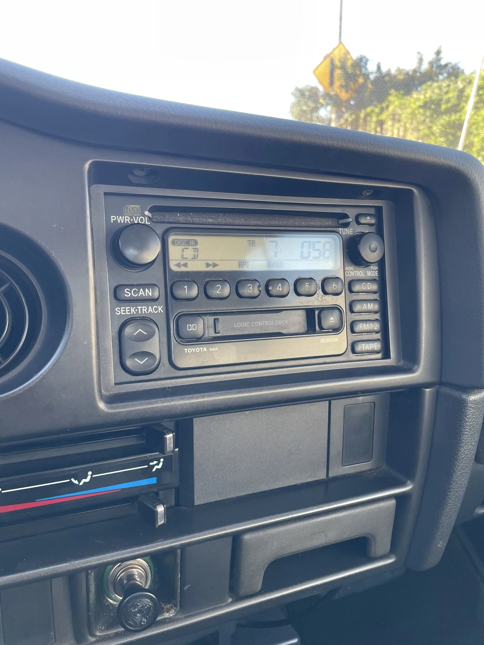

Changing radios like most of y'all change underpants. This time it's a CD player out of a 2003 Sienna, works great and no Apple snooping on what I'm listening to (The Smiths, if you really wanted to know). I'd ditch my phone altogether if I didn't need it for work.
