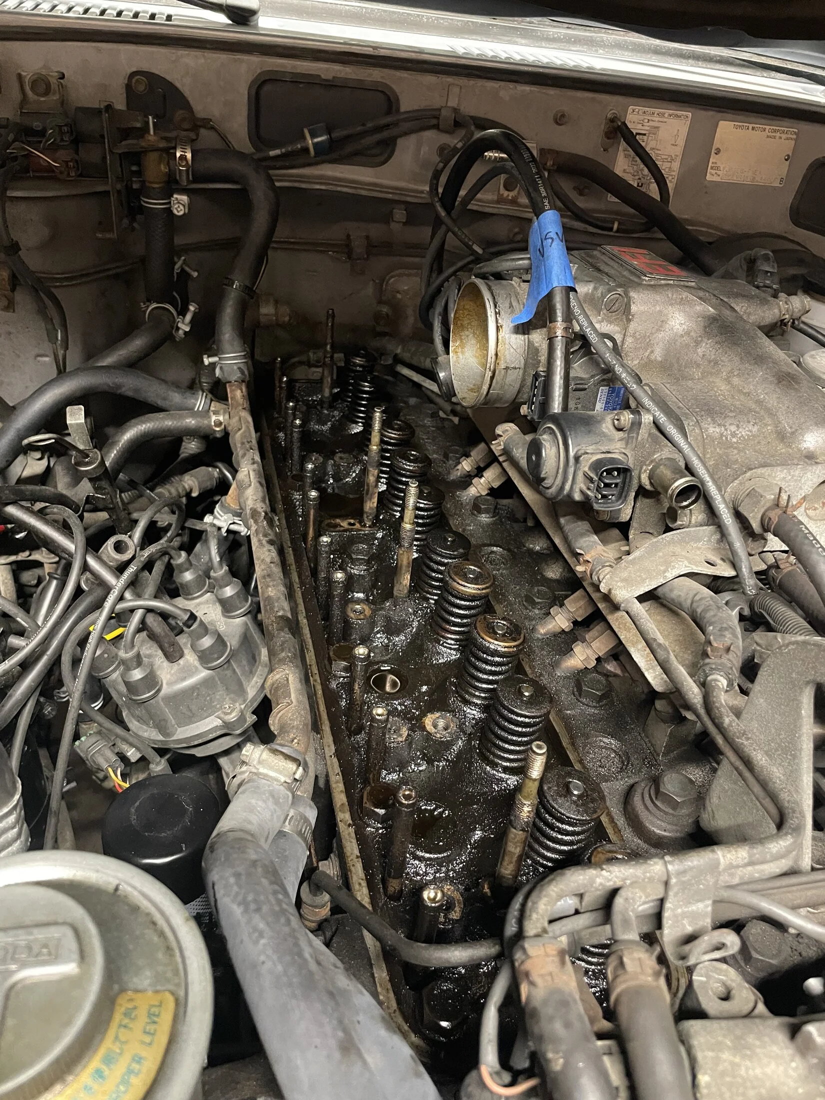

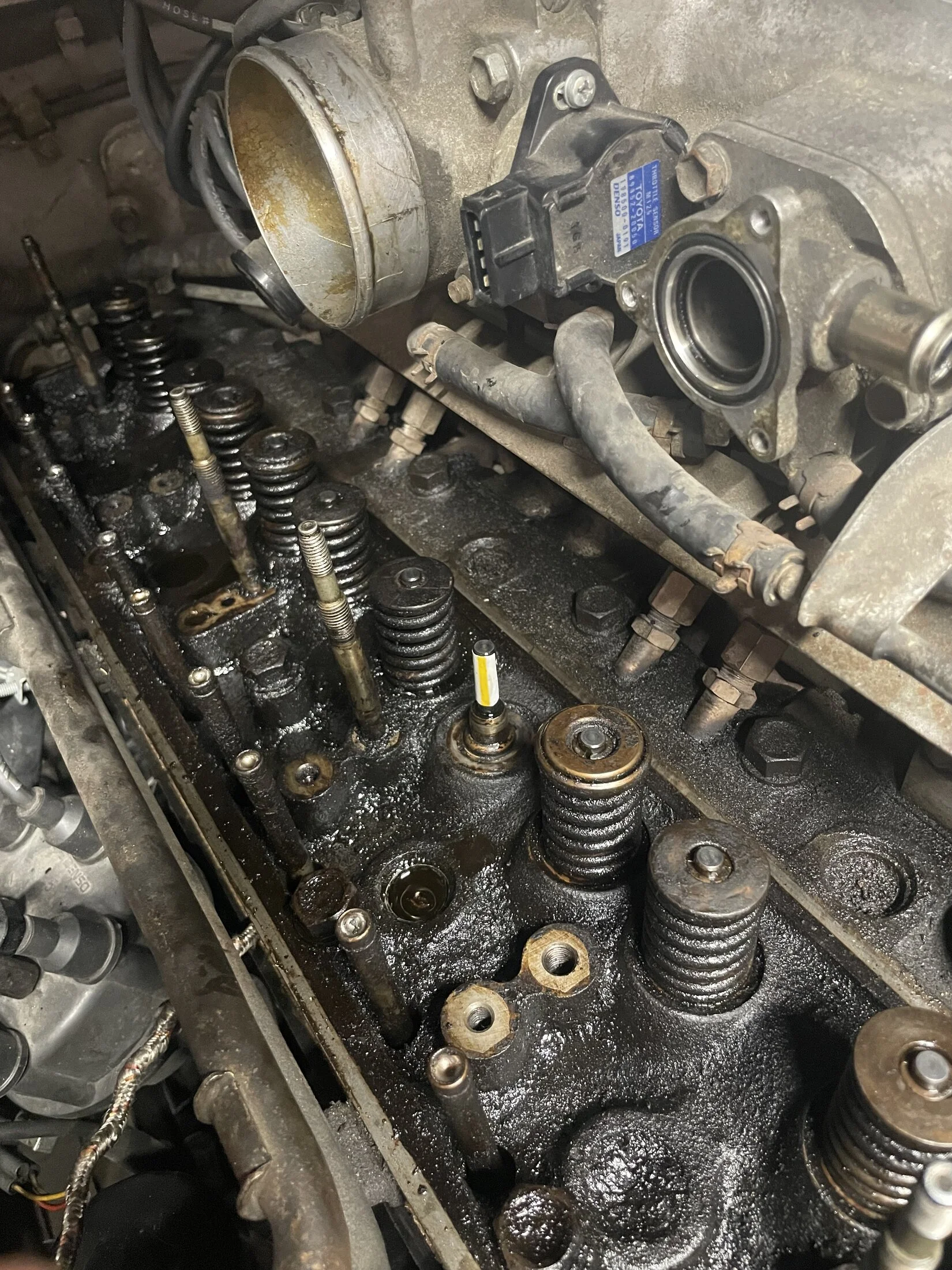

Teardown started for the valve stem seal replacement. I'm burning a meaningful amount of oil between changes, and have been meaning to get to this for a while now. Plug inspection revealed some white ash buildup on #4 and #5, all others were a good looking tan color. Last compression test showed everything more or less normal, it could be rings but decided to have at this project because it's cheap and relatively straightforward. I have the Eastwood valve spring compressor, and it will not fit with the intake installed, will need to just unbolt and have it move about an inch to the driver's side to clear the intake and associated sensors. Will look for a different option before committing to moving the intake. EDIT - found a different spring compressor from Napa that might work without moving the intake, will pick up and report back.
This only took about an hour, half of which was spent trying to get the rocker arm off the head as it was fairly well stuck on there with all that buildup. However this looks way better than it did when I first got the rig, have been running 15w40 Rotella T6 with a 2k OCI. I still hate these tiny D3 filters that Toyota has us running, will be looking for a better option next time I do an oil change. However, at the last change about 200 miles ago, I opened up the filter, and it was totally fine except for some fine bits of carbon, exactly what I expect from this engine.

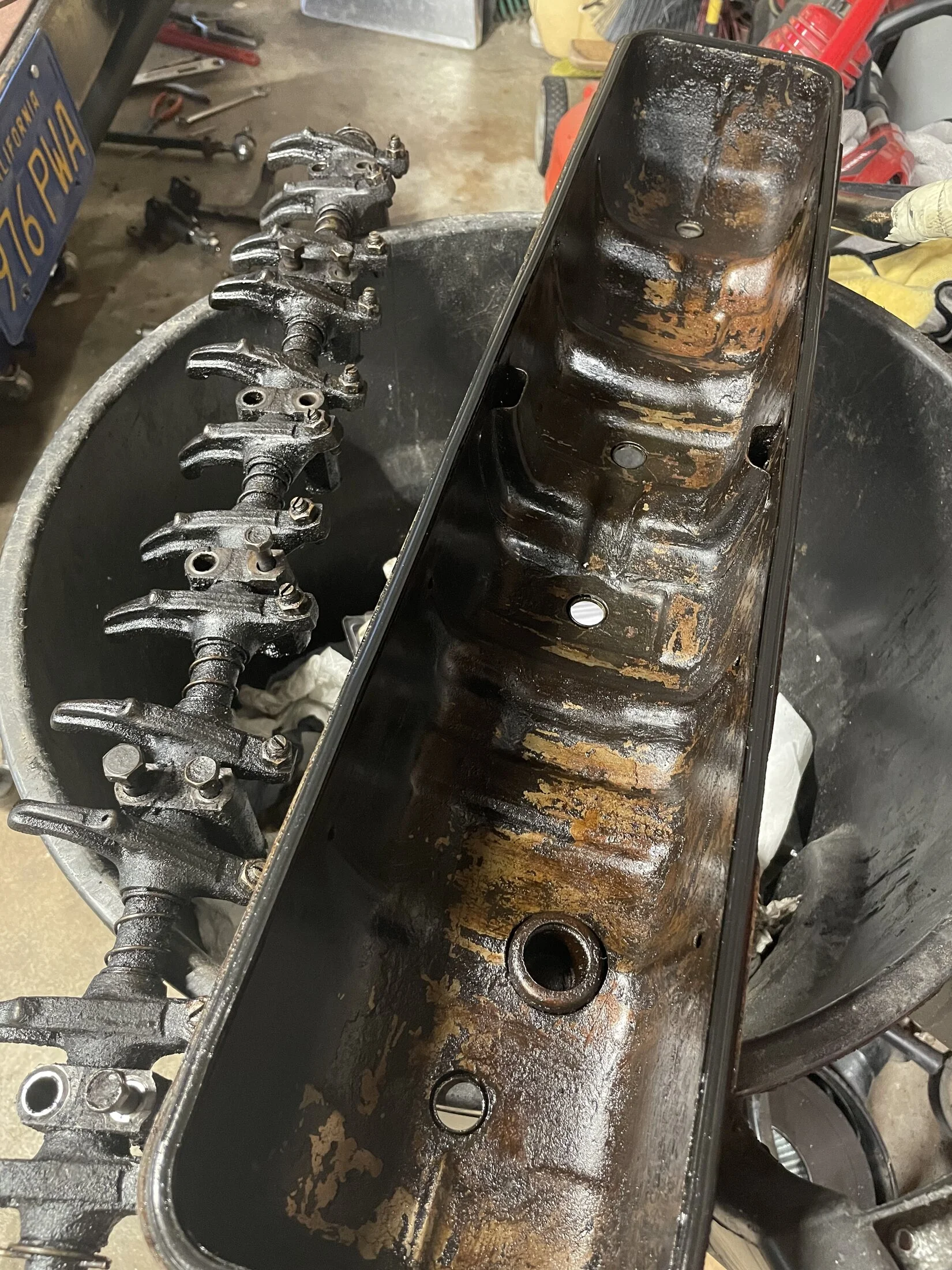

Valve cover and rocker arms removed. Oil passage is fine in spite of the crud, valve cover looks ok, a little cooked but nothing crazy like when I removed it a year ago.

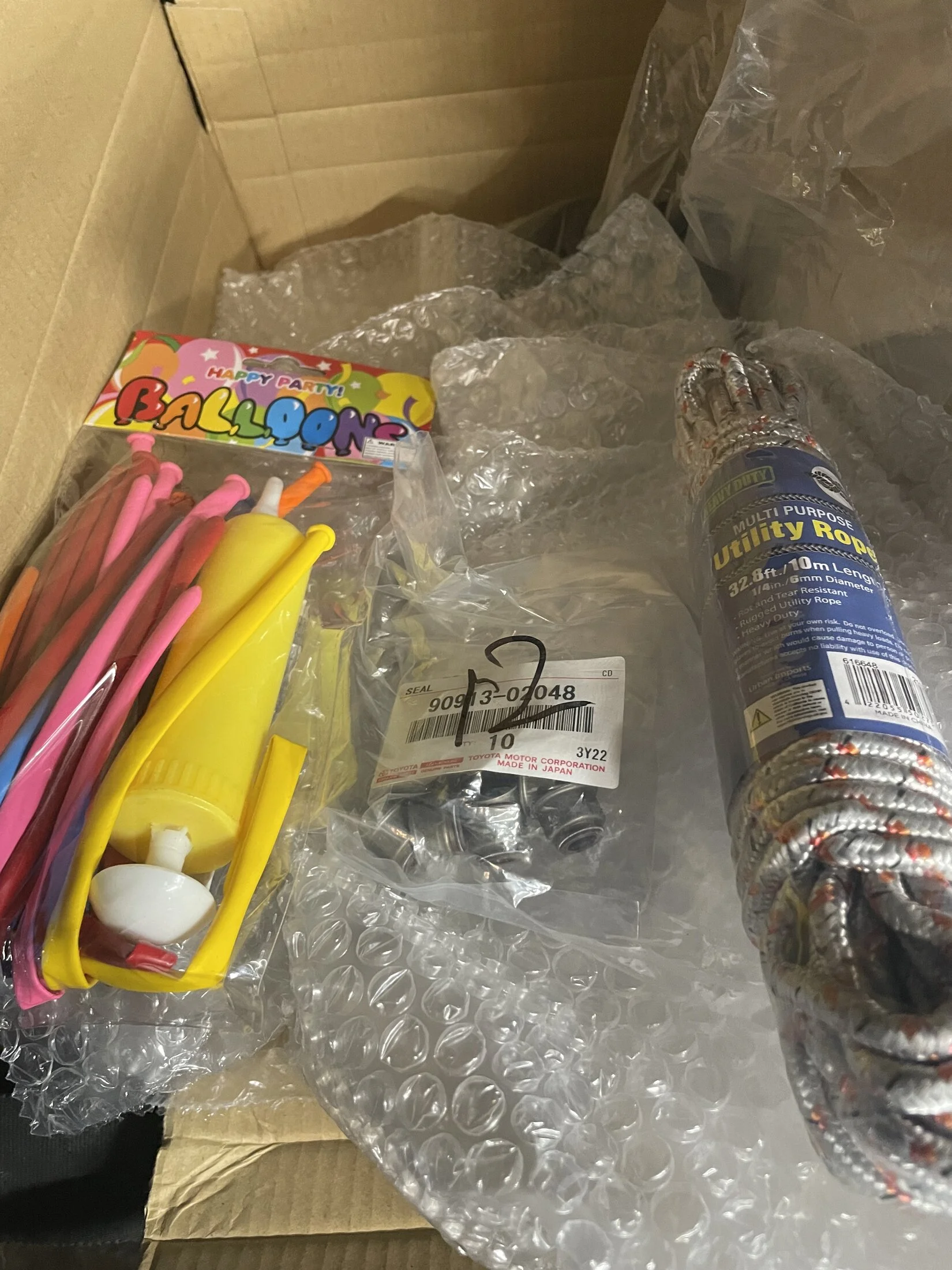

And the goods. Valve stem seals from Impex Japan, rope and Happy Party balloon valve stem rubbers (lol) from the dollar store. Seals were about $0.50 each, maybe less, dealer wants like $12. EACH. I did have to wait almost 3 weeks, however. Ok, have fun with the Engrish below, I know most folks on Mud is about 13 at heart... myself included...
Managed to break a plug wire when removing, and the PCV looks very original, so will be replacing those before firing this back up. Having this week to do it is a big plus.

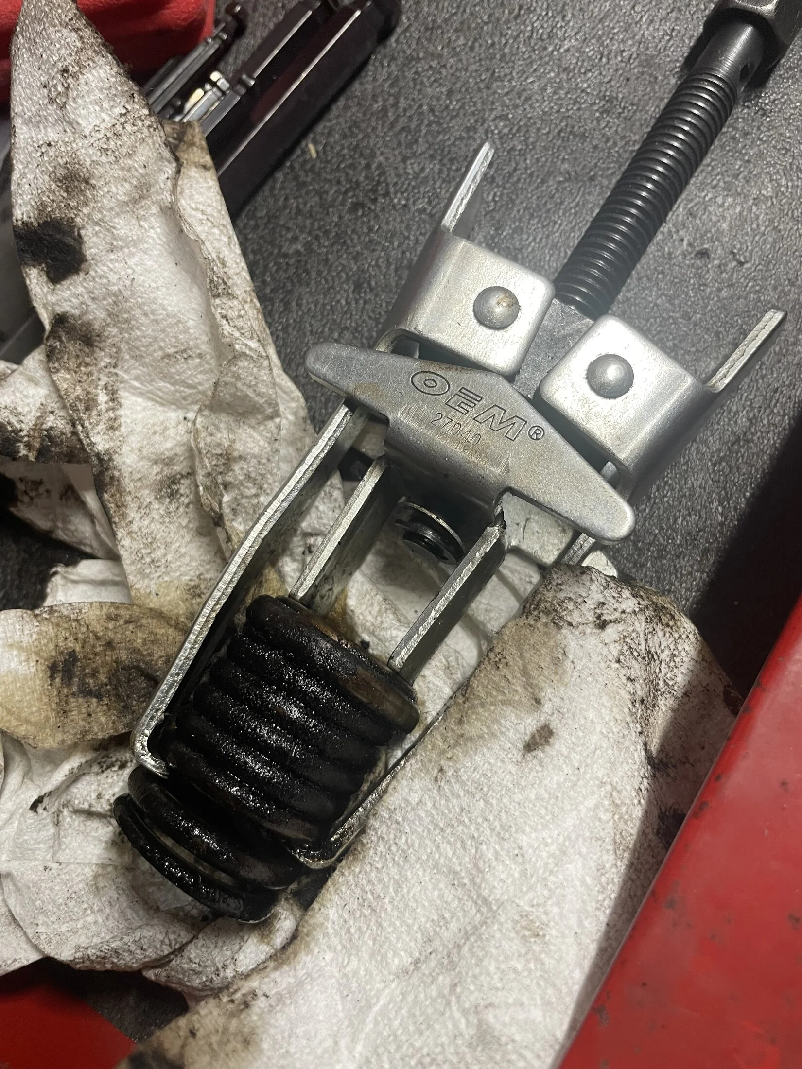

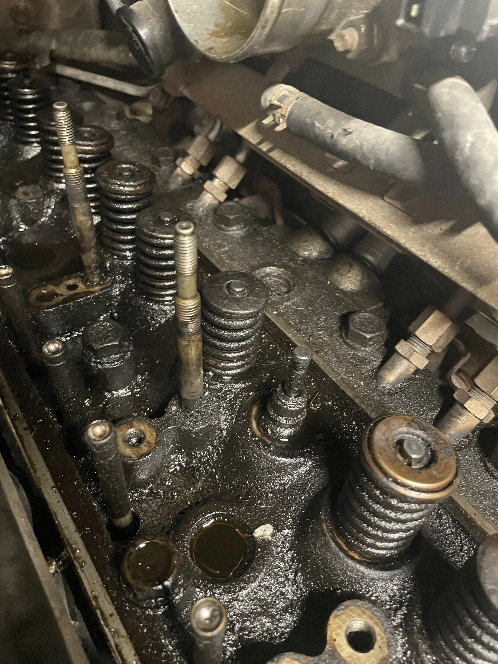

Valve stem seal win today, courtesy of the compression type tool from the 'Zone. This one works, needs some finagling to get it into position with the intake still in place but I was able to get through the tough cylinders with few hiccups.
For future searches, it's possible to change the valve stem seals on a 3FE with the head installed by using this tool from OEM Parts, looks like this:
Here's the part number and box:
Intake is shorter than the exhaust springs, but you want to have 5 coils under the compressor before cranking down all the way on the tool. This is harder on the intake springs, but what I did was to slot the tool into the coils as low as I could get them by hand, in line with the engine. Then, to get even lower, I rotated the tool 180* clockwise while making sure the grips didn't slip out of the coils, and then cranked down. It's not hard after doing it a couple times, but there was a lot of trial and error to come up with that procedure. If you don't get the tool low enough, it won't compress the spring down far enough to let you get at the keepers.

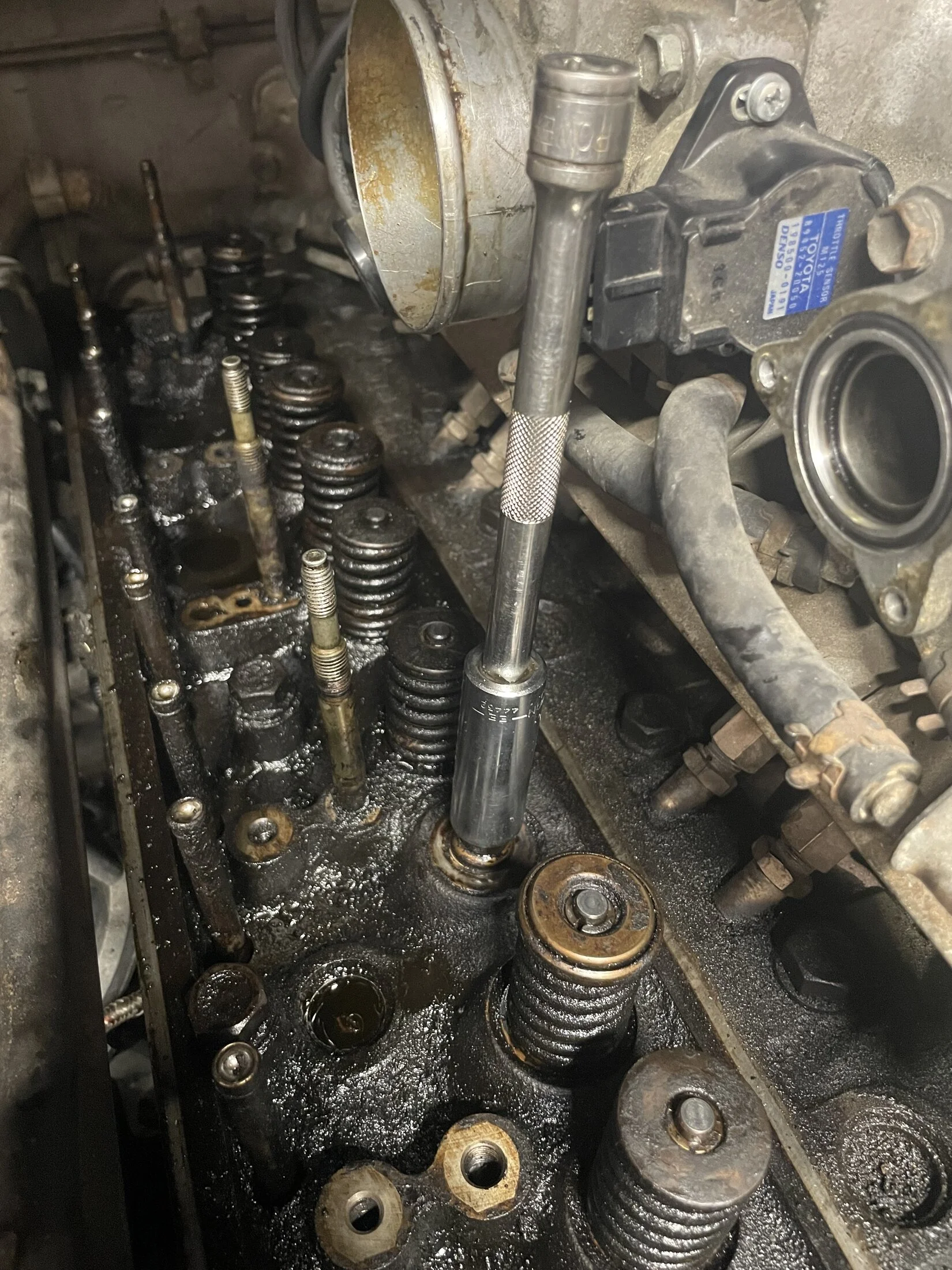

New seal under a 15mm socket, used the HF deadblow hammer to install.

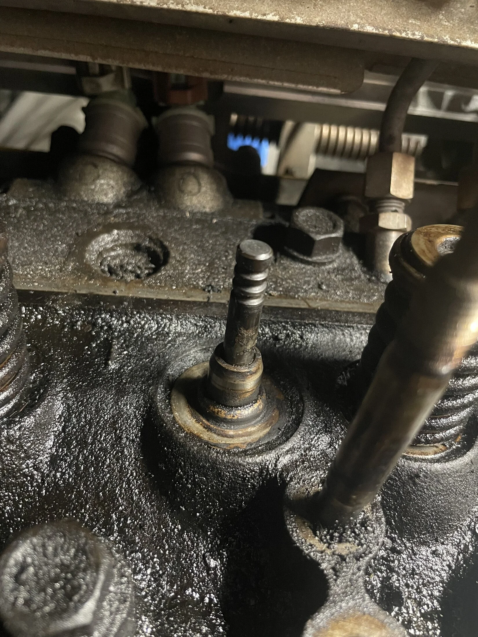

Found some light pitting on this stem when removing. Used a little red scotchbrite to clean it up and just going to send it. This is the only issue I've found so far aside from all of the seals being hard as rocks.

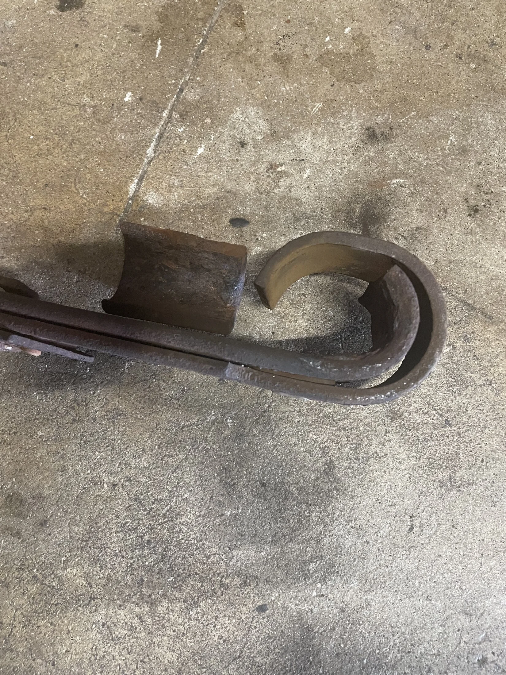

Quick update on this thread - got the driver's spring pin done, but found that the eye is very broken and has been for a long time. It was fused to the bushing, which was in turn fused to the pin, so no idea how long it's been like that. That spring is shot, though. In the process of getting one from Rob @landcrusher909 on Saturday to finish that out. I don't want to replace the springs with new just yet, may have a few decisions to make about this truck and want to keep the commitment low.

Week off for vacation - spent some time in the mountains with the family, returned yesterday and got down to business with that front spring. This was fairly easy given that I'd done all the hard work a few weeks back, when I was replacing the hanger pin. This is what I found, and what it looks like off the rig:
And it had been this way for a while, the rust on the broken part of the eye proves that out. Replacement spring from @landcrusher909 fit perfect and was exact same dimensions as the one I removed. A quick drive on the freeway, and all is well.

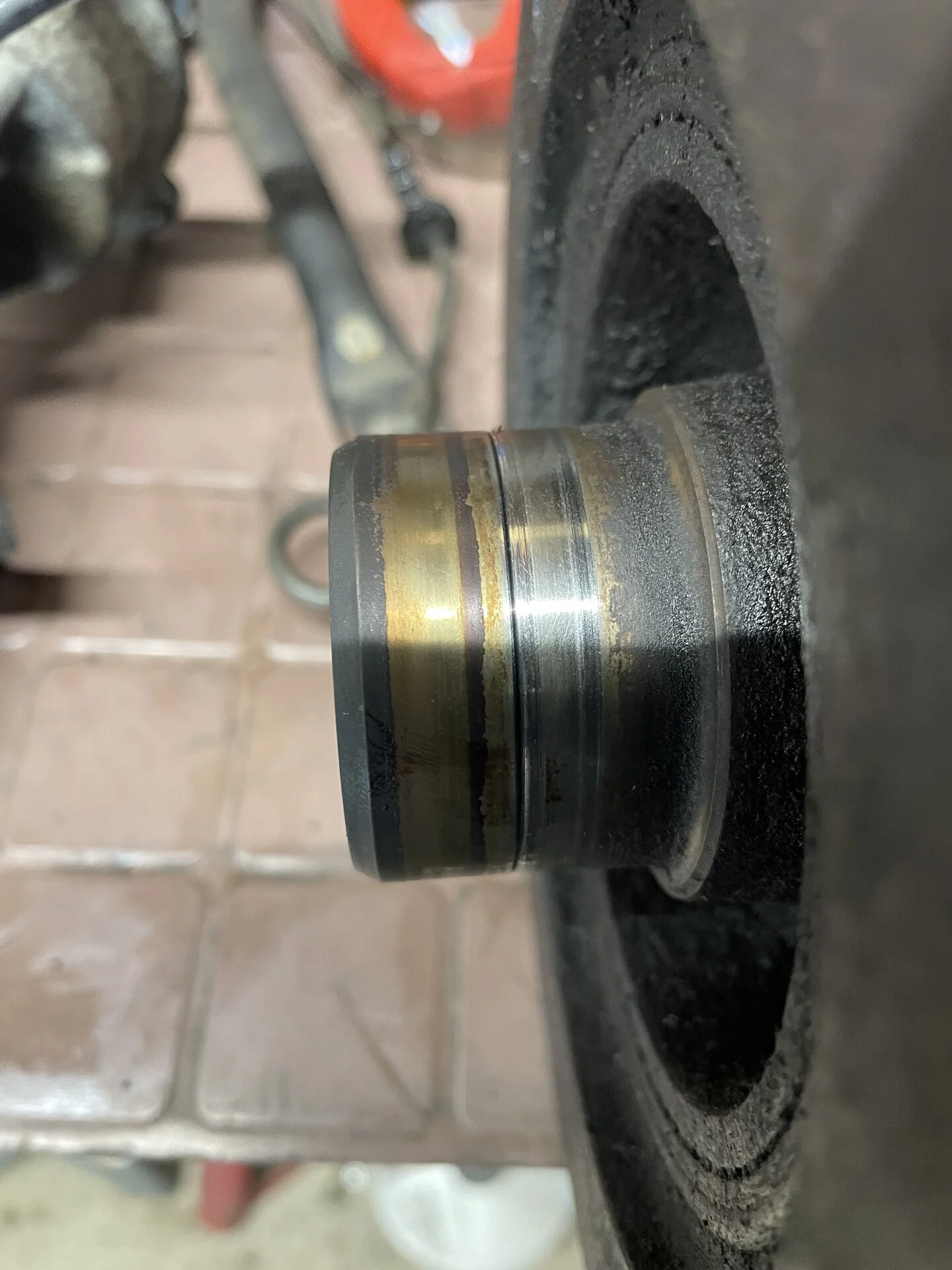

Stupid question but is this normal?
EDIT - just gonna sleeve this and move on. Woot!

"Sleeve" refers to using a Speedi-Sleeve, which is a thin metal cylinder that you put around a damaged rotating surface, like my harmonic balancer which was sporting a deep groove that was gouged in by a bad crank seal. The Speedi-sleeve provides a smooth surface to seal against when you can't just replace the rotating part. In my case, it leaked anyway, ended up spending $$$ on a new harmonic balancer and having to redo half the reseal job, but eventually it was all fine.

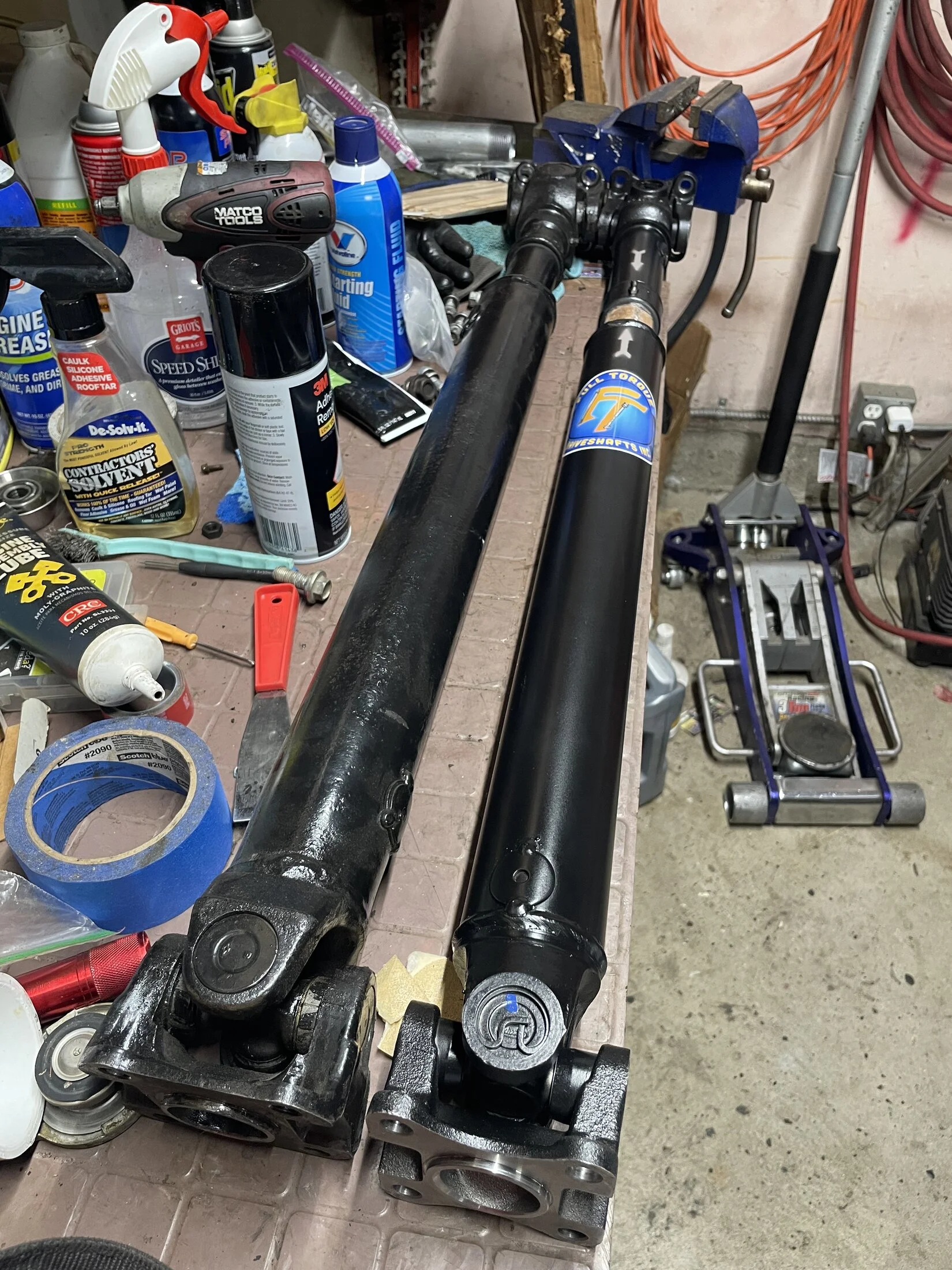

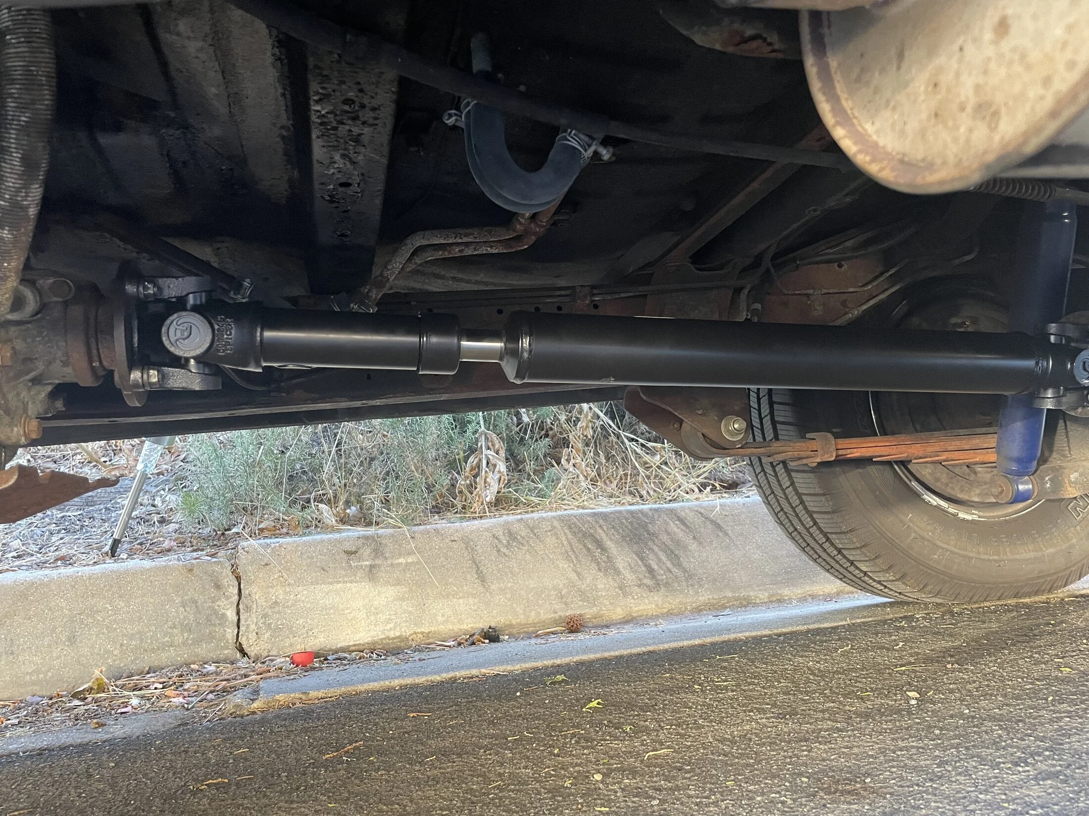

I highly recommend these guys, they did the d/s on my 1970 2002 and my old E30. Used to be based in Monrovia, moved to Hayden, ID, during Covid. Very reasonable for the quality as this was just over $500 shipped. Spicer forged yokes, Neapco u-joints. I should have requested greaseable u-joints but that's on me.
Full Torque Driveshafts

Non-greasable U Joints are stronger, not by a whopping amount, but stronger.
I figure they can be replaced with something else if / when they fail decades from now... if we're still allowed to drive these things then.
