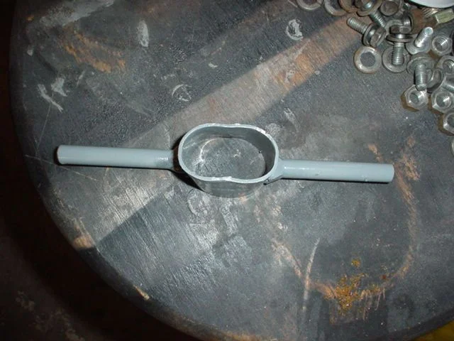

Great Removal Tool
attachment.php
Ed
second and third pics are of a tool I made to make it easier......:D
Squashed muffler pipe:idea:
I made a similar tool using your muffler pipe method and it worked great! I didn't even need to add handles. Thanks for sharing your great and simple idea for a gear shifter removal tool.
