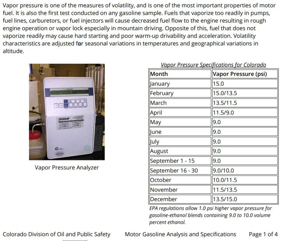

A. What is "excessive pressure?" Did you know US gasoline regulations limit fuel vapor pressure to 9 psi in the winter?
B. Why not? We know these trucks smell like gas. We know the fuel boils. We know that when there is pressure, there is no boiling. We know that gas = $$$ and saving $$$ = :)

In actuality, Lexus/Toyota EVAP systems were revised in late 2002 because the Clean Air Act was updated in 2002 and the EPA began requiring the new standards in December 2002. This is likely why the 2003+ 100 Series has a totally reworked EVAP system compared to the pre-2002.
The key detail being that the EPA relaxed the gasoline RVP (vapor pressure) requirements for gasoline containing ethanol down to 7.8psi. This is why during my testing I found my OEM Lexus fuel cap was venting pressure at 7.8 psi. So, in fact, Toyota specifically redesign the 100 Series for the 2003 model year to accomodate ethanol fuels and vent more pressure than before, the EPA was specifically allowing it.

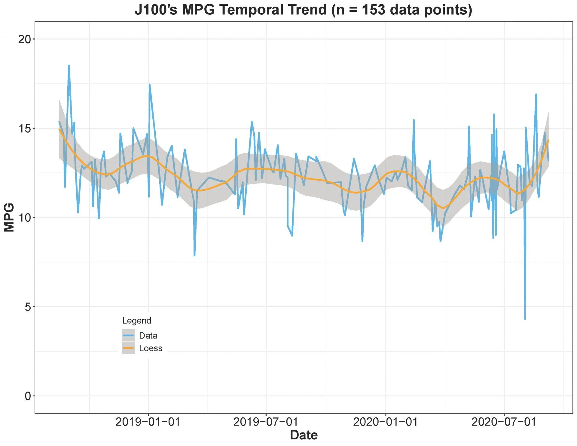

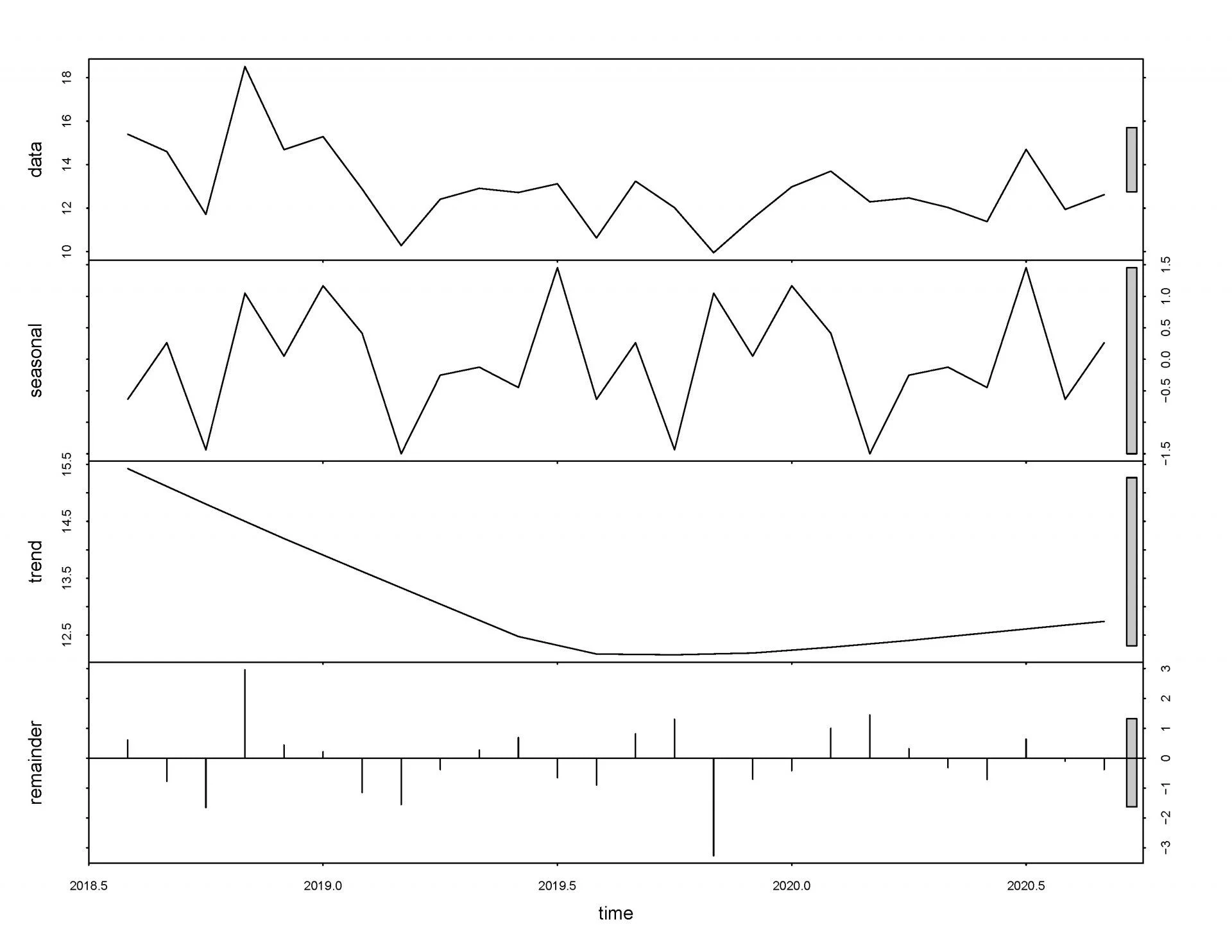

To interject some science into this discussion, I pulled all of the MPG data that @J1000 had on Fuelly. There's a total of 169 fuel-ups on there, spanning from August 2018 to September 2020; however, 16 of those did not have MPG data, so the final dataset is comprised of n = 153 data points. Summaries are below:
Distribution of MPGs combined across months and years, with mean, median, standard deviation (SD), and where 95% of the values lie (between the dashed orange lines; i.e., -/+ 2*SD). You can see that 95% of the MPG values fall between 8.56 and 16.04 MPGs. So, anecdotally, just based on the raw data, the 2 MPG increase claim by @J1000 doesn't have much, if any, support.
Here's the raw data across time (blue line) with an estimated Loess smoothing spline from a generalized additive model (orange line) and the associated 95% uncertainty intervals (gray shaded area; *not confidence intervals*). Dates on the x-axis are Year-Month-Day. You can some evidence of seasonal fluctuations here, perhaps corresponding to seasonal gas blends. Note that summer blends and winter blends are introduced in CO (where @J1000 lives) by May 1 and September 16 of each year, respectively, but I need to fit a model with blend as a covariate to see if such an effect actually exists. Nevertheless, the 2 MPG increase claim doesn't have much support across time either; again, based solely on the raw data values.
To directly investigate @J1000 claim of a 2MPG increase, we'll have to wait until he's done collecting data for the entirety of September 2020. His changes to the fuel/EVAP/cooling systems were made at the end of August, so we should at least give it a full month of data collection. However, we can use the data from previous months to in a time series analysis to predict what his expected MPG value will be for September 2020 and then compare that to his final MPG value for September 2020. To do this, I subset his data into model data and test data, whereby models were fit to the MPG data for August 2018-September 2019 and the test data used for model validation (accuracy testing) were the MPG data for October 2019-September 2020. I then fit some exponential smoothing state space models to the data without any covariates (e.g., excluding seasonal gas blend from consideration).
I got tired of making fancy figures so you get just a basic output of results here. The first box shows the raw data (average monthly MPG) with a smoother applied, the second box shows the predicted values from the best model, the third box shows the estimated longitudinal trend over the entire period, and the fourth box shows the estimated amount of unexplained variation that exists. Prediction accuracy from the best model was quite good despite the small amount of data, having an RMSE = 1.19 and Theil's U = 0.75 (U < 1 means that the model is better than informed guessing).
Ultimately, the model predicts that @J1000 MPG for September 2020 will be 12.65 (95% PI: 8.5-17.8). Note that the current ~14 MPG that he's observed over the last week or so is well within the 95% prediction interval. Thus, the 2 MPG increase claim is thus far not supported, is within 95% of the observed data over the last 2 years, or is likely due to chance alone or simple random/unexplained variation. However, the caveat is that, as noted above, he has very few data points since making all of the changes to his Cruiser, so again, we can reevaluate at the end of the month.
I would have settled for the standard deviation, but I'll take the distribution, trend and other plots. :) Kudos to figuring out how to extract the data (I'm sure there was a download link, but I wasn't seeing it) and thanks for giving us a confidence interval. I'm happy with my 1.5-2.0 estimate when the answer was 1.87.

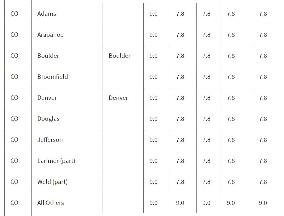

That's only for the summer "ozone" period (May 1 - Sept. 15), not winter. Winter allowable is up to 15 psi in most states, including CO (https://www.colorado.gov/pacific/atom/18701).
Note that if you're buying gas in these CO counties between June 1 and Sept. 15, the allowable vapor pressure is only 7.8 psi. (Gasoline Reid Vapor Pressure | US EPA):
Interesting that the lower vapor pressure counties are due to ozone nonattainment. I wouldn't have pictured CO having air quality issues.
5 million people live in the Front Range, which is where all those counties are. That's on par with Phoenix, and we have horrible air quality issues here...
Fair point! :) I guess the population density has increased there much more than I thought. I don't travel to that area very often, since I have to pass by so much cool stuff to get there.
