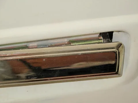

My driver-side door handle is a cheapie aftermarket replacement that the PO did - he did tell me when I got her - so I'll be looking for an OEM part sometime soon. As many other cheap aftermarket bits, it broke! The main hinge pin came out of it's hole, notice how it droops on the right hand side:

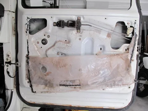

So, following Tom's excellent thread - https://forum.ih8mud.com/40-55-series-tech/370889-tackling-doors.html - I removed the trim. At first I did not believe Tom's trick with the cloth and the window winder - but it worked beautifully:

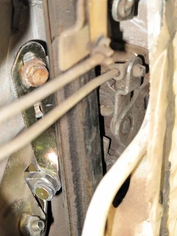

And had to remove the handle from the inside:

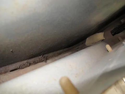

While the trim was off I had a check inside the door - PO said he did regularly give it a spray with oil/diesel mix to stop the rust. Thank goodness for that - the brown you see at the bottom is just red dust. So I scraped, brushed, vacuumed, and blew it out. Before putting it back together I gave it a liberal coating of cavity wax, making sure that the drainage holes at the bottom were clear - should be good for a few more years:

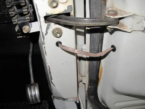

When I fitted the radio I left some extra length on the speaker wires, so now was a good time to get rid of the old and run the new wires right to the speaker. Added a couple of rubber grommets to the holes as well:
