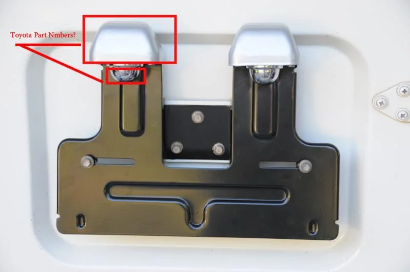

mate sweet truck love how you scored all them little parts from japan was that a expensive exercise ? i need alot of the similar bits for mine , and do you think you will ever need the heater in brisbane ,) thinking about disconecting mine as the metal fitting and elbows on the firewall for the water have rotted out and are weeping the hunt for parts is never ending , just had the injector pump rebuilt in mine took 6 weeks for 1 part and a unhealthy hit to the bank balance , dont use diesel additives unless your tank is spotless if any gunk goes through your pump it causes pain , and try keep your tank full , being in qld lots of condensation can end up in ya tank and mixed with 30 odd years of diesel from god knows where my tank ended up with a inch of black slimey goo in the bottom of the tank , the additive lifted it all off and straight through everything the tinyest bits scored the innards of the injector pump and it went bad just saying as it is avoidable pain , you can undo that panel in the centre of the floor just behind the front seats and remove the sender unit and see if ya tanks clean i highly recomend it , and nice work its coming out really well

And last quick random update, the number plate holder finished and fitted:
