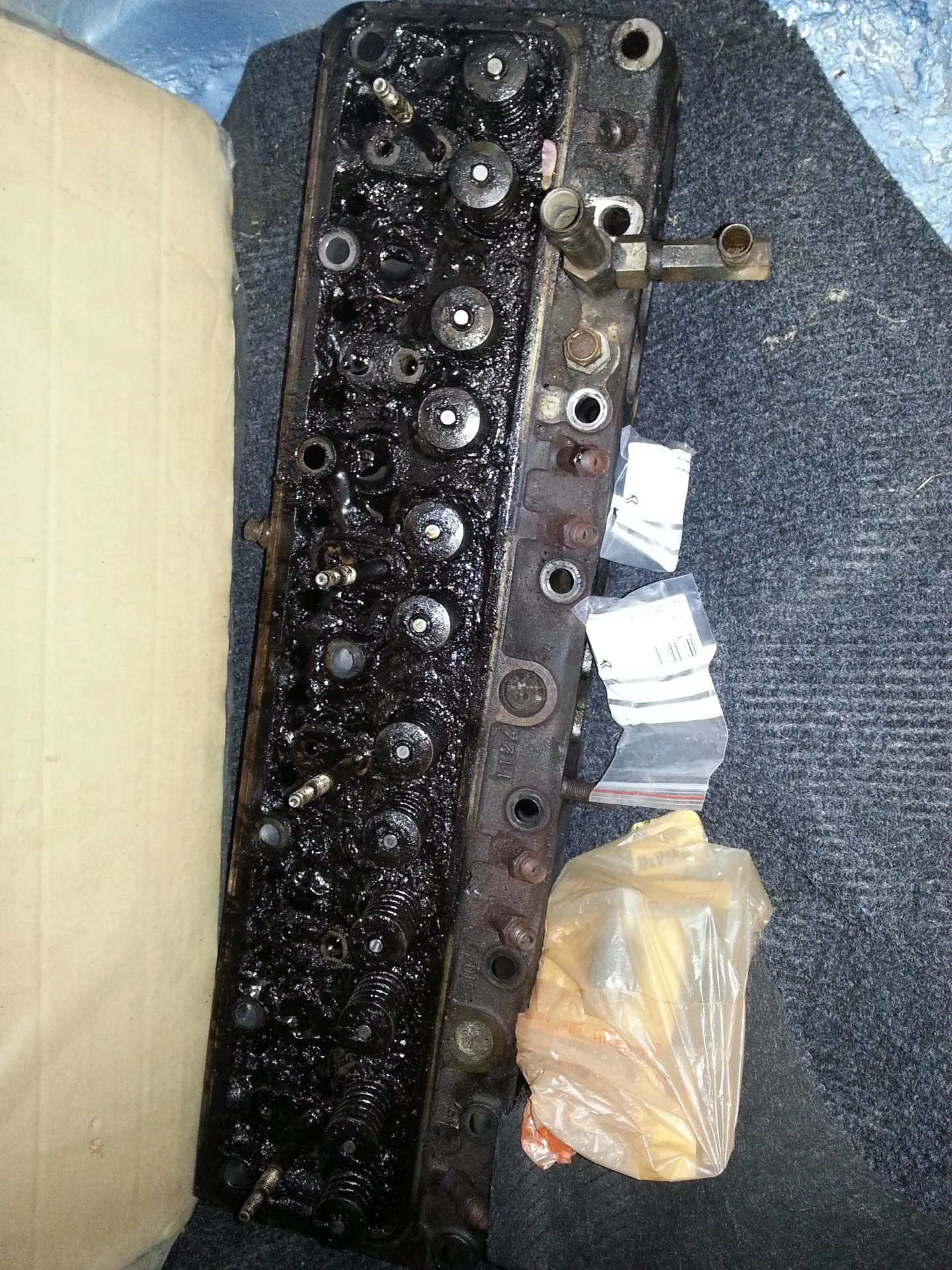

Things just got expensive. After cleaning off the sludge the shop found cracks in the head. :(
I didn’t want to say anything, but that is more common than a headgasket failure in 60 heads. My condolences, hope you find one quickly and cheaply!
That stinks G... sorry to see that. @CenTXFJ60 no chance you have a good head kicking around in that big barn?
Thanks Fel, I need a 61040 head. The other number on the head is 1124 ...maybe a cast run number? Not sure if it's necessary. I did post up a "wanted" ad in the classified.
thanks. I've got a few leads, unfortunately shipping will be involved.
If you mind me asking, what were the "leaky head gasket" symptoms you were having? I might be on the same boat.....
signs and symptoms of a leaking head gasket I mean cracked head.
1. Coolant puddling up on top of the head. Take off the valve cover and check it. The gasket is rubber and can be re-used.
2. Exhaust pressurized cooling system. Evident by opening the radiator cap while still cold and having coolant pushing out.
3. I was losing coolant but never saw a drip or leak. I would top off my radiator about every 2 weeks with about a quart more or less depending on how much driving I was doing.
Interesting to note, My head repair guy said once he cleaned the sludge off the top of the head he could see rusty areas. He said that is usually a sign of a crack. Then he magnafluxed those areas and you could see the hairline cracks.
I never lost power. I never had milky oil although most likely some coolant did get in the oil. I never had lots of steam or white smoke at the exhaust pipe even at start up.
#4 and #5 .. caused by thermostat gasket out of position. Mine had slipped upper gasket on the t'stat so maybe no so much a symptom of a cracked head unless the exhaust gas pressure pushed it out of position.

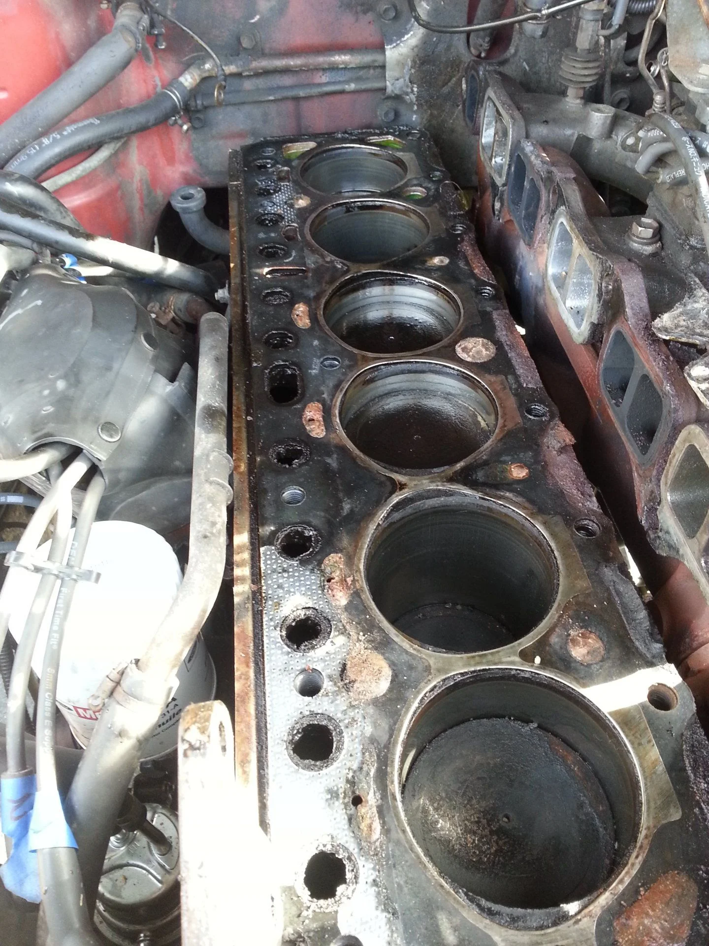

Carnage shots:
