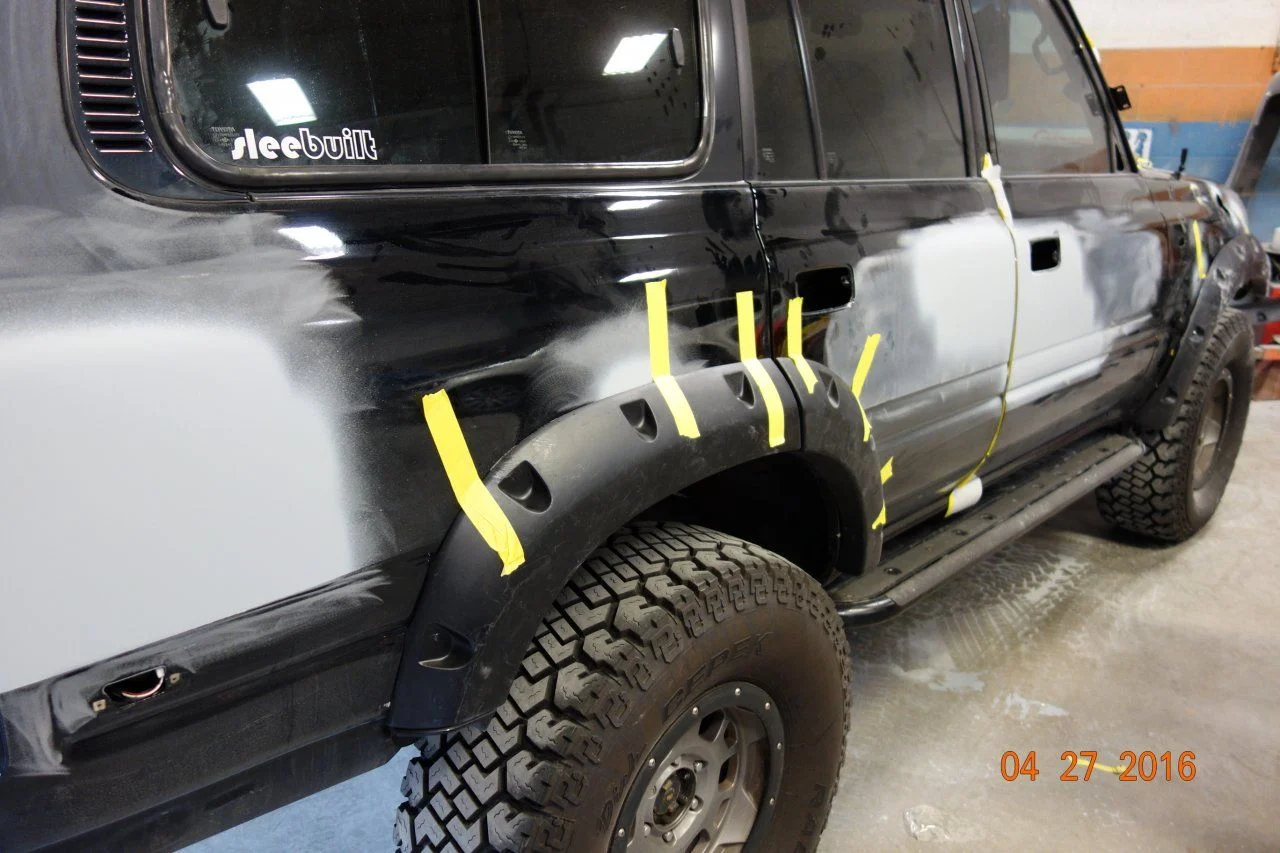

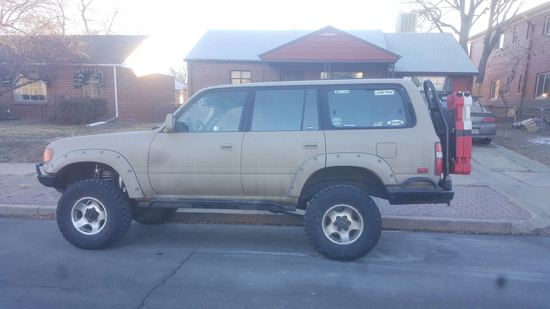

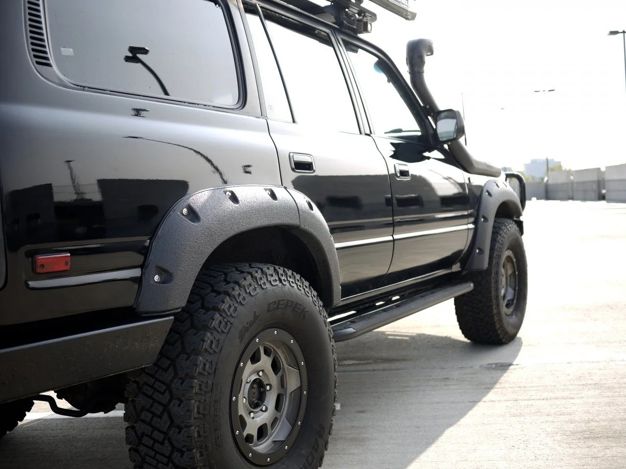

Added the flares last year.. Used stainless nutserts for easy removal..had the flares Line-X and used 12 point stainless flange bolts and countersunk washers as hardware. You make a great product

Beautiful work and a great looking rig!

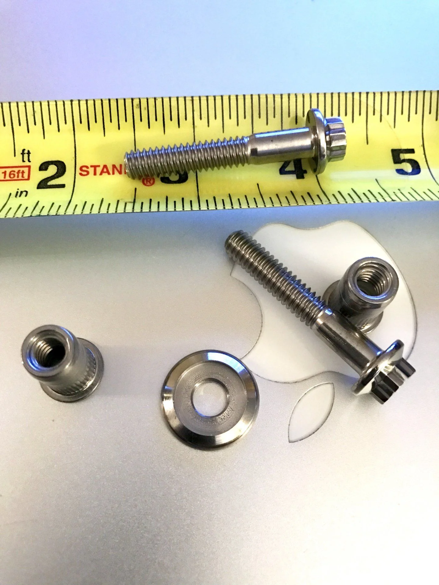

Do you have a link to all of the hardware you used? Looks great!
I followed what another member did and ordered the stainless hardware in the first pictured but wanted something a bit more substantial looking and ordered the 12 point flange bolts and countersunk washers in the same size so I could use the rivet nuts I ordered
I ordered 1/4-20 x 1 1/2
He posted the first picture on page 5 of this thread and a link to his install but I had to order a larger rivet nut tool than the one he posted to set the stainless Rivet nuts
