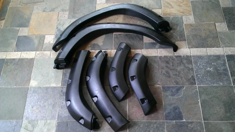

We made it out about when we said we would. These pocket flares will fit any 80 series truck, but this set is made so that 93-97 mud flaps will bolt up.
They are made with fiberglass and high quality flexible resin so that they are very durable and flexible. The consensus I have observed is that the most common cause for the stock flares to fail is the internal fastening tabs breaking off. These flares use fastening hardware through the pockets to mount securely and will not separate due to broken tabs.
IF a flare is damaged it may be repairable (broken tabs on the stock flares are not repairable) or a one off replacement flare may be obtained. The flares include Torx hardware, gaskets, and they are primered flat black.
$560 for full set with or without 93-97 mud flap attachment points including trim gaskets and hardware.

New holes need to be drilled with a 1/4" bit. The bit has to be exactly 1/4". There are no stencils, but the 93-97 pocket flares are the exact same dimensions as the stock 93-97 flares so there should be a mark left from where the originals did reside.
I would say that it is a :banana::banana:job mainly because good care is required to not over drill the flares when installing. The flare needs to be held in place by hand while the first hole is drilled and then the first self tapping Torx bolt is carefully installed. Clamps won't work since there is no way to get to the other side of the fender without removing it. After a top bolt is installed it is much easier to do the other bolts alternating from side to side as the flare is pulled tightly against the gasket and fender.
The bolts are only tightened to a snug fit so that the flare is pulled against the fender. They won't back off. If a mistake is made you would have to get behind the fender to put on a washer and a lock nut. I provide 3 extra stainless washers and nuts just in case. If your not confident in your wrenching ability I recommend that you get help with installation.

Same width as stock 93-97 flares.
There are no fragile tabs to break off or crack. These flares are functionally attached via Torx bolts through the pockets (yes, holes are drilled through the pockets and the fenders in one easy, but careful step) avoiding the stock mounting locations.
