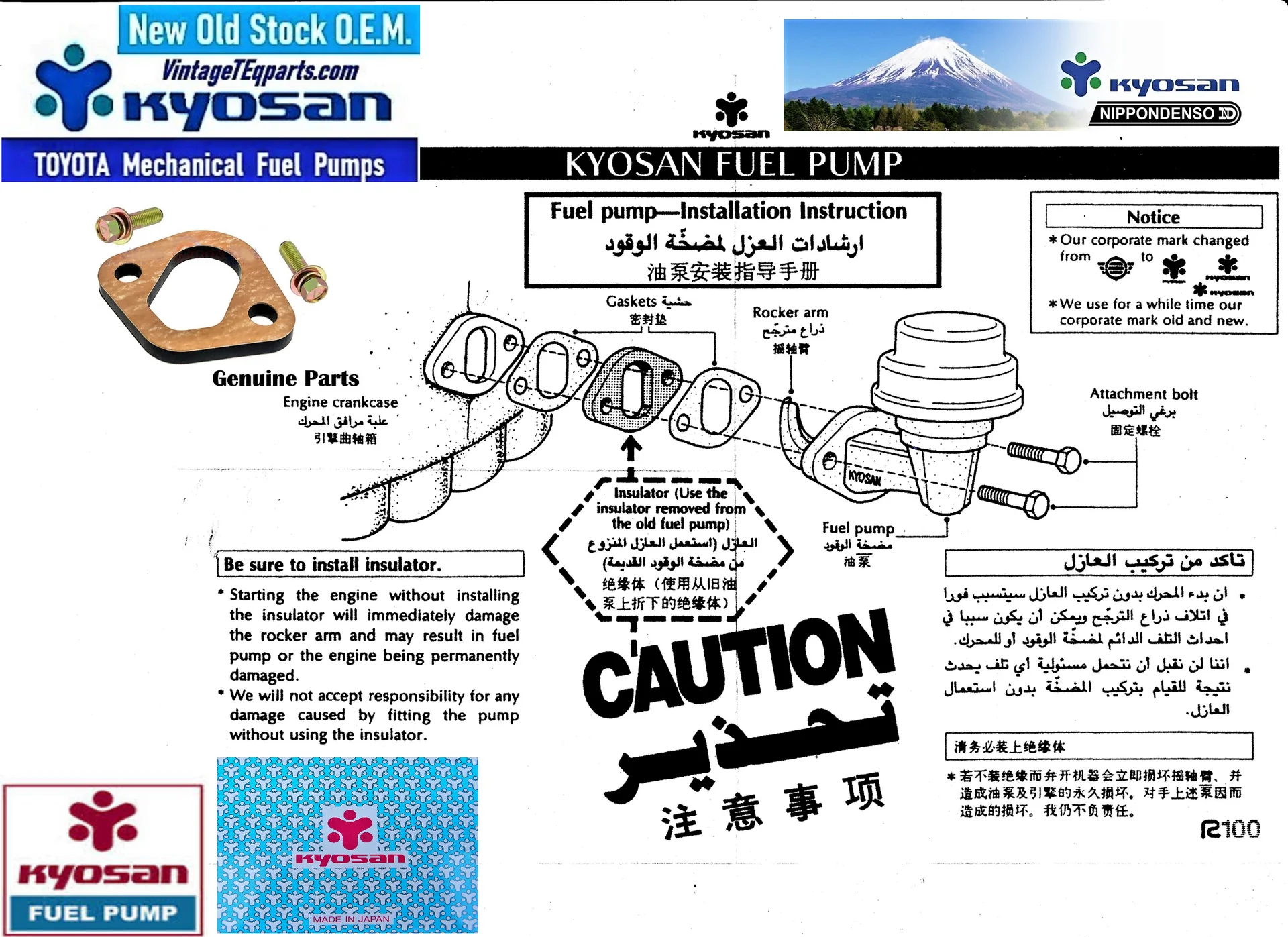

the later pump needs a spacer

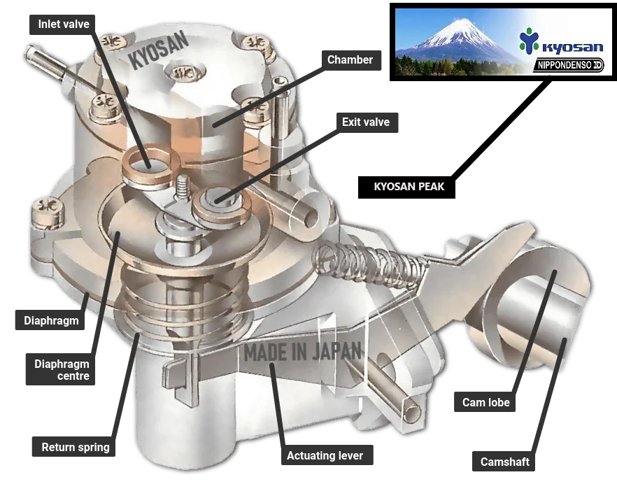

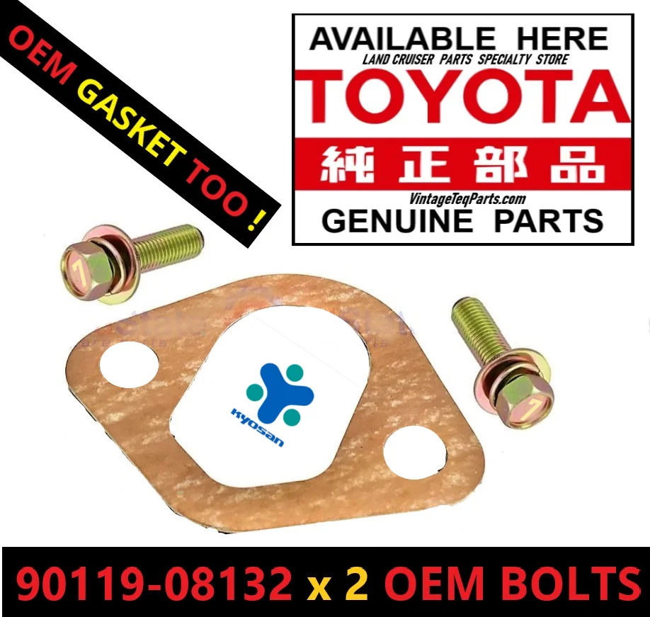

considering you get , the qty x 2 NOS OEM correct fuel pump bolts , the correct Spacer w/ pre-installed factory gaskets , and its OEM TOYOTA made in JAPAN, spec.
a NEW pump will serve you well for many many years , PLUS it has the Internal pressure regulator and 3rd return line feature bult-in
- this is TRULY a modern age refinement your old 1973 FOSSILE ...
- a FJ60 modern HIGH - MEDIA filter is a MUST DO and well worth it Too !
