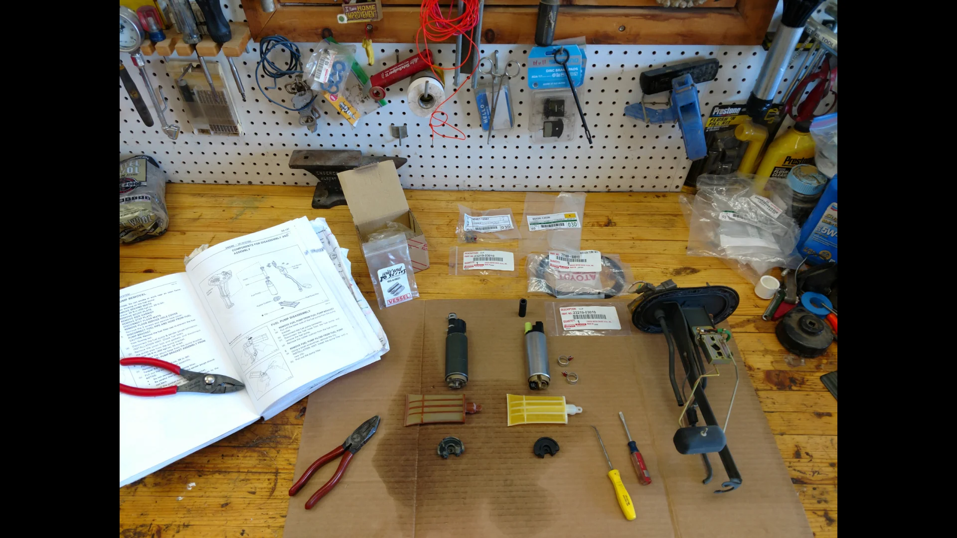

Finish my fuel pump everything new project a few weeks ago.
:banana::banana: easy and very straight forward.
I double checked all the fittings the connections the new rubber bushing for the motor and left the fuel tank access hatch open overnight went back and retightened all the rubber seal screws.

Just completed this morning and *thank you* all for the info and part lists above. I think this was the first replacement since new so I replaced the whole assembly and new pump.
  • My old filter kinda had/has a hard plasticy feel not soft meshy like the new replacement. Guess sitting in gas for 25 years will do that...
  • My assembly didn't pull straight out of the hole and I had to twist bend and shimmy to pull out. I was thinking nuke detonator but CO would be in trouble if that was the case. Same going back in. 💣
  • The screws holding my sender gauge assembly to the bracket were fused on and were a real bear to remove. Thankfully the new sender assembly came with replacement screws as I stripped the old ones.
  • I could not get that damned clip on securing the filter and had to race to Ace for a different version.
