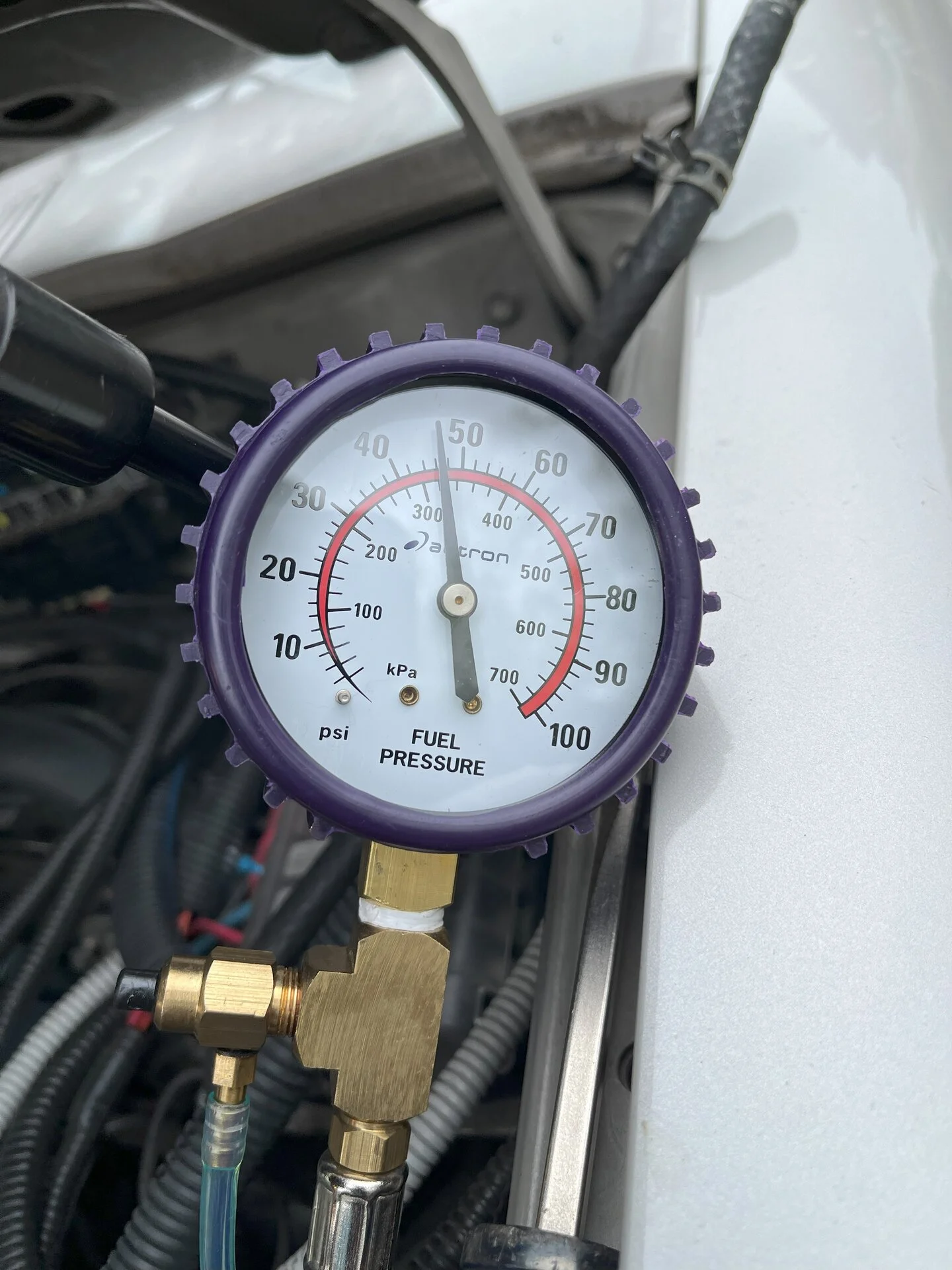

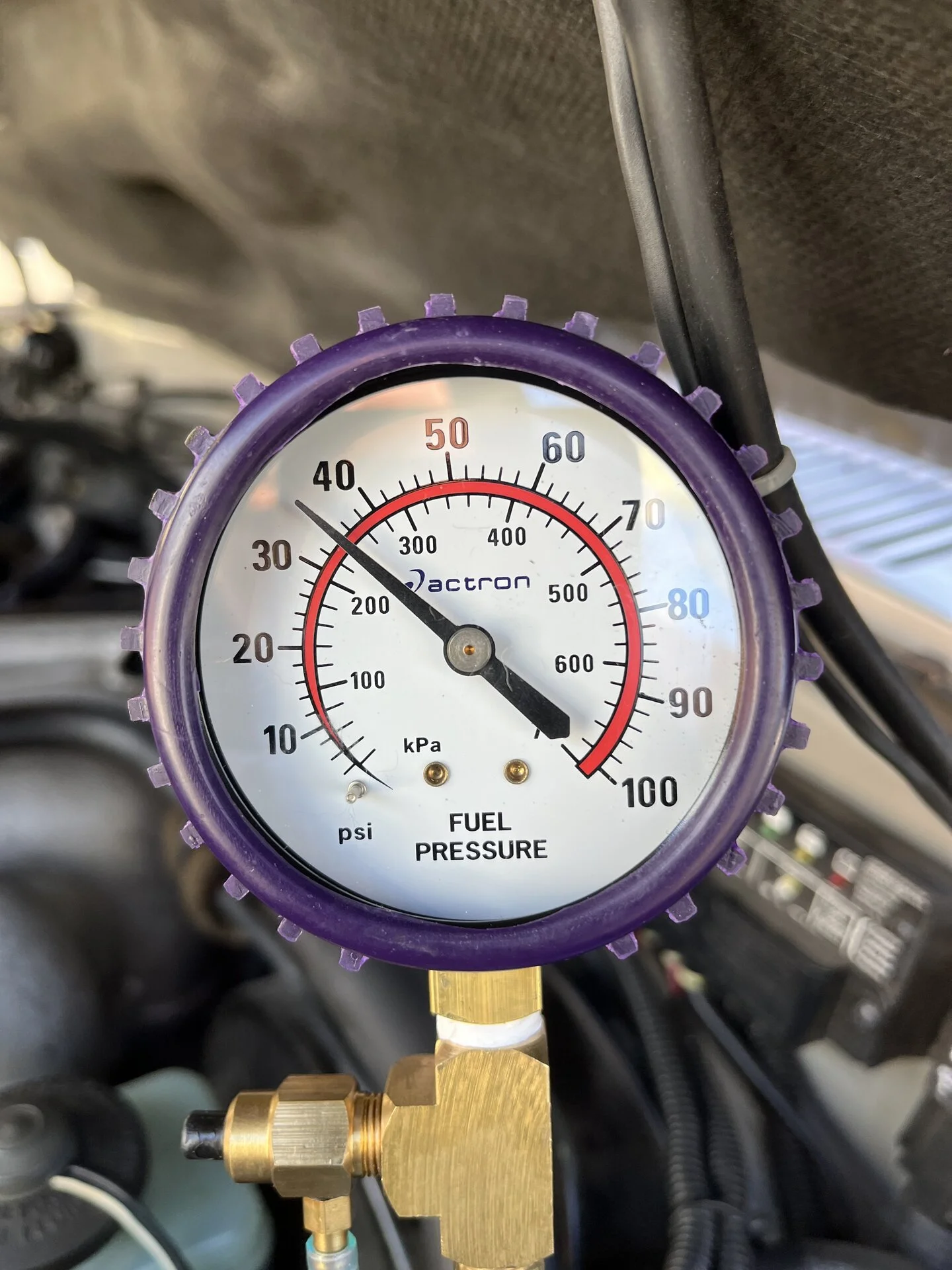

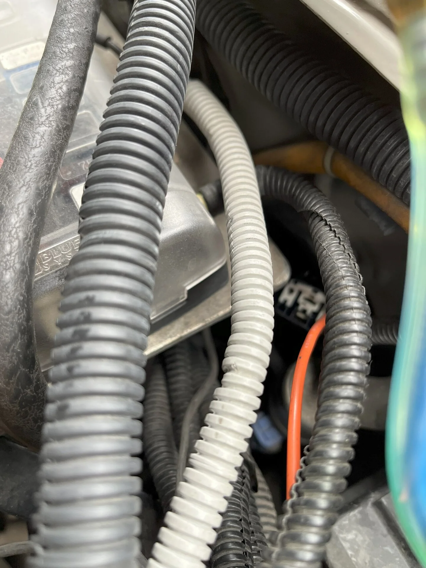

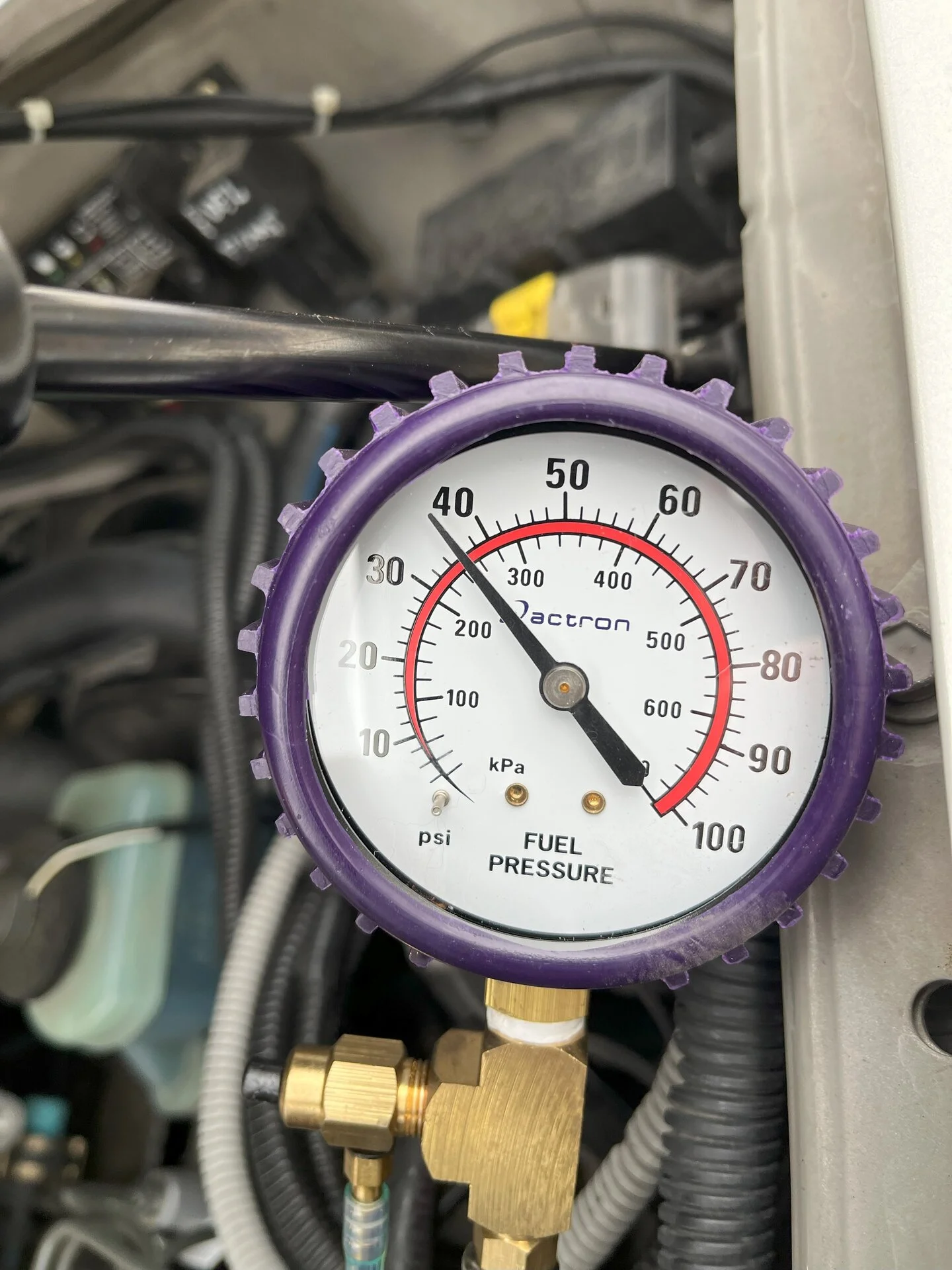

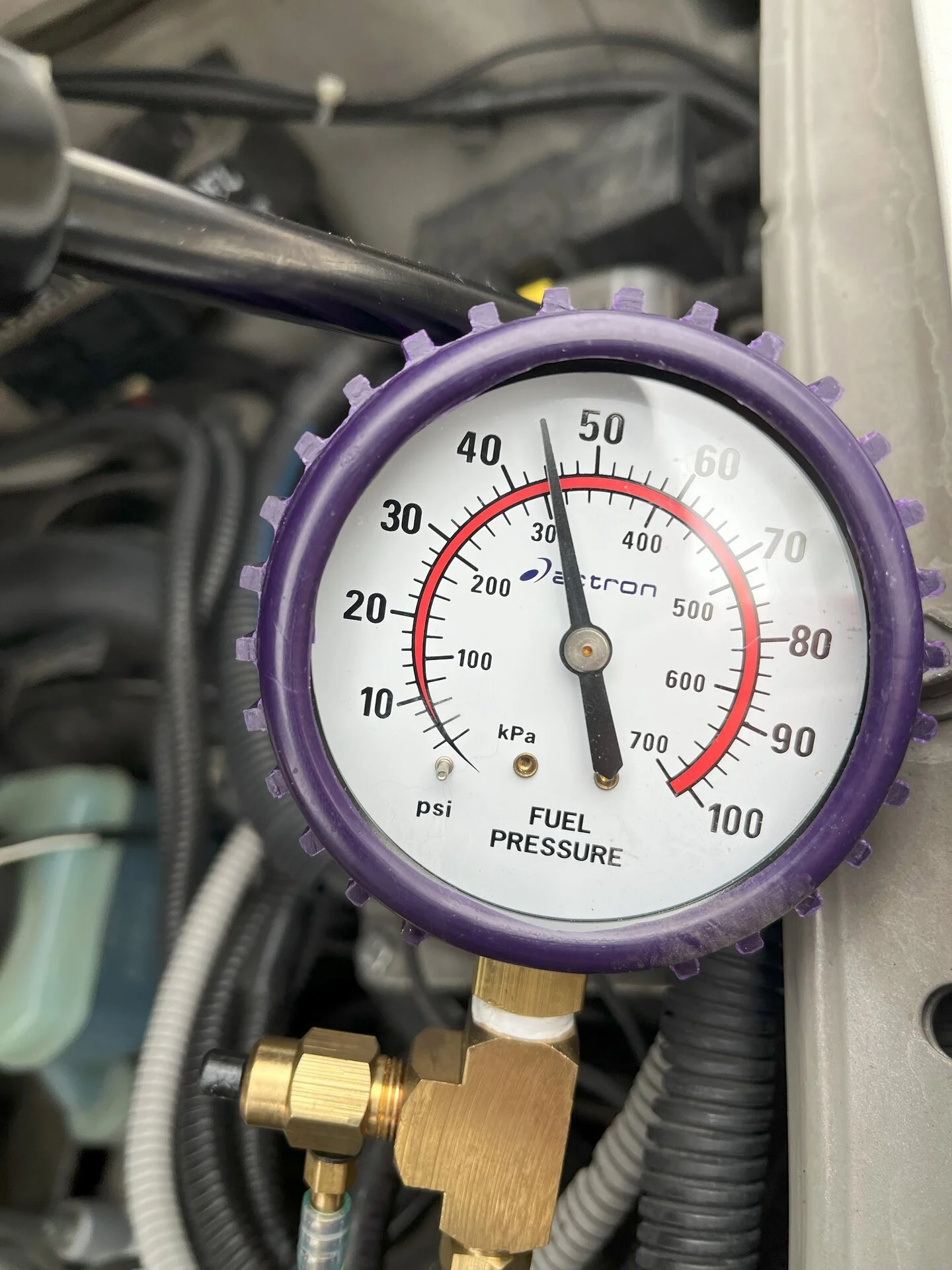

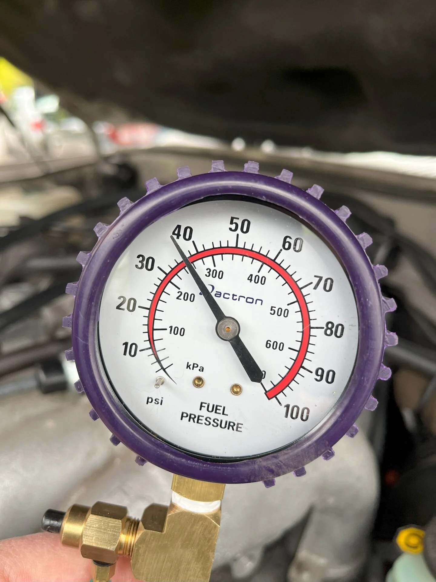

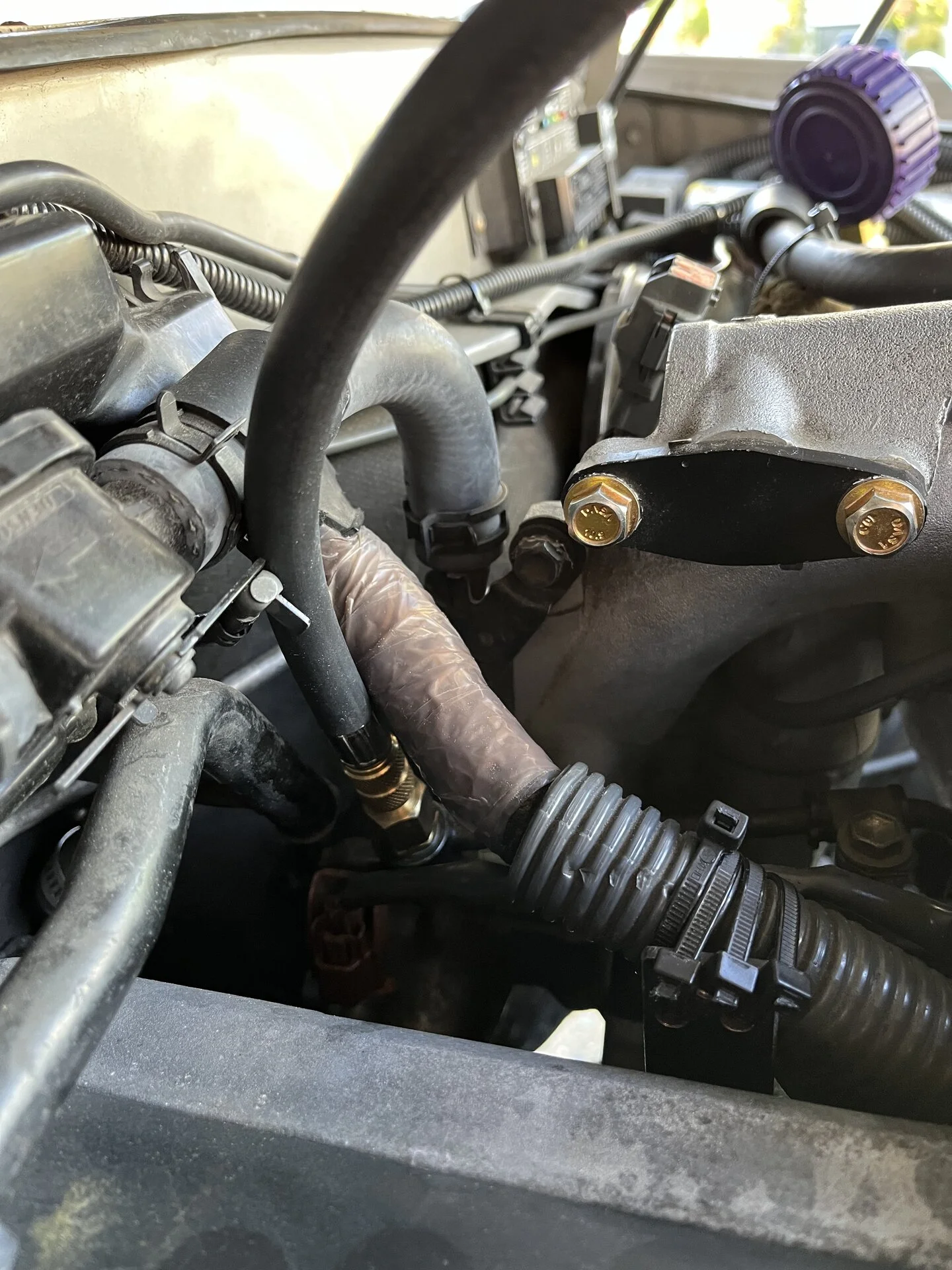

You forgot one possibility, faulty pressure release on the gauge. When I did the initial tests, the needle on the gauge was very stable and the it held pressure after 5 minutes. I did a retest and the needle on the gauge was jumpy and it didn't hold pressure. Based on this and the fact that I didn't check with the fuel pump powered but engine off, I decided to recheck this morning. I pulled the fuel pump relay, which was a pain because it is buried under my added fuse box, and jumped pin 3 to power.
Results all look good to me, a little high but I think that is better than low.
FP on, engine off: 47 psi, spec is 38 - 44 psi
Idle with pressure regulator disconnected: 45 psi, spec is 38 - 44psi
Idle after reconnecting pressure regulator: 36 psi, spec is 31 - 37 psi
5 minutes after shutdown: 36 psi, spec is 21 psi minimum
FP on, engine off
Fuel pressure regulator vacuum disconnected:
Fuel pressure regulator vacuum reconnected:
Engine off after 5 minutes:
Jumping FP relay:
