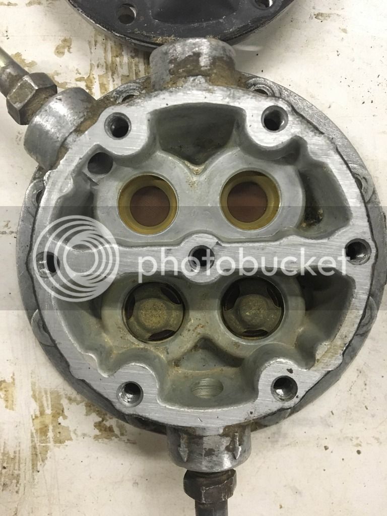

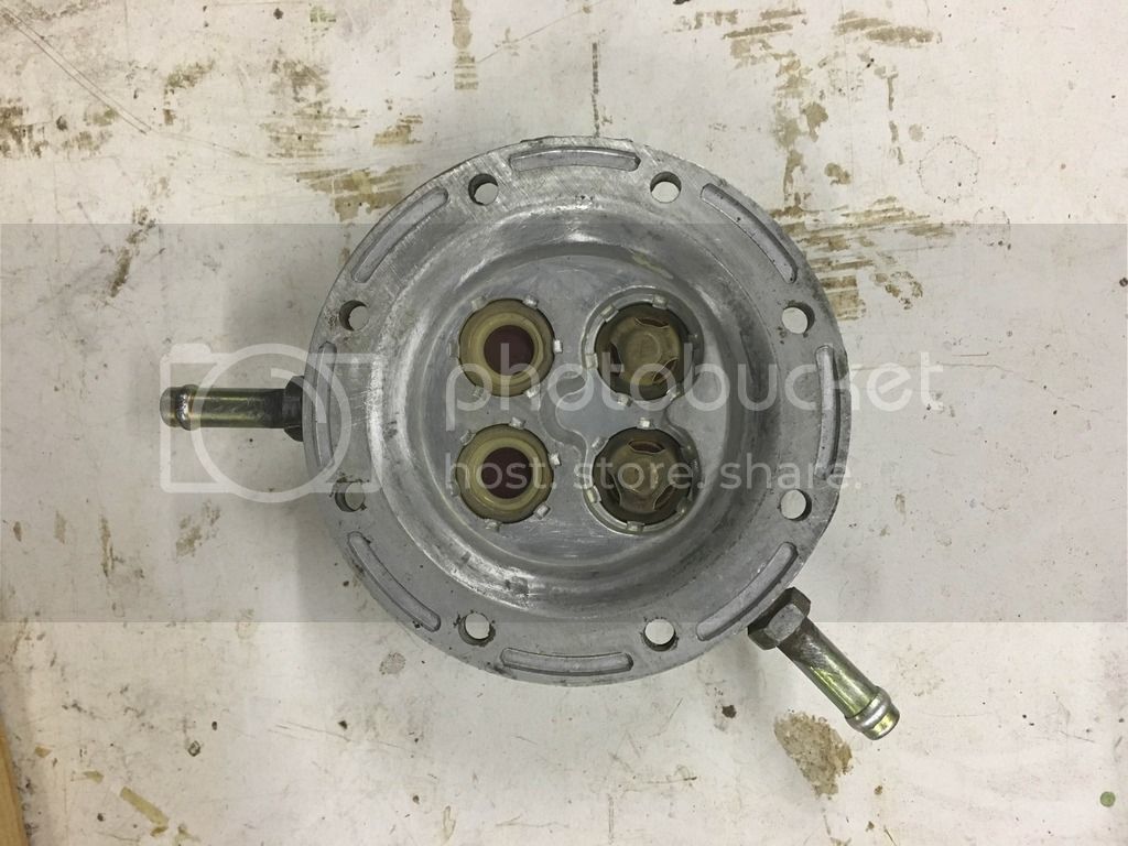

Pics of the pump?

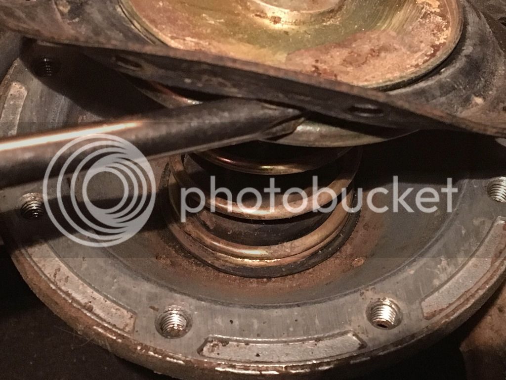

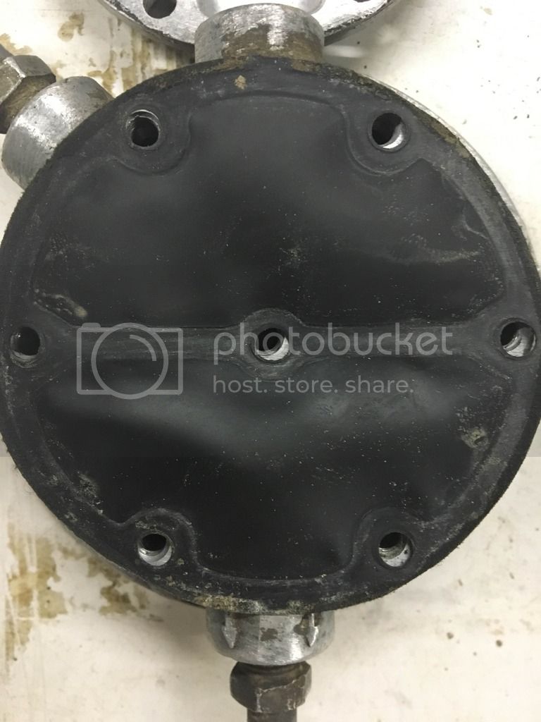

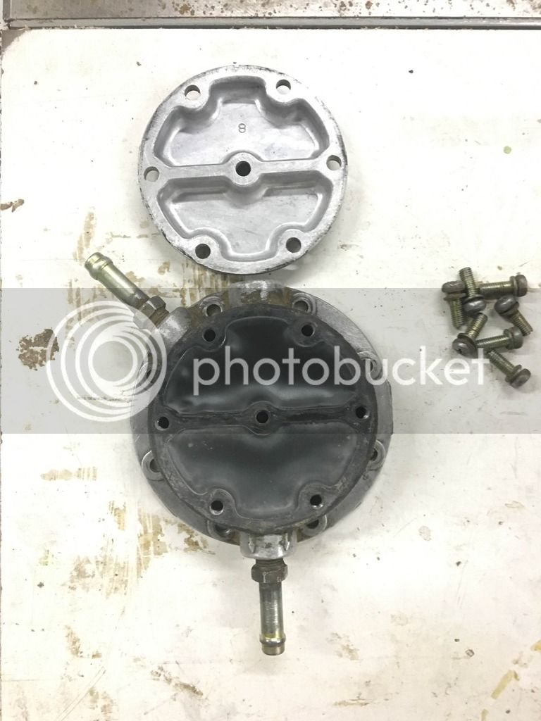

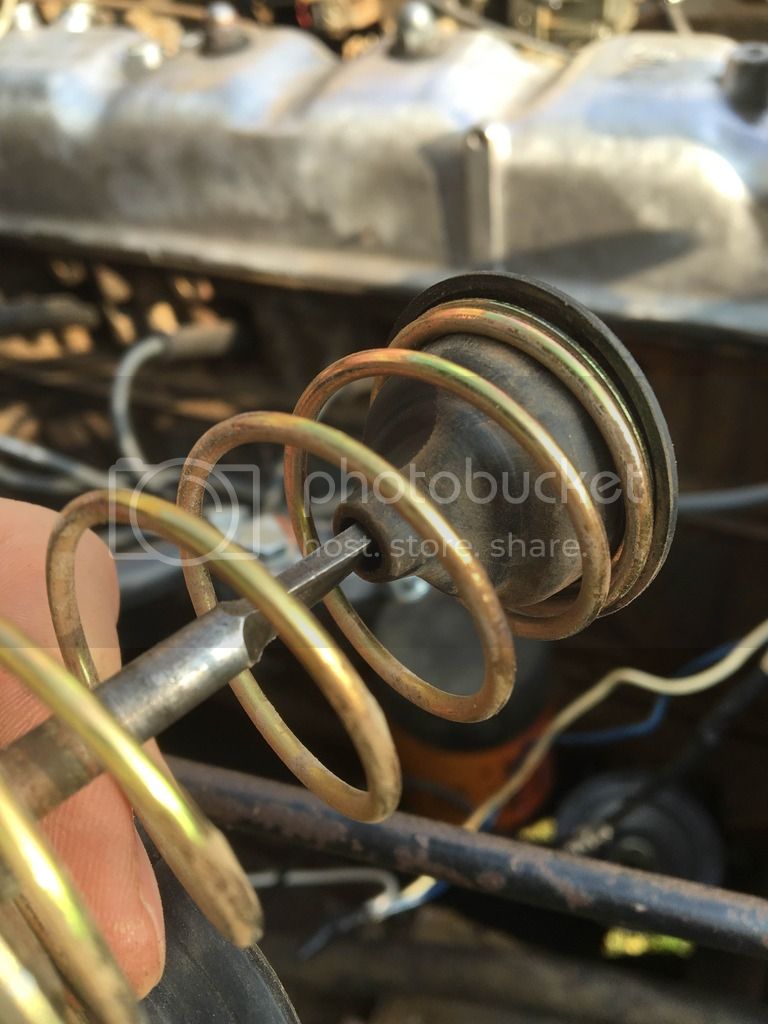

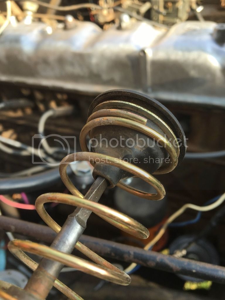

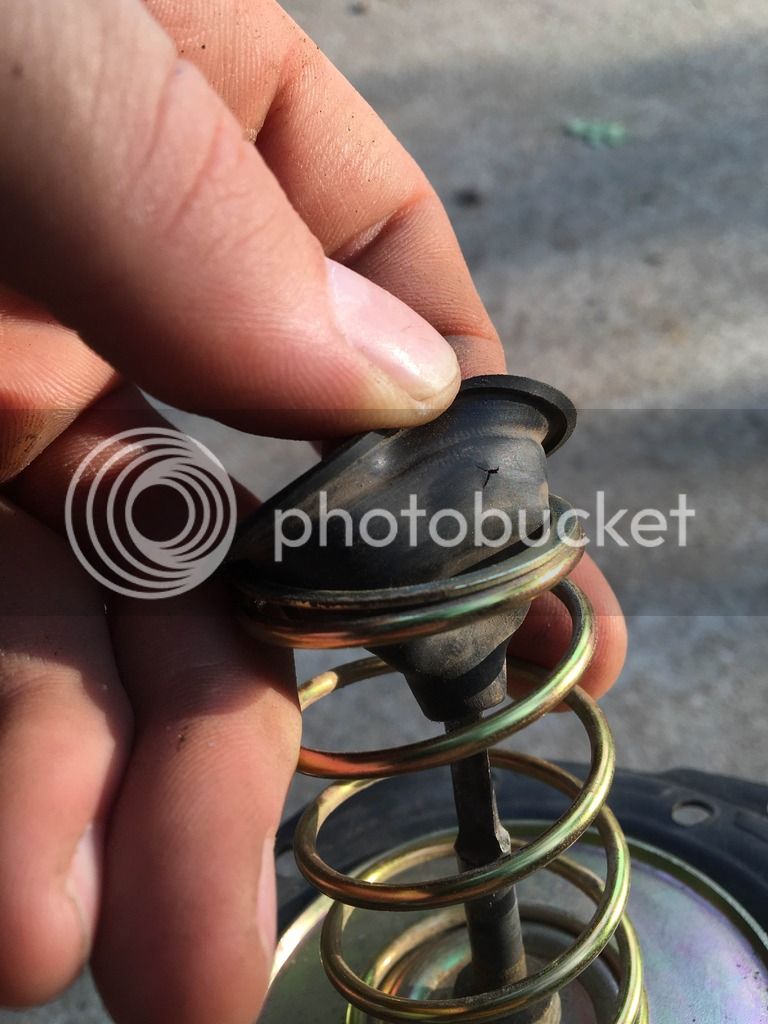

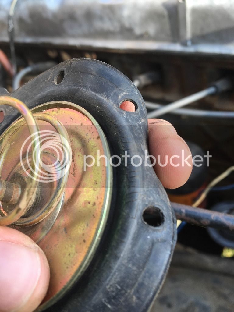

Here's the pics I got today...

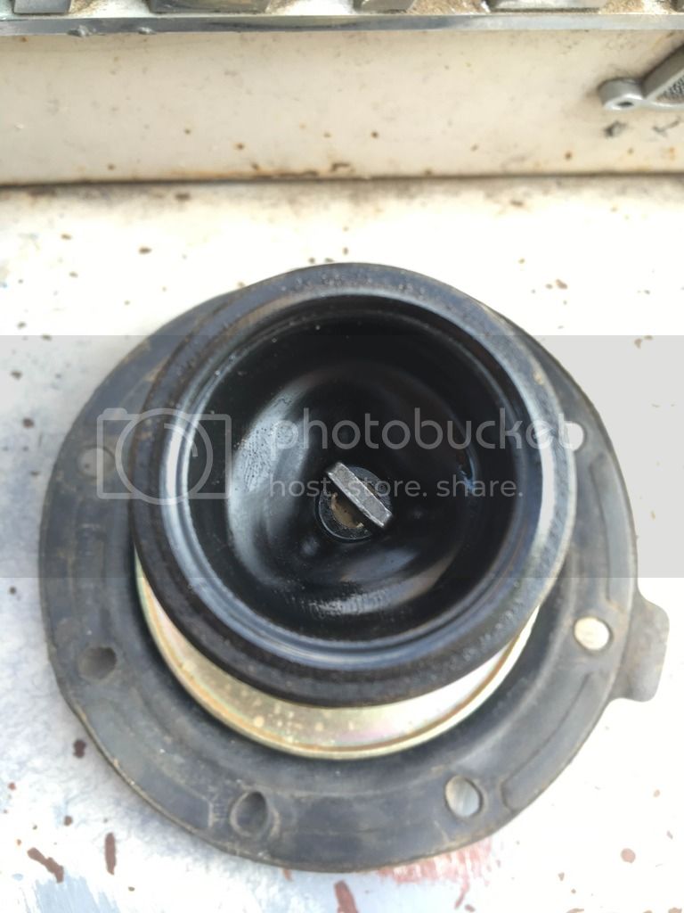

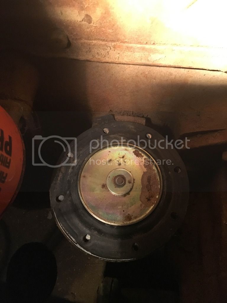

--------------------- Some close-ups of the Diaphragm and interior components ---------------------

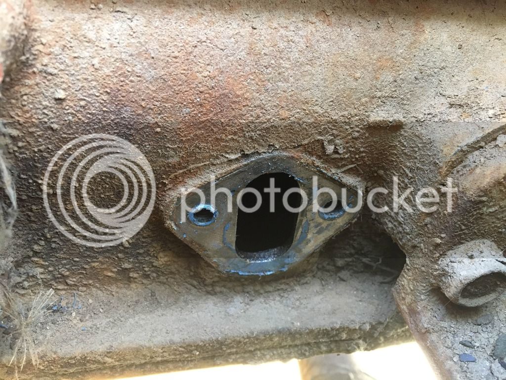

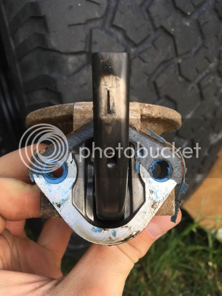

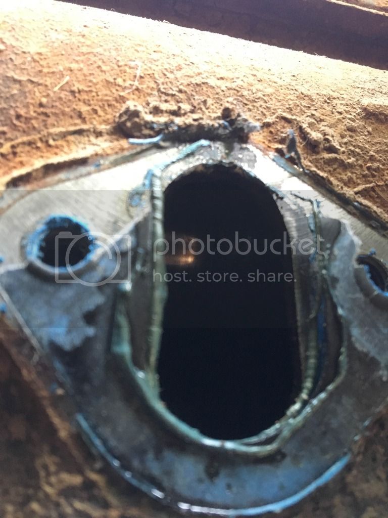

Here is the location where the pump connects to the block and I found that the gasket was totally falling apart...

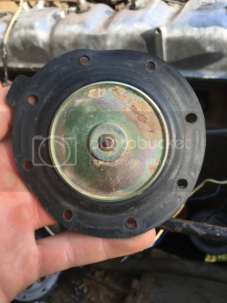

Right here you can see a bit of a tear in the diaphragm but it does not appear to go all the way through...?
This may be a bit anecdotal, but I tore down a good part of my engine after having my Cruiser for 8 years, and the PO had never installed the gasket between the pump and block. So just based on that, I'd be surprised if that was your culprit. Or maybe I was just lucky! The rest of your pump looks pretty much like mine did when I pulled it apart, less that small crack, and mine operates just fine. Maybe your problem lies somewhere else?
Yeah that's kinda what I'm thinking too because I don't believe there is any way fuel could be leaking through that gasket at the block. It seems the only point at which fuel can actually leak through is at the diaphragm, and in my case things are looking pretty good there aside from some minor wear. I have mixed feelings about the issue though, seeing that I cannot find a fuel pump rebuild kit anywhere, which won't be a problem if I end up not needing it, but then that means the problem is probably something a little more serious or expensive to fix...hopefully not. :confused:

Also, that pump doesn't need a spacer. The newer kyosan pumps often found on FJ60s and sometimes used as aftermarket replacement DO need a spacer. It isn't a gasket between the dry side of the pump and the block/cam/oil sump so if the pump gasket fails your oil gets all gassy and, obviously, that's not good.
Not on a 2F but I have had a partially sunk carburetor float fill the crankcase on my tractor full of fuel. it was running ok but after letting it sit for a couple months it was a bomb waiting to go off.
Ok so no spacer, but I do need to replace that gasket...right?
I think you're onto something in regards to the carb. I have rebuilt the carb, reset the float bowl level, and I believe I even replaced the needle valve, but that's not to say I didn't make any mistakes! I will definitely be looking at that next. Do you think the idle mix set screws could have anything to do with it? I don't know if I have those set just right either.
I'd replace the gasket, but that's just me. Mr. Toyoda put it there for a reason.
