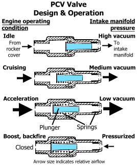

Positive crankcase ventilation. Basically there is a vacuum source at the intake and a hose going to a check valve then into the crankcase. The vacuum from the intake draws air from the crankcase through the combustion chambers to burn. This process evacuates hydro carbon buildups
from gas that leaks past the rings into the crankcase. Hydrocarbons break down engine oil. On the Cruiser, many times the vacuum hose is located directly below the carb. It passes over the back of the valve cover to the pcv valve which goes sits atop a steel elbow coming from the back of the pushrod cover on the passenger side of engine

typical pcv valve operation

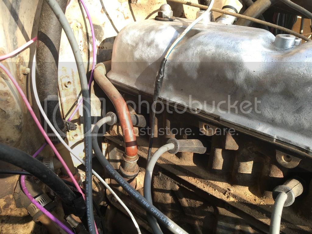

I also believe that I have found my PCV Circuit, here are some pics. This is the elbow on the passenger side.

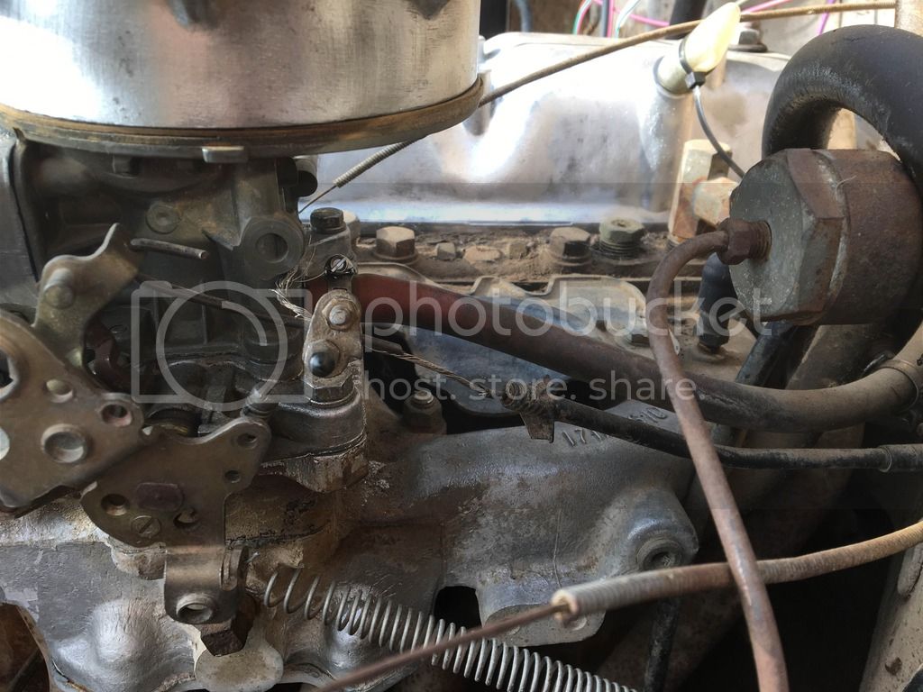

Here's the connection point at the carb.

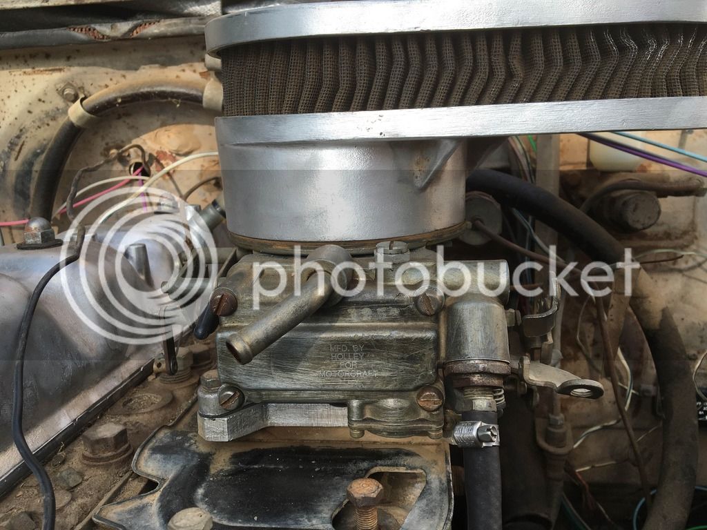

Lastly I snapped a shot of the carb overflow tube (forgot the term for it) that's pictured in the center there, where I'm assuming I would set up a return line and an adjustable pressure regulator that would dump unused fuel back into the tank...?
I found a Holley Adjustable Fuel Pressure Regulator that I think might work for my 2 Barrel Holley Carb, but I don't think it comes with a return line, but I should be able to use any ol fuel hose and route it back to the tank from the regulator right?
Well I'll go ahead and correct myself, just watched a video on installing an AFPR and realized that if it has 1 port in and 2 ports out then then it hooks up with the fuel pump going in, and continues to the carb through one of the two out ports, and finally the last out port is the return port that runs back to the tank.
