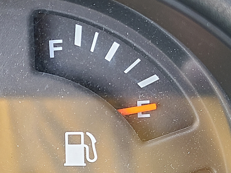

After work today I drained my (fortunately already low) tank and put 4.25 gallons in. With this, my gauge indicated just over the lower line:
So I went about adjusting the pot on my regulator, but unfortunately I'll have to find a different pot to use that can be adjusted to an even lower resistance. As it was, with the pot at its lowest setting, my needle still sat lower than where it started. But it's still a ways above being bottomed out. Given that, I'll run it as it sits now while I investigate and order a different pot. I'm curious to see where the needle sits when I top off my tank, and where the temp gauge will sit with a hot engine (especially during a long highway drive with the AC running. Above 90º Fahrenheit ambient is when my temp needle would creep into the red at highway speeds). Here's where my fuel gauge needle sits now with only 4.25 gallons in the tank:
Just for the sake of easy reference in this thread, this is where the needle sits when bottomed out:
It appears I need to polish the clear plastic of my gauges again....

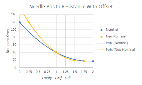

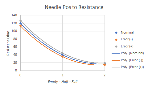

I went ahead and plotted The resistances in excel using the book data, This is probably not 100% correct but its what I had to use
Based off of my limited data, you want input signal to needle position plots to be near parallel to these lines, or within the two extremes.
This chart is assuming that 0 = Empty, 1 = Half Tank, 2 = Full.
Now say you to adjust where the needle points for full and empty. In my made up case we would want the needle above E in the white line more so we would assume a new empty position of 0.25 = Empty, The Half full region would be untouched so 1 = Half Tank still, But we also dont want the needle going past the F mark so we lower its position to 1.75 = Full.

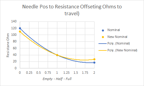

Any offset will change how the needle sweeps, I have aftermarket speed hut gauges and the fuel gauge is super annoying. For the first 200 miles the needle only falls to the halfway point, Then the other half of the gauge sweeps quickly for the last 60 miles, its unintuitive and annoying. I guess I could curve fit it and get fancy, but I really dont feel like it.
If we add a reserve amount of fuel and reassign the resistance values without changing the original needle travel position we still get a new curve
Some new curve fitting would have to be applied in your program to match the OEM curve, Maybe it doesnt deviate too much and is unnoticeable? Idk. just throwing this info out there. Hopefully its not all nonsence and im not way off topic.
I bet what Toyota did was plot the actual fuel level (gallons to % full) and curve matched that data with the float to the sender. I'm not sure if the data I'm throwing out is on par with what your doing or not. A controls or electrical engineer would be more helpful than I could ever be on this topic.

So it would appear that the voltage regulator is now too low, as my second gauge picture in post #4 is where it sat (after adjustment) with 4.25 gallons of fuel in the tank. here's where it sat after topping off the tank this evening:
