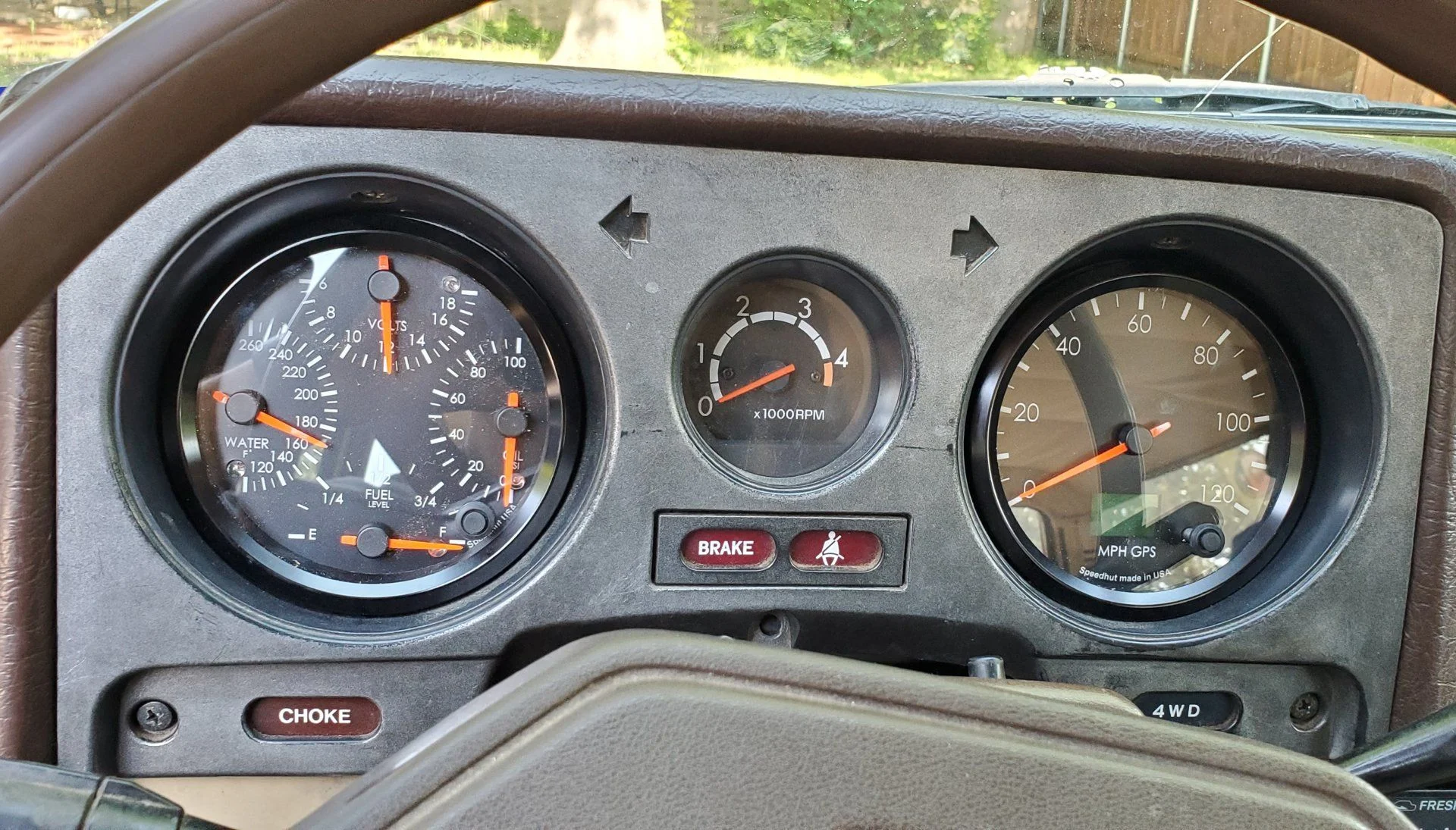

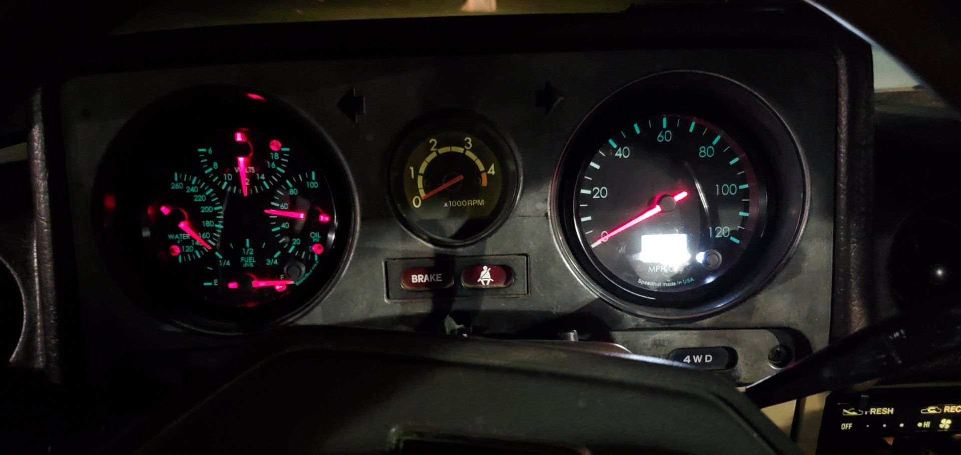

Just got these new guages by speedhut.com for my 1984 fj60 with a 2fe. I got the quad left and just a GPS speedo. I got them in the green color to try to match the original aesthetic but it dosent show well in the dark at all. Infact trying to see these guages with the backlight turned up all the way is still hard. The gps has a little digital screen on the bottom of it which is hard to read in the day time, and is way too bright at night and you cant control how bright its light output is or the needle light output which is mildly irritating. The gps speedo has a function where it records your vehicles maximum all time speed and its claiming that in my 1984 fj60 that I went 128mph which is grossly innacurate. It also glitched while i was driving where it would rest at 20mph when i was at a stand still and continued to read 20mph over the actual speed i was going, all I did to fix this was turn the car off and back on.
These were extremely easy to install and i do like the overall look of the guages and the accuracy that it can give. But for the $600 price tag I expected way less problems. This is only my 2nd day running them and i will write up a long term review later down the road.

Have you discussed this with Speedhut? I'd like to know what they say. I missed their special this year and now have a OEM oil pressure gauge to install to replace the non-functioning one. I'd still like to get a full set of Speedhut gauges one day, though.
Im going to contact them tommoro when theyre open. the thing that i really worry about is the innacurate speedometer, my house is sorrounded by schoolzones and motorcycle cops

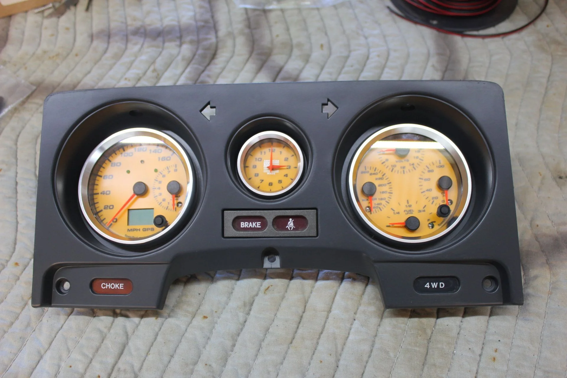

I had the red background on my last SpeedHut set and it was hard on the eyes. I agree with @lcwizard a lighter background is a better choice for these.
My new set that I'm about to order will be white or silver with black font and blue glow for night.

I wish they had a backlit system similar to the stock fj60 guages, it would be easy on the eyes and there would be no need for thos obnoxious lit up needles.

Ok so the backlight inverter went bad and I cant read my guages at night. The needles light up still.. apparently the backlight for the guages requires a DC to AC converter..
Reading about the dimmer/illumination issues you're having is discouraging for me. I'd like to add these in my 60, and was hoping to soon. I have a difficult time at night with light sensitivity. The LCD being full time bright would certainly bother me. I'd have chosen the dark background as well to keep the classic look. Follow up here please if you, or they get the issues sorted.
Where did you hook up the 12 volt for the inverter box? I had to move mine around a few times til I got a really solid connection for it—it was a little bit temperamental (I think I ended up on the green/white wire). But the first few times it would kick on and off.
Of course it could just be burned out—that little box doesn’t feel as stout as the rest of the gauge hardware.
