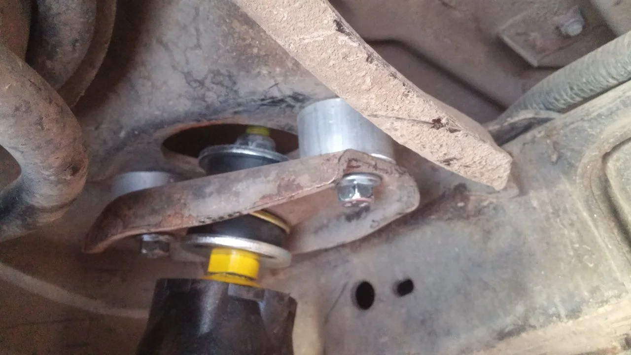

In my quest for more travel and keeping my tires in the dirt as much as possible in crawling situations, I've FINALLY installed my LandcruiserPhil front sway bar disconnects.
disco-jpg.1230072
I also removed my OME N74 shocks and installed the longer OME Nitrocharger sport "L" shocks with the LCP rear shock mount drop - this gives me 3" more droop in the rear. All were easy to install and came with clear instructions.
