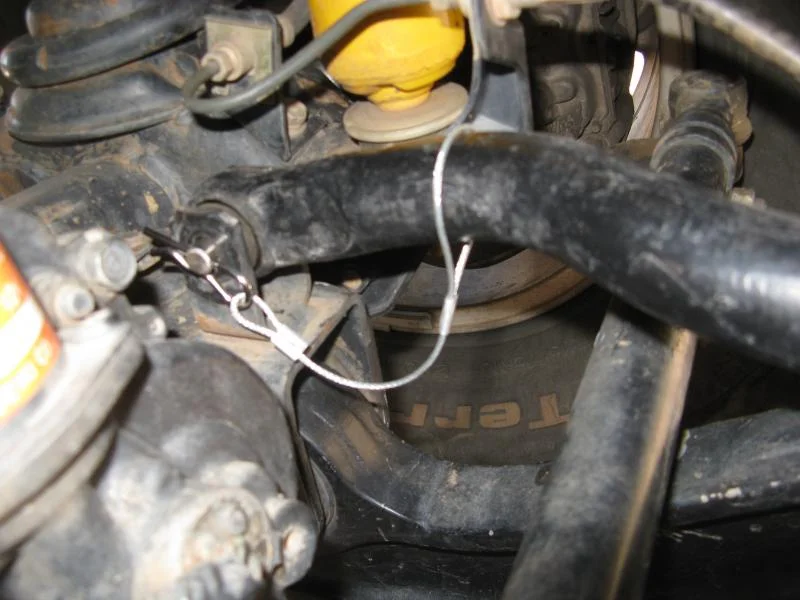

Phil this is pretty cool, good job. Could you post up pics of the links attached to the axle?
The first picture is the passengers side, earlier 80 series dont have a brake bracket like later 80 series. This gives you the option of using the same style clip used on the drivers side(2nd picture) on both sides. Ea

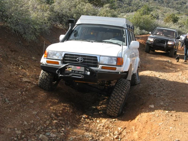

In the Copperstate Cruisers trail run yesterday, one of the members (Gummybob) disconnected his set of these swaybar disconnect kits and after several trail challenges remarked that he felt these gave him more flex. I watched him disconnect these very quickly - Im installing mine next week.

More real world testing - Ran a trail connected and a few days later the same trail disconnected.
Much smoother through the ruff stuff and definitely more tire contact and less tire slippage with diffs unlocked. You get more movement with weight transfer but with the added traction you can go much slower in difficult terrain:cool: Overall a better ride at the end of the day.

An increase of ~15%.:clap:
On the trail I noticed the front end articulating easier and smoother, another plus.
