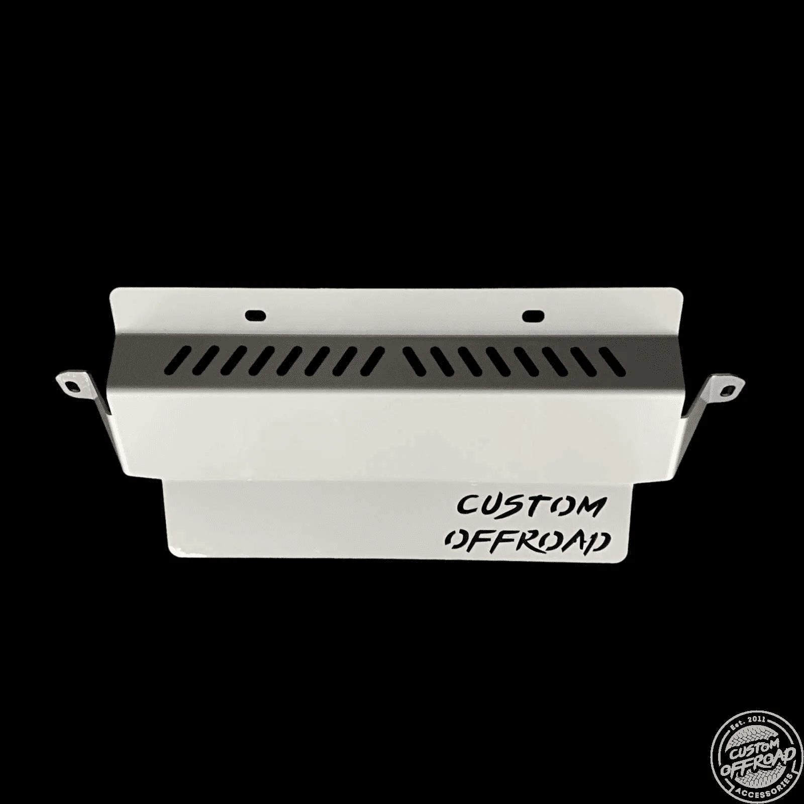

The plastic sort let you down . We call them bash plates and there are about 7-8 to choose from for a 75 series in Australia. They can save you a lot of money.

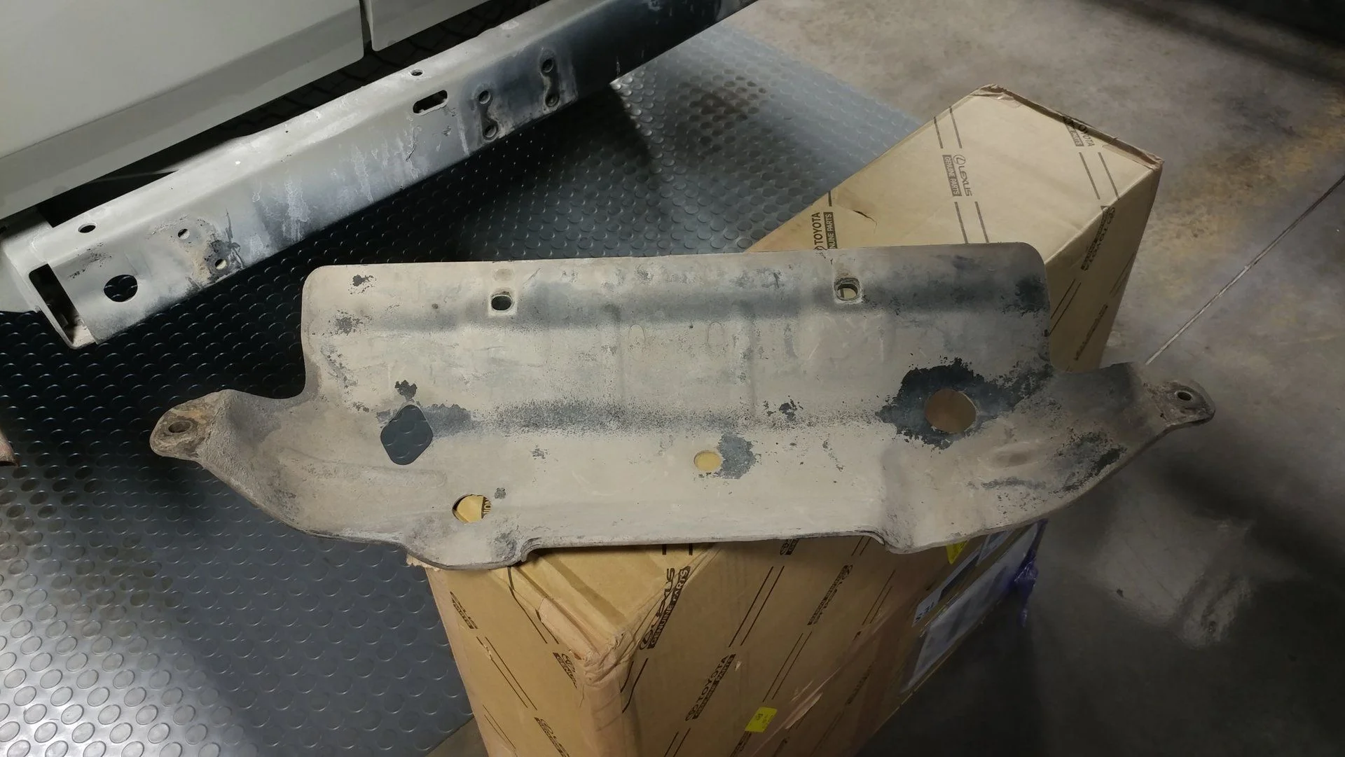

It just so happens we have the one off our Troopy right now....92. Hope it helps.

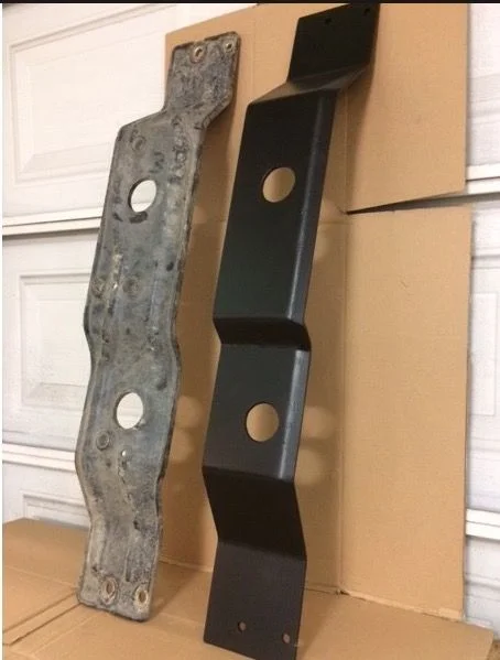

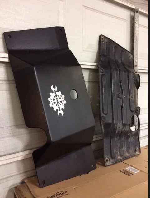

I have mine from 1985. Happy to send them to you Joel if you can use them to mock something up, or mimic them with different materials.
I’d just want them back at some point. :)
You're speaking in plural... you have all three pieces? I may yet take you up on this... let me get under there with cardboard and see if I can do some figuring.
I've emailed this bloke... let's see what he says about international shipping. Some killer stuff on his site.
A big help, thank you! That confirms that the newer piece will likely work just as well.

Did he make templates for that? Can he reproduce them? What about the front most piece... that protects the radiator. Did he make that in metal as well?
P.M. Sent
Let me know if you order from Custom Off Road. I'm interested in a bash plate and we could split the shipping from Aus.
I would be in for an order too. Maybe we can coordinate a group buy. I bet there's a few other people that would be interested.
That looks very simple. I can likely have my son CAD up something and have it plasma cut out and bent. I am thinking 3/16 aluminum.
The ones from AUS are 4mm stainless.
