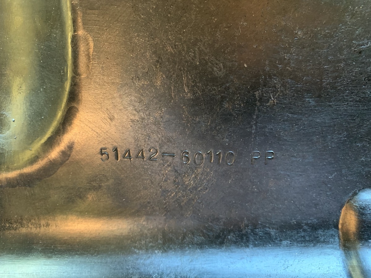

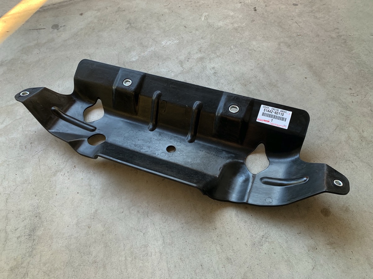

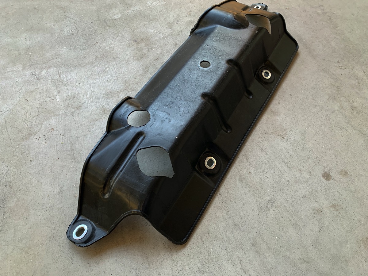

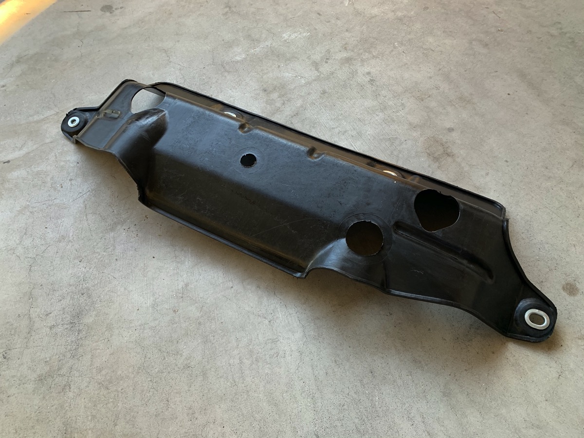

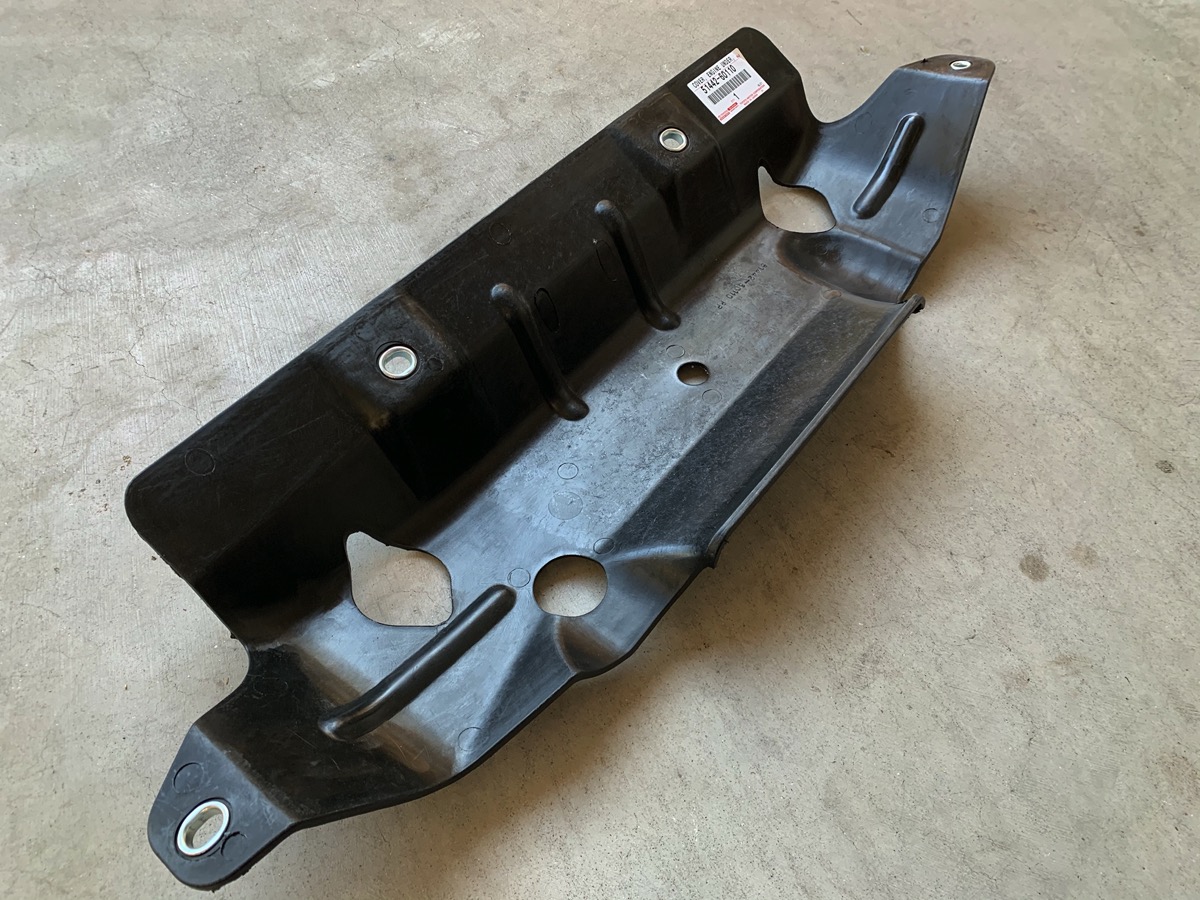

I was placing an order for the front inner fender well skirts that cover the gap between the chassis and the inner fenders so figured I'd pick up the newer splash guard part I found. Here's some photos...
This actually worked on my truck. And so far it's doing the job of reducing splash up into the engine bay. But I'd still like to see something metal in there. Will keep everyone posted on Custom Offroad and a group buy.
Does anyone have pics of these plastic pieces mounted in their original locations? I think I know where the skinny one goes... but no clue on the bigger one.
Those OEM pieces look like metal to me. I think the skinny one goes under the transmission/transfer case but I'm not in country so I can't look to verify.
