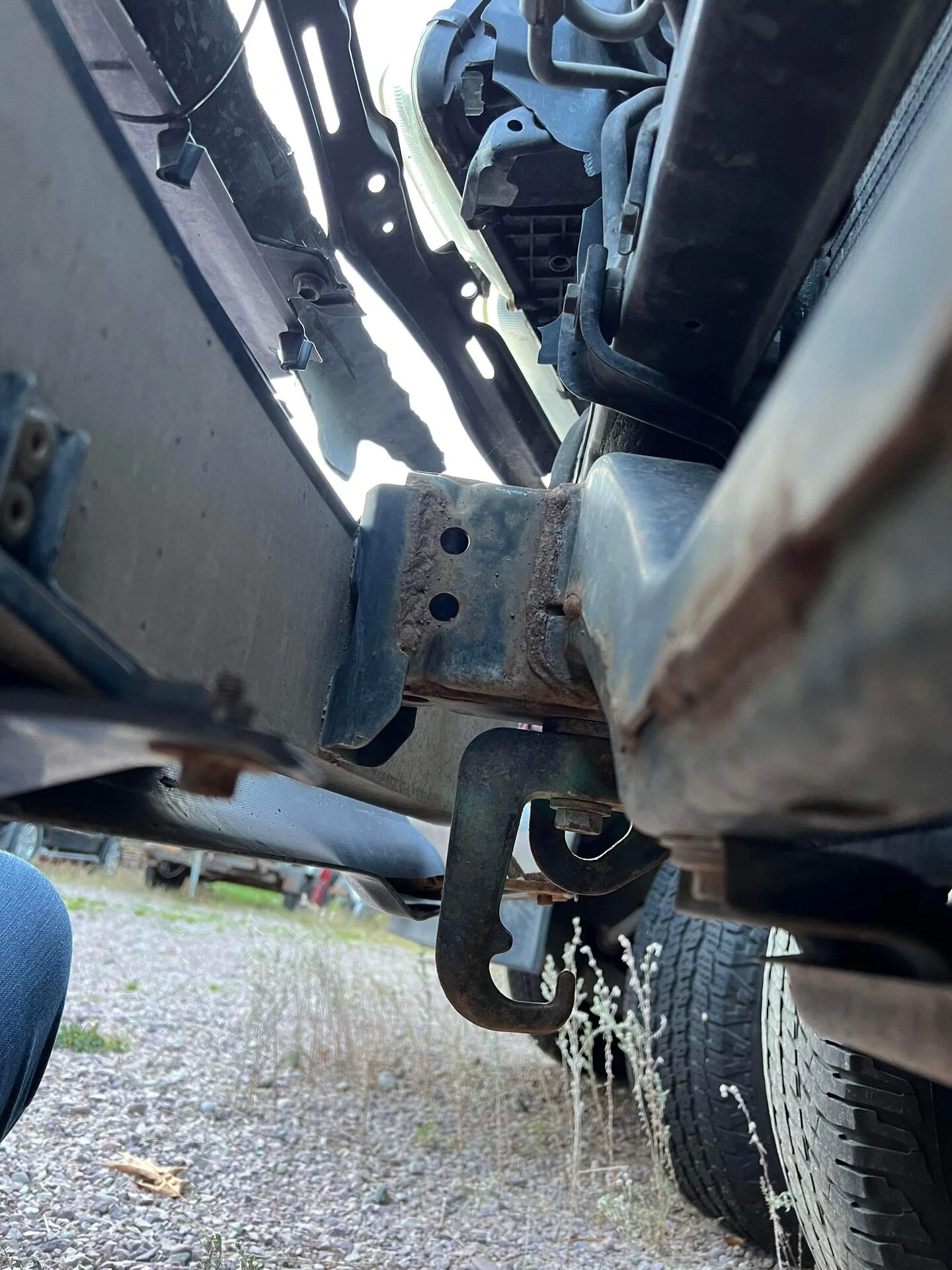

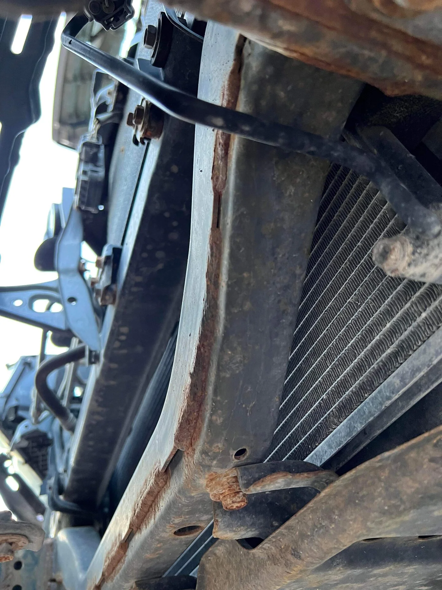

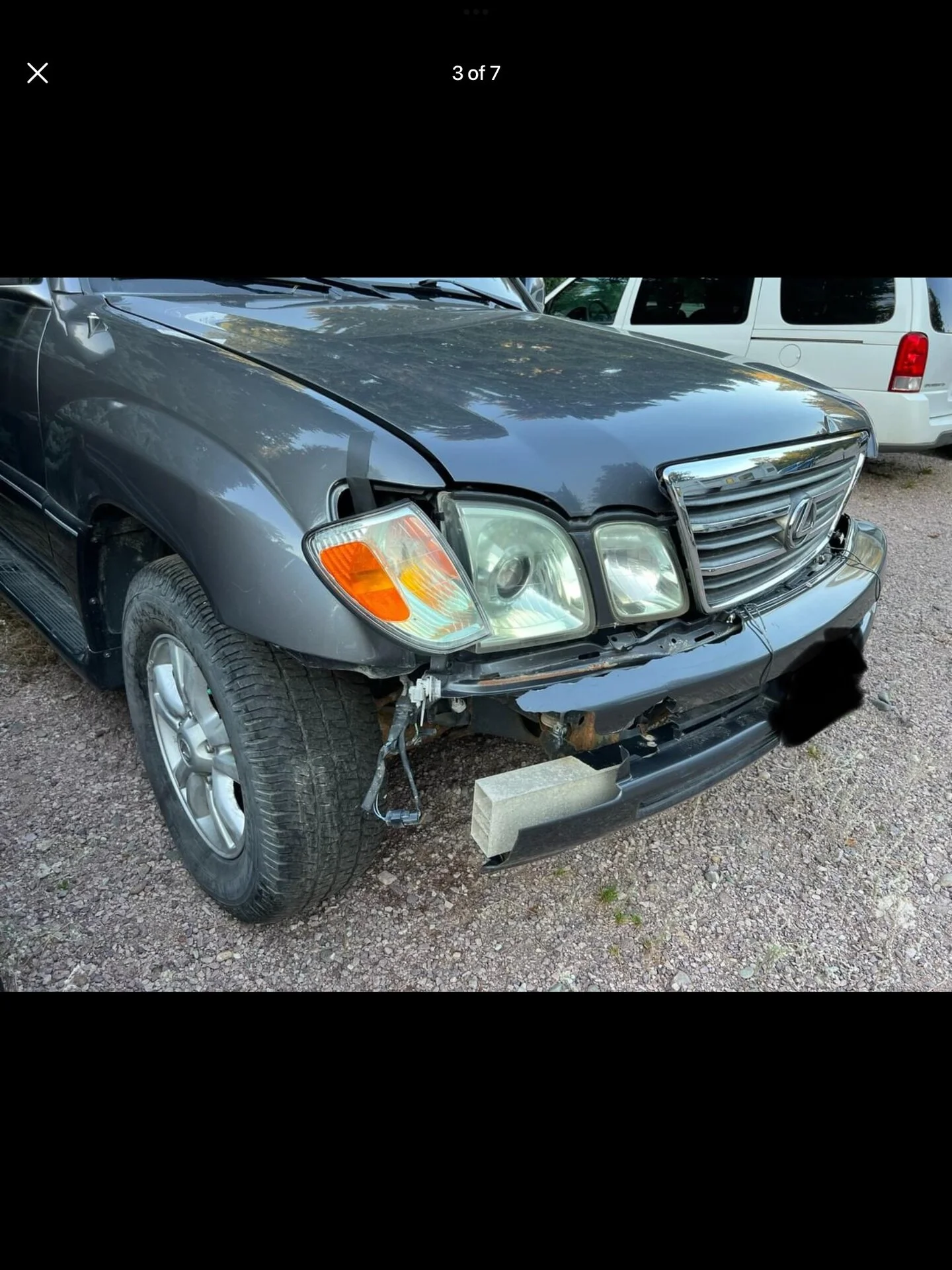

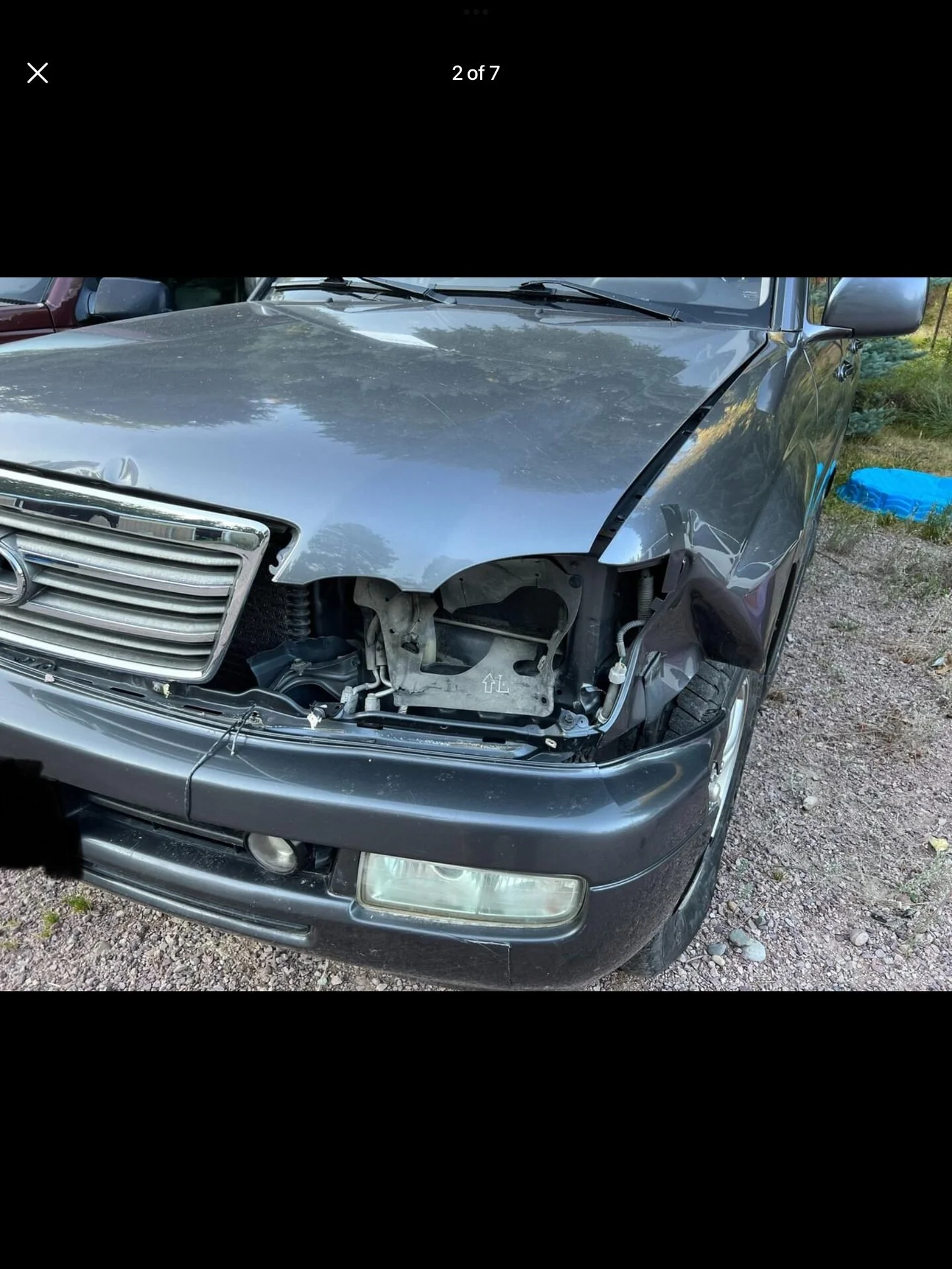

I’m looking at this as a potential purchase, seller has been pretty open about everything, it was in this accident last year, declared total loss, then bought at auction by current seller.
Runs and drives, no airbag deployed. Has around 170k.
Doesn’t appear to be any frame damage, I would replace the bumper with a ARB or similar and getting a fender, lights etc. I don’t know how difficult the bent AC lines are to replace? the previous owner apparently got rid of the rear ac per a sticker on engine, and I’ve got kids and dogs so would have to figure that out in the future. I’m waiting on under carriage pics.
They said no damage to condenser.
Not sure on recent maintenance, had regular maintenance per the car fax though till last year, but it doesn’t specify what. I don’t care about the salvage title.
Thoughts on asking price and how much work this would take? I would do most of the work but not looking for a huge project.

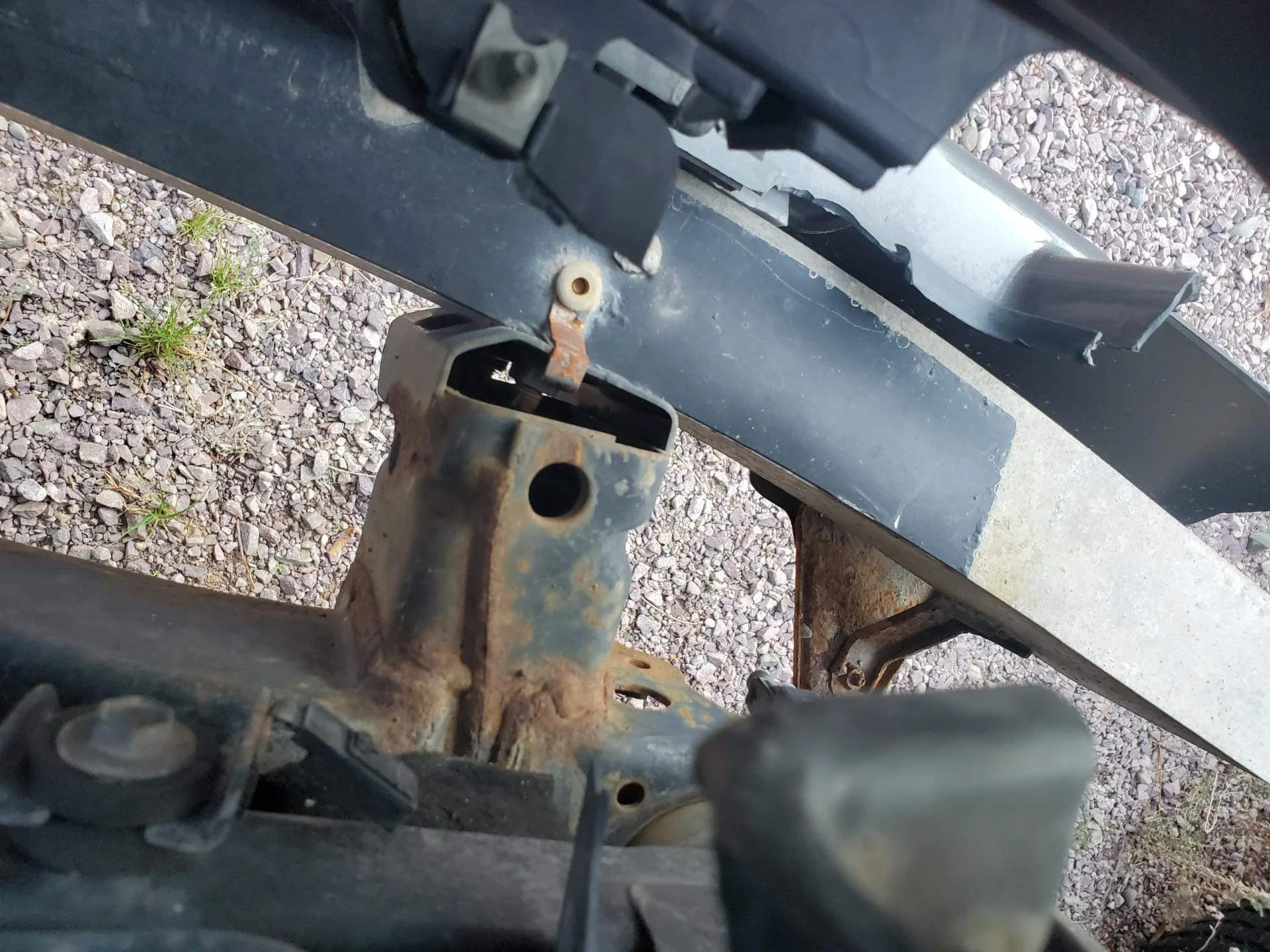

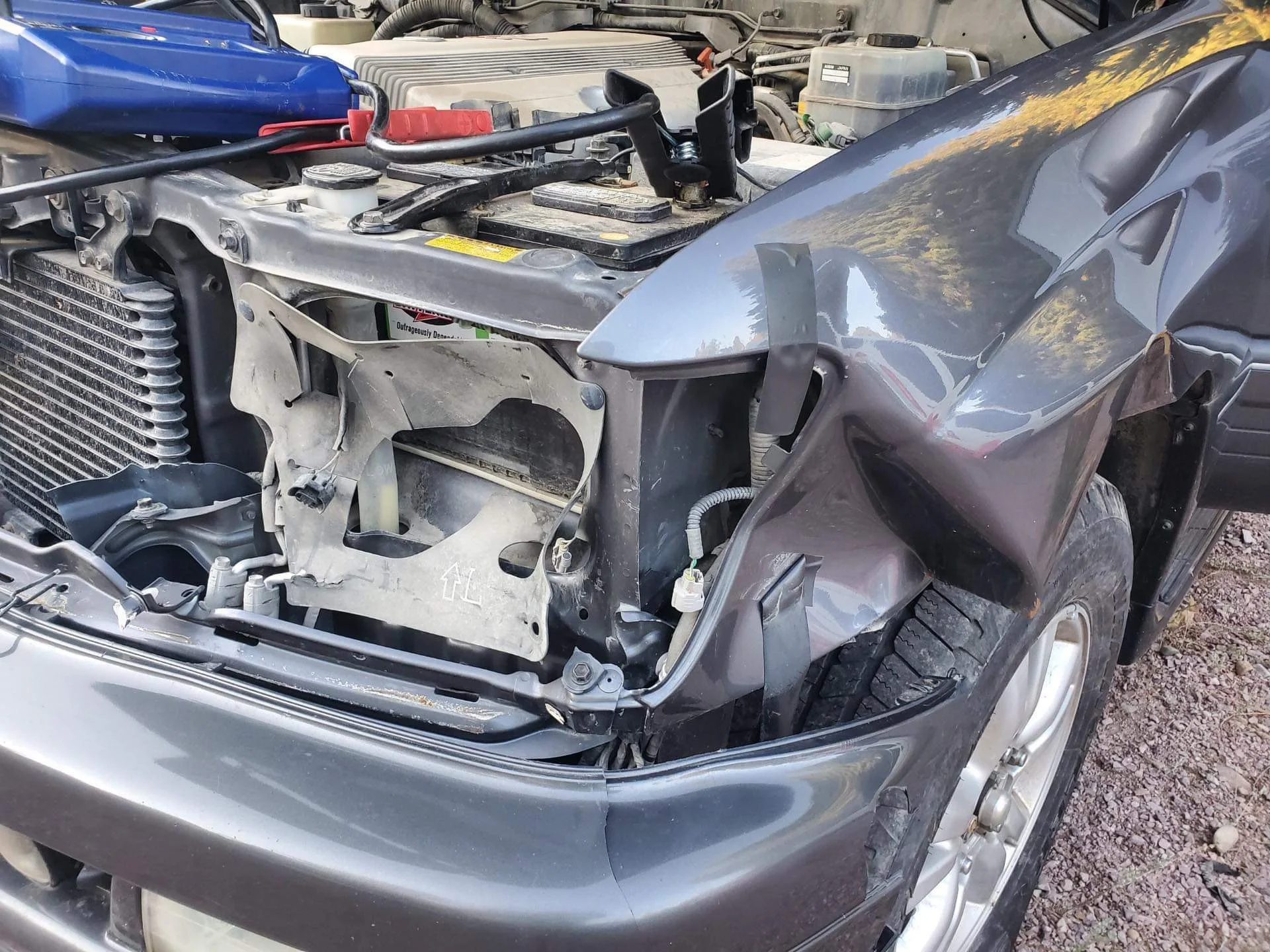

A couple more
Honestly, this seems like a pretty big project to take on. You have body work, AC work (both from the accident and the rear system leak), and whatever maintenance is due. The rear AC leak is common and can be a bear to correct. Honestly this would have to be a pretty smoking deal to make it worth the chance, like sub $4k IMO.

just from experience, you may also need: hood, passenger headlight assembly, both corner lights, grill, the trim pieces around the headlights, the bar across the bottom of the headlights plus the brackets, washer resevoir, driver inner fender will need some massaging, those a/c lines are all kinked

Don't run away. But don't overpay. 100 series go for a lot at auction because the middle eastern countries buy them up and they're willing to pay a lot. So it's hard to get a deal on one at auction. I rebuild wrecked cars on the side so I watch a lot of auctions. . I bought an '06 100 a couple months ago that I'm still working on slowly here and there when I have time.
1) That rust doesn't scare me. It's surface rust on a thick frame. That's normal to those of us that live in the top half of the US. Southern guys don't understand and I'm jealous of them. But obviously check the vehicle over in person and check the problem areas of the body.
2) The damage in those pictures doesn't scare me. I don't see any rad support damage but I would be prepared for doing a little pulling somehow. I've found that fenders are around $625 shipped and you might get that down by ordering multiple panels that get shipped freight.
I'm going off of reflections but I think both fenders have damage. Price it out as if you have to replace both. If you don't, good. Hood looks trashed towards the back. You'll need hood hinges as well. Headlights, grill, and misc. pieces. It adds up quick. Pretty easy to have $1,000 in paint w/o labor.
Doing some really rough math I would say roughly $5,000 in parts and paint. Yes you might be able to get that down... but it can go up pretty quickly too (there is ALWAYS hidden damage) so don't underestimate it. If I paint fenders I blend into the doors which is more work.
Sooo... now you can do some math and figure out what you would give for it after you inspect it in person. You said you don't want a big project, that absolutely is light damage but it's a big project.
