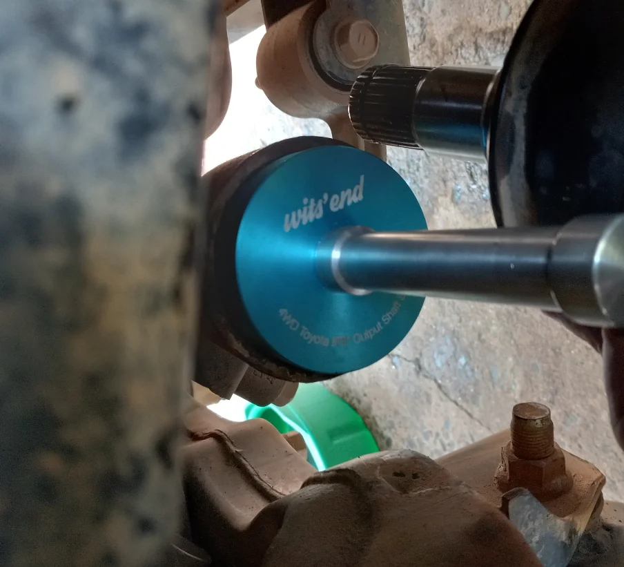

I just used the tool. I put the seal in the freezer with a thin film of red grease around the outer edge so the seal would not pinch or tear during installation.
It very easy to install. I just pushed it into position with my hand. The tool is flush with the axle tube.
It feels like a uniform depth when I run my finger around the inside.
Leaky seal fixed.

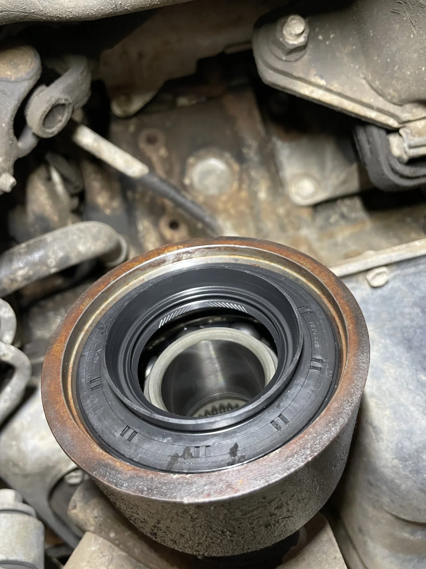

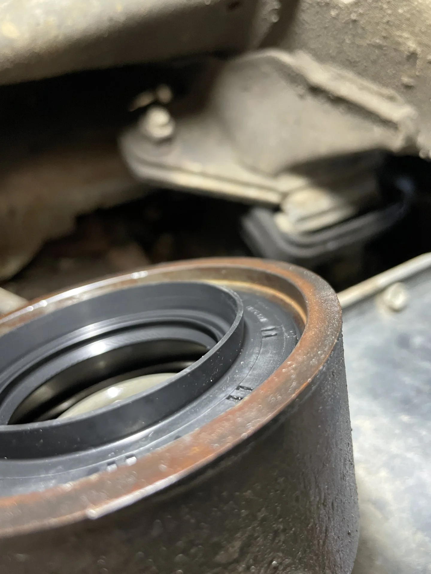

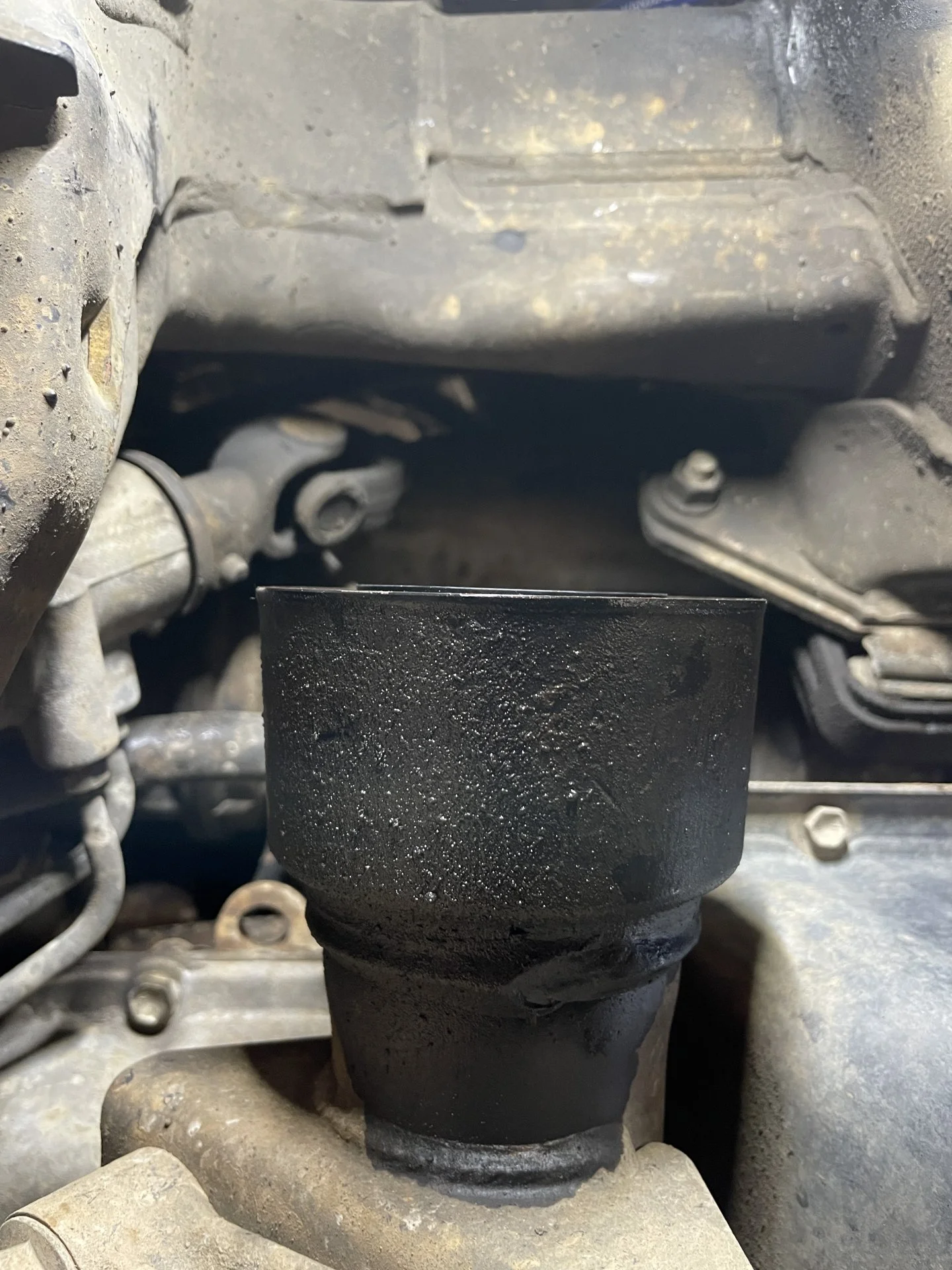

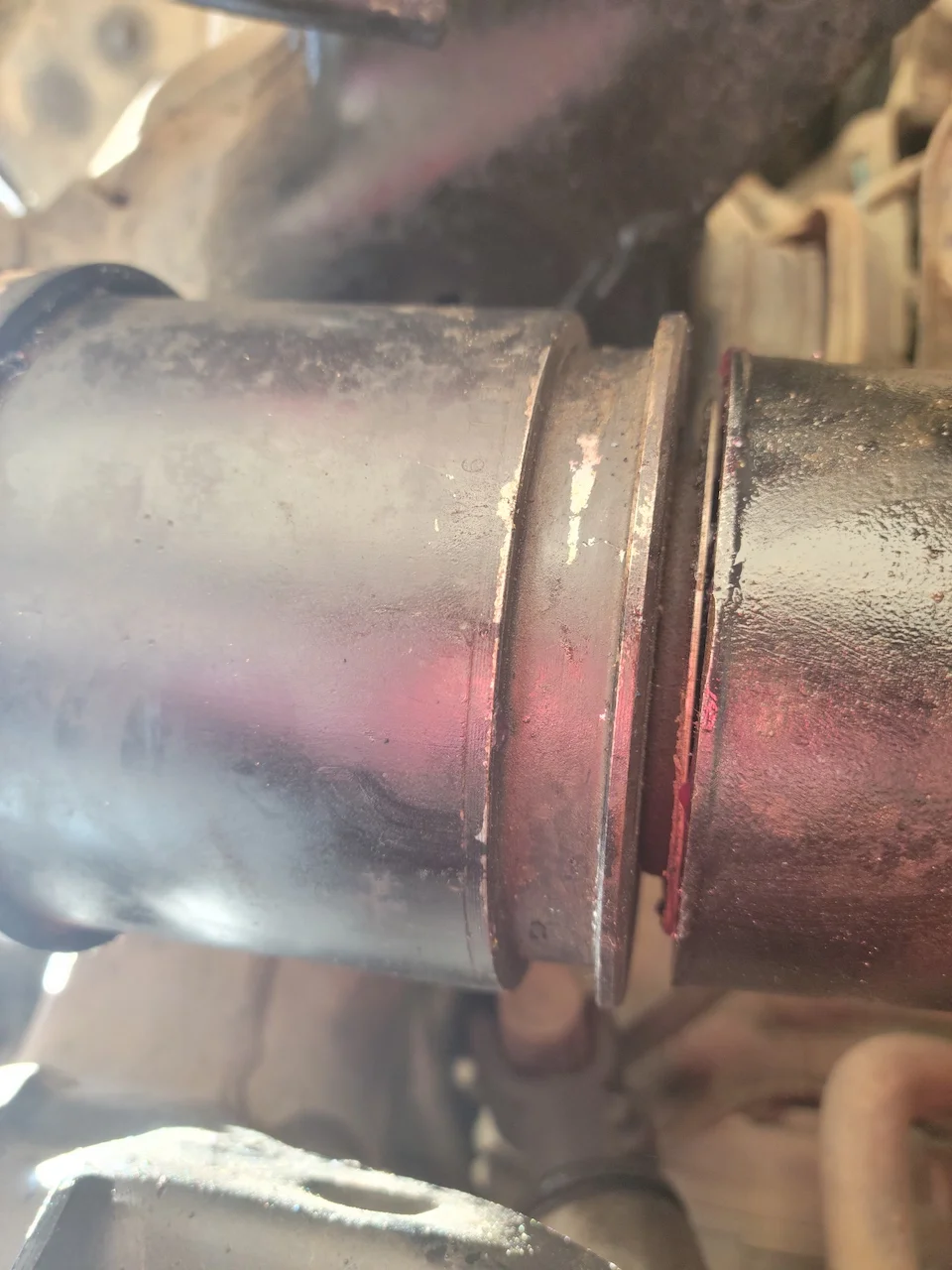

Just completed this seal replacement. But I am not sure that I have the axle set in deep enough into the housing.
After I installed the new seal.
Before I removed the axle and installed the new seal.

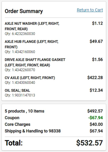

Thanks for the reply Paul. Lots of Toyota dealers were having a sale for the weekend with 10% off plus free shipping so I bit the bullet and got a new axle + parts...
Price seemed pretty good and I didn't want to have to potentially buy at a future date when no sale plus prices are higher plus supply chain issues...
On a side note, they all come with core charges now, but my local dealer wouldn't take the last one I bought because the invoice didn't have a special part number indicating I paid a core charge. What is everyone else doing to get the core charge back?
When dealing with shipping more than core $. Eat the core charge or buy local.
BTW: Nearly every FDS I've had shipped in (last was 2019), dust seal was bent in shipping. They can be straighten, just takes time. Due to that, shipping cost and core charge. I only buy locally for last 2 yrs. Which they never have damaged dust seal, nor core $, nor shipping $, just tax.
I passed on a great deal, the week before X-mas. Because core charge vs cost to ship back.

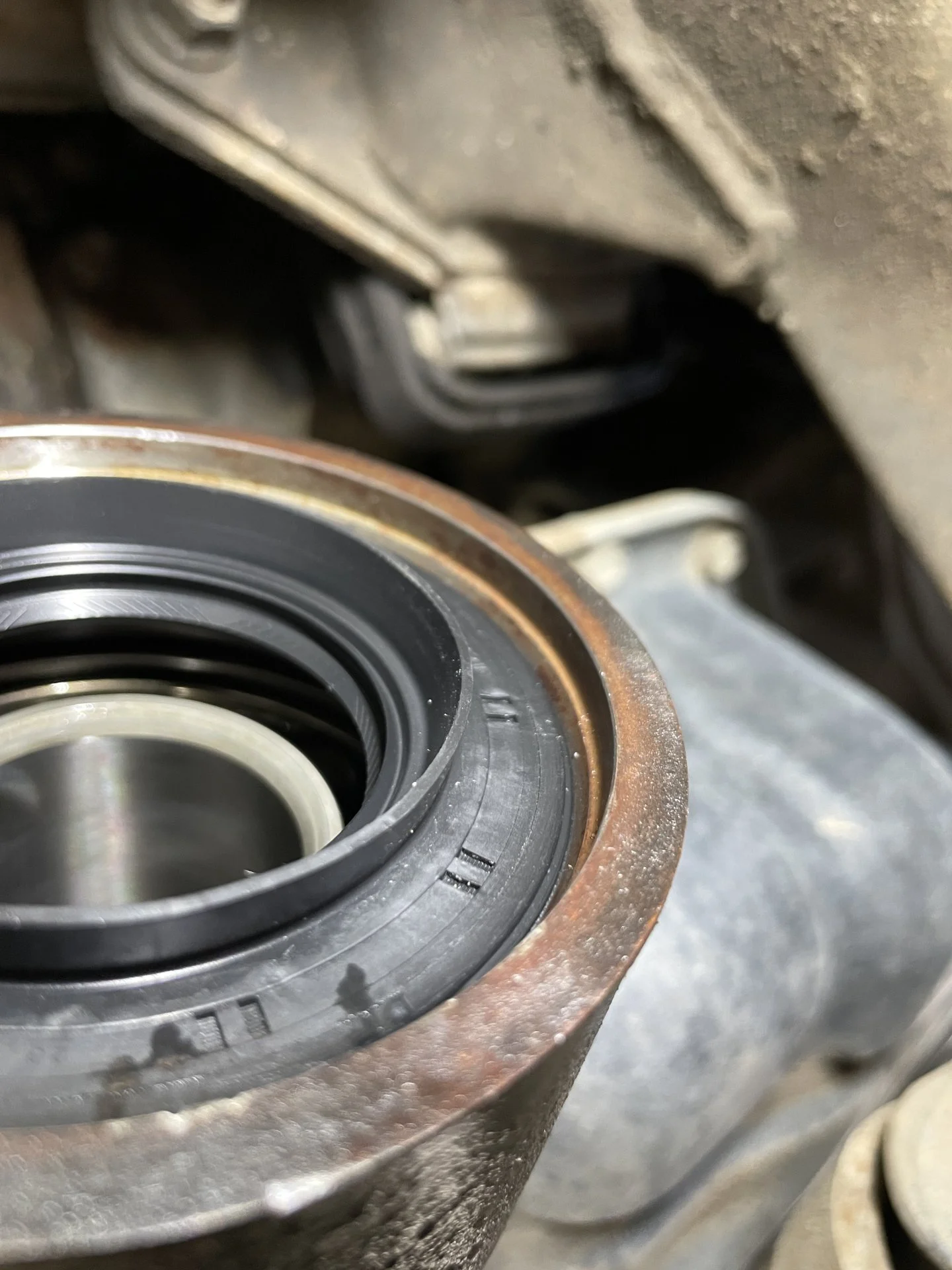

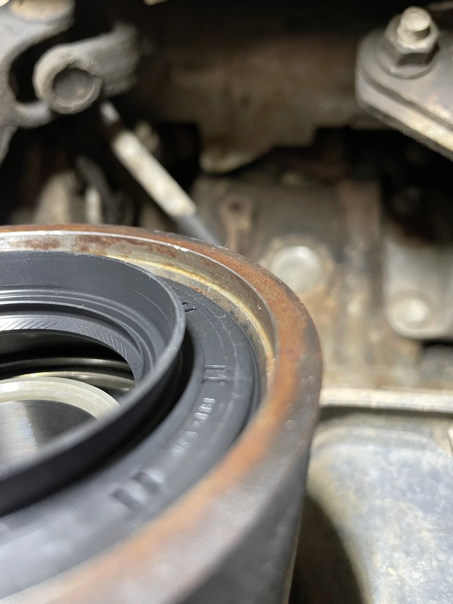

So what are the odds that this DOESN'T leak??? I have another seal on hand that I could install if need be? I feel like there is a little more wiggle room on seal depth, but not sure? @2001LC responded to another post saying the seal would be fine slightly deep or slightly shallow....Thanks!
Should be good. Pretty darn close to perfect. The leaks come when you drive the seal too deep.
It’s a little low- but I think where others have experienced leaks is when it’s not evenly set( higher on one side) or used non-OEM.
