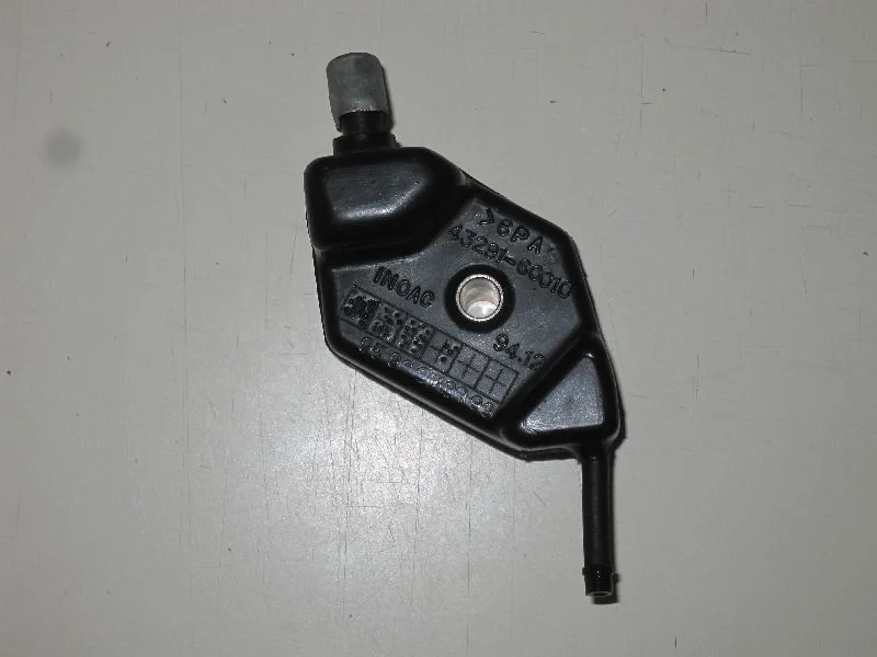

My breathers are all tied together with fuel hose to the OEM vent breather gadget bolted to the drivers side fender, under hood.
Tested today - all good. Slow but easy air flow in both directions on both front and rear differentials (long 1/4" tube). The little cap on top pulls down under suction, but does not seal, so air still flows inward too.
