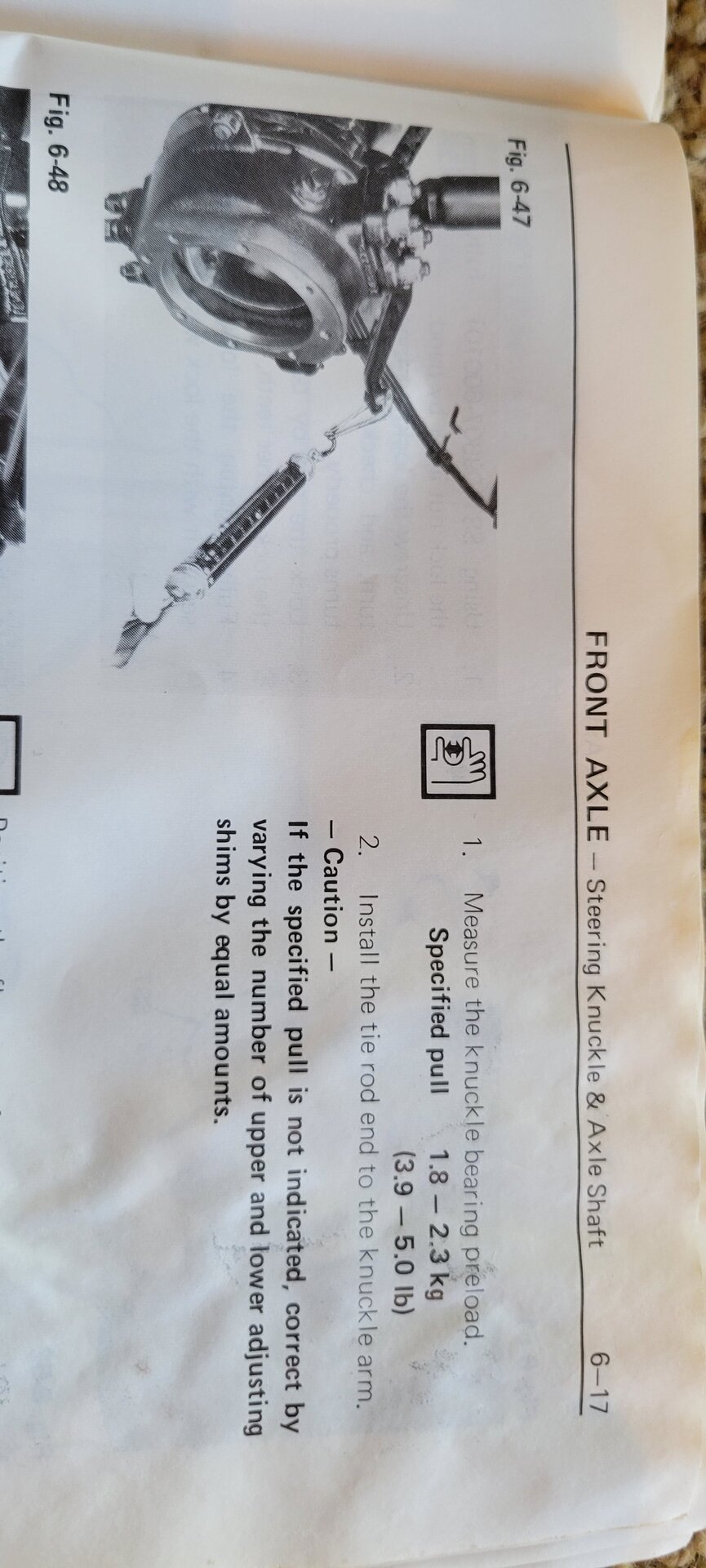

For sure. Get that preload right for both sets of bearings. Taking stuff apart is not fun.
I mean trunion and wheel bearing preload

Don't forget to keep your shims in the same order as well.
Yeah. Definitely bag them and mark the bags DS - top, DS - bottom etc…

I guess my problem is he's just pulling shims from the bottom cap to adjust preload.
Yeah, while in no means as accurate as using a proper centering tool, it’s essentially what the FSM (which can be way too vague) says. It’s certainly a sloppy way to do it.
Not arguing with you at all, I accidentally threw away the top set of shims on my first knuckle I ever did (didn’t bag and label properly), I ended up doing what he did based on the manual to get the proper preload. When I finally got a centering tool it ended up being spot on.
Lucky and stupid can sometimes collide into success, but I try not to count on that.
