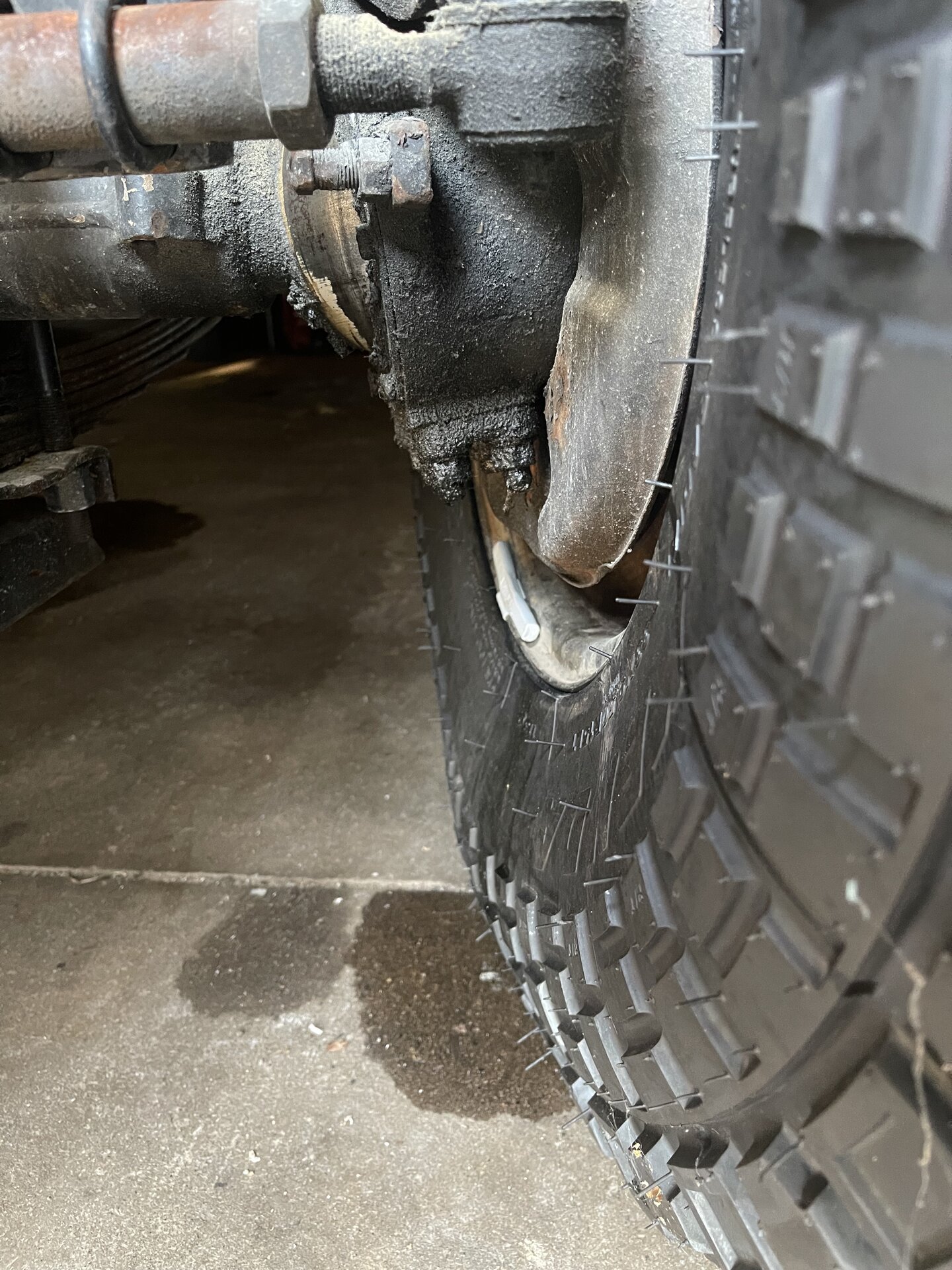

Pulling out the FJ40 this morning and noticed a leak at both front tires today - oil is dripping off the grease zirks. Haven't done much investigating, but pondering why both sides would start to leak at the same time and almost at the same rate. Do these symptoms indicate new axle seals are required? If so, any suggestions on what kit/vendor?
Trying to do a bit researching before getting into it!

Zerk fittings are one way valves. They can't leak unless they've failed. I'd try to clean those areas with degreaser and see what develops overnight. That'll tell you where you need to focus the repair effort.
Wash the areas good with brake clean - check every hour to see where the leak is coming from.
Great advice "The trick to success is making sure you're solving the right problem"
Goes well with, if it ain't broke don't fix it.
Those are not zerks - they are studs, covered with so much grunge you can't determine what they are. Anyway - you must check your front axle vent, as a clogged vent (and the crappy factory design) will pressurize the axle and cause leaks such as this.
What I have done (and there are other methods) is to simply pry off the floating axle vent cap (the part that wiggles) with a screwdriver, remove the spring and rubber disk, and slide on a 3' section of 3/8" fuel line over the remaining nipple that projects from the axle. Clamp it with an appropriate hose clamp, and run the hose well up high into the engine compartment where it's not exposed to wheel splash. Push a fuel filter into the end of the hose, if you like.
The reason the factory design is poor is that the rubber disk gets coated with gear oil, and then effectively glues itself to the vent, and the axle can no longer breathe properly. This can cause pinion seal leaks, too.
After all this, wipe down the entire knuckle area with a cloth and then watch for leaks. Your birfield cavities may now be full of birfield soup, and the knuckles will simply weep oil until you completely repack the front axle.
Get a front axle manual ($OR sells one) and read up on the entire axle.
Completely reseal the whole axle. A great learning experience and when finished, will last another long period.
