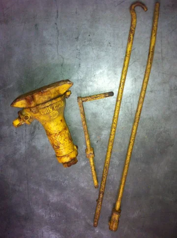

I would go yellow on the jack rods

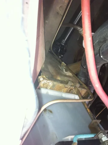

I've been working on finishing up the brake and clutch lines today. Anybody have a photo of how the the brake line runs from the master cylinder to the first splitter? I'd also like to see how the line runs on the right side as it goes around the battery tray and shock tower.

Hahaha. Nice collection! Those from early rigs?
The third one from the bottom is the Fj25 rod. hdjtachtig's pic confirms they were yellow. You should add that pic to the jack thread!
https://forum.ih8mud.com/40-55-series-tech/741059-fj-series-oem-jack-reference.html
