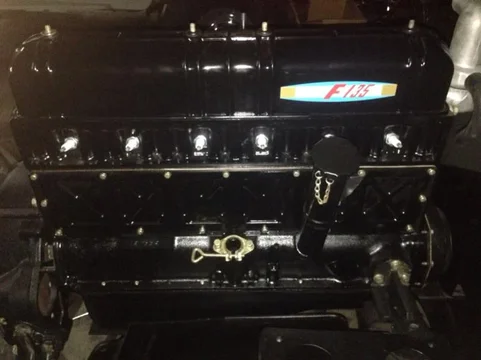

I've been working on this more than the 1962 lately, so I got a little side-tracked. It's going in the 1981. image-871173885.webp But, I did finish the engine and installed it the other light. I also installed the trans and t-case. Sorry for the crappy phone pics. I'll take some with the good camera one of these days. Also pardon the mess in the garage. It's a compelte s***-hole with all these projects going on!
