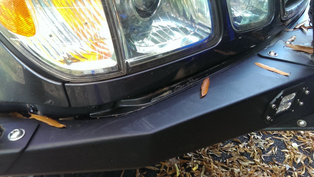

One minor issue I had was with my dissent front bumper. This happened on my previous trip but I thought I fixed it when I installed my winch and realigned the bumper. When I mounted the bumper I had it installed over the front 'lip' and it was even on both sides. After wheeling the passenger side popped down over the lip. I had tried to use the spacers to lower both sides below the lip but that did not work. Not sure if I should just cut some of the lip off or get the brackets made for the body lift - I thought I could get away without new brackets since I only went with 0.5" BL.
I cut my lip off. Not because I had to for clearance, but because I know I will be running a BL at some point. I was going to paint it black anyway (the gap was really noticible on my white LX).
You will either need to cut the lip off or get some 1" body lift brackets and extra shims to accommodate the 1/2" body lift. If you decide to cut the lip you can actually slide the bumper back a little and get a tighter fit but you would need to drill the frame holes bigger. You could also slide the bumper forward some to clear the lip but that would give a pretty big gap, this would also require the holes to be enlarged. Also check and make sure the body mount bolts are good and tight after the body lift install.

@CreeperSleeper or @benc what exactly did you cut off. I can probably figure it out once I get the bumper off but wouldn't mind seeing some pictures before I take an air saw to it. Thanks
Did you cut here?
Or further up to get the whole lip off? Is it possible to just drill the rivets and take the whole piece off?

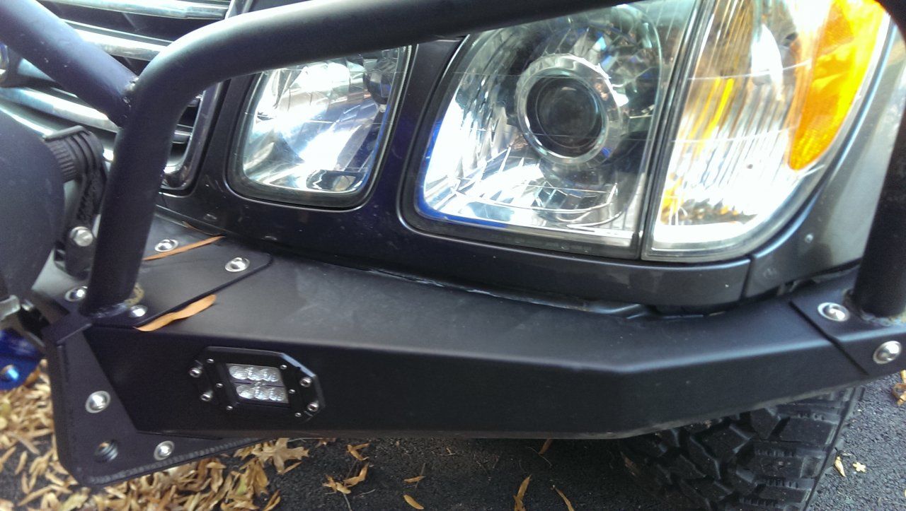

So I ended up hacking a bit more than I initially planned. Looking at where the bumper was rubbing I was afraid I would still hit the lip if I just cut where I had drawn the red line. This may have been a bit excessive but I think I can re-adjust the bumper to go up and back (per Benc) a bit more which will look better - just need to open up my mounting holes a bit more. I was pressed for time so I didn't take the bumper completely off.
Pre cut you can see where the bumper was in contact
Post cut
Few notes on the trimming. I used a combination of an air cutoff wheel, dremel, and finally some tin snips. The tin snips actually worked pretty well, if I had to do it over again I would start with those. They did cause a little bit of bending but that was easily fixed with a small hammer.

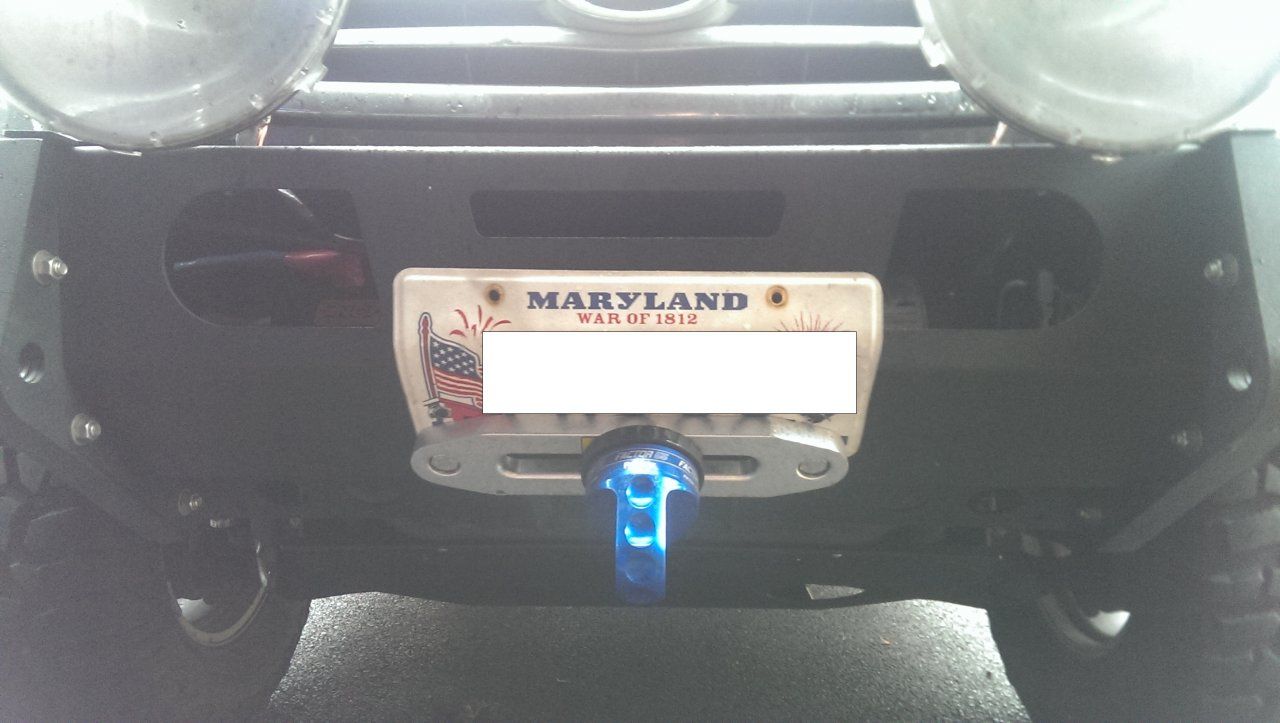

License Plate Hack Job. Didn't want to drill new holes in my pretty new bumper so took tin snips to my license plate.
