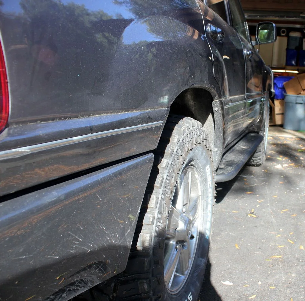

Tires Tires Tires.
Lots of questions on the tires. I took some pictures to show clearance on the UCAs and in the rear wheel well. The only place I rubbed was the front fender well but I cut the plastic and have had no problems. I have 2 offroad trips planned next month so I will update after them.
Looks great. I'm curious to hear how the tires fit once flexed in their natural habitat.

if you have time take more pics of the AHC lines etc as for your tires you don't have a regular front bumper you think the tires would rub there? I know its just a guess but any info or opinion is appreciated. thanks again
