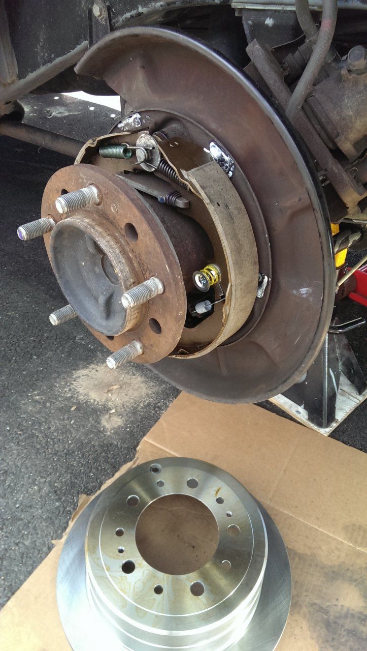

Minor update. I had some sudden grinding/screeching coming from my back brakes. I knew the problem since I had the same thing happen on my 4runner. E-brake pad had come loose. Not sure what spring initially came off since I had to pry the rotor off. Everything back together but need to adjust some more since I am still getting some rubbing. Not a big fan of how the e-brake works.

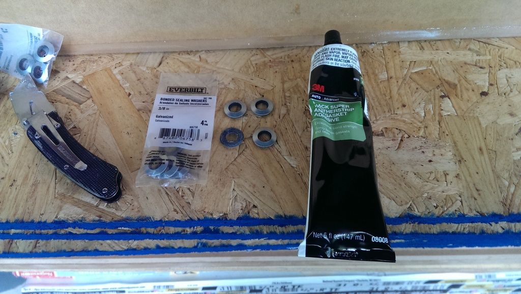

- RTV needs to be used on the bolts. I ended up using some weatherstripping adhesive/sealant I had lying around after redoing my real door seal. It will leak without this & possible the lack of washers - ask me how I know.

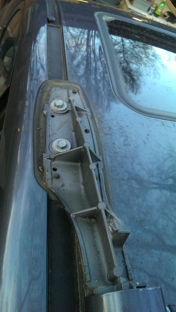

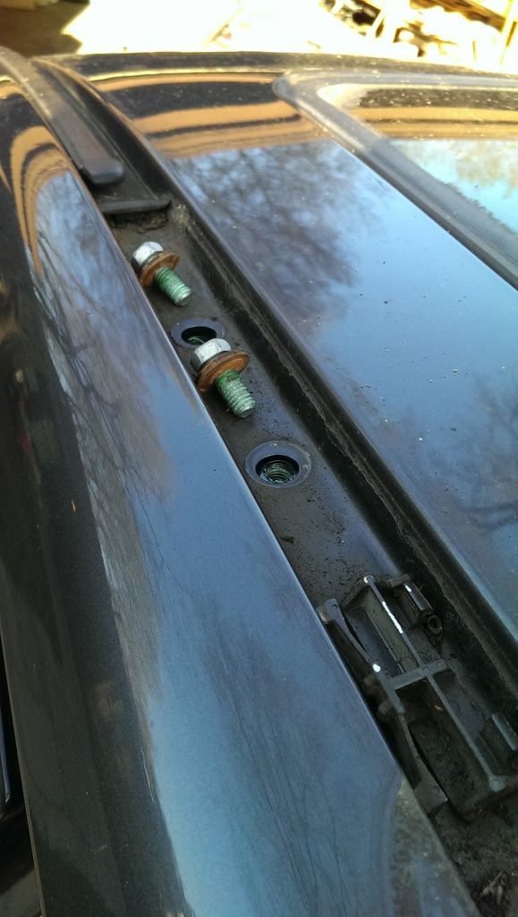

Pictures showing various stages of install. I wasn't able to get pictures of the sealant and the washers going it b/c a storm came in and I had to get everything buttoned up quickly. Question welcomed.
I used plastic door trim tools to pop off the factory covers
2 bolts front and rear to remove the factory rails
Popping track out
New SS bolts note the washers that go into rack towers are custom cut

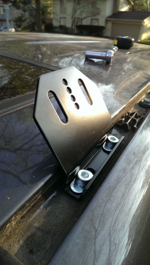

More Pictures - Gamiviti Rack
Bottom part of tower installed. I used the 2nd from the top of the 4 middle bolt holes for the front

Bonded washers and sealant. I used the sealant on the bottom of the washers and the bolts
Last picture I got before the rain. I cleaned the bolt area and out the bonded washers down with the sealant on the bottom which helped keep them located to the holes.

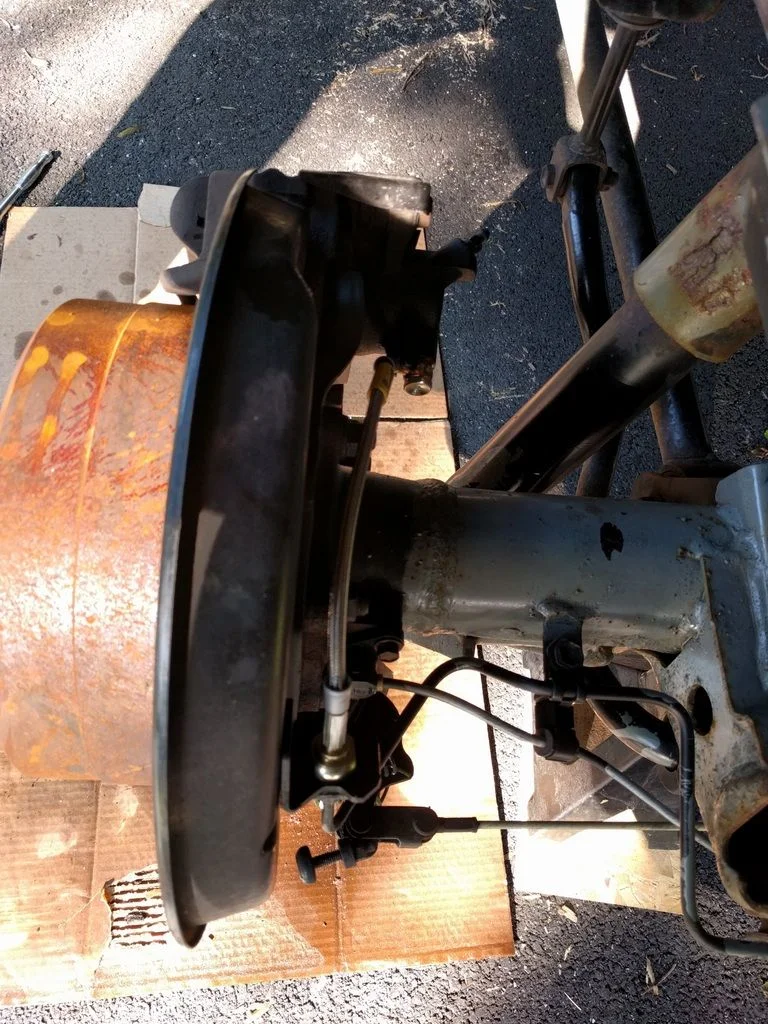

Had a busy weekend working on the truck. I set out to repack the front bearings and install my new SS brake lines/flush system - I managed to get both done. The repack went smoothly but ran into the typical problems with the brakes - seized nuts on the hard lines and corroded bleeder screws (I had new ones in my cart when I ordered my parts not sure how I ended up without them).
Anyways here are a few pictures unfortunately not many - I was pressed for time. I will do a full review on the Goodridge SS brake line install shortly but for now here are the few pics I have:

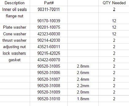

Do you happen to have a parts list of the parts you needed to repack the front bearings?
I've been searching for a while but cant seem to find a good write up on how to repack the bearings without replacing them.
