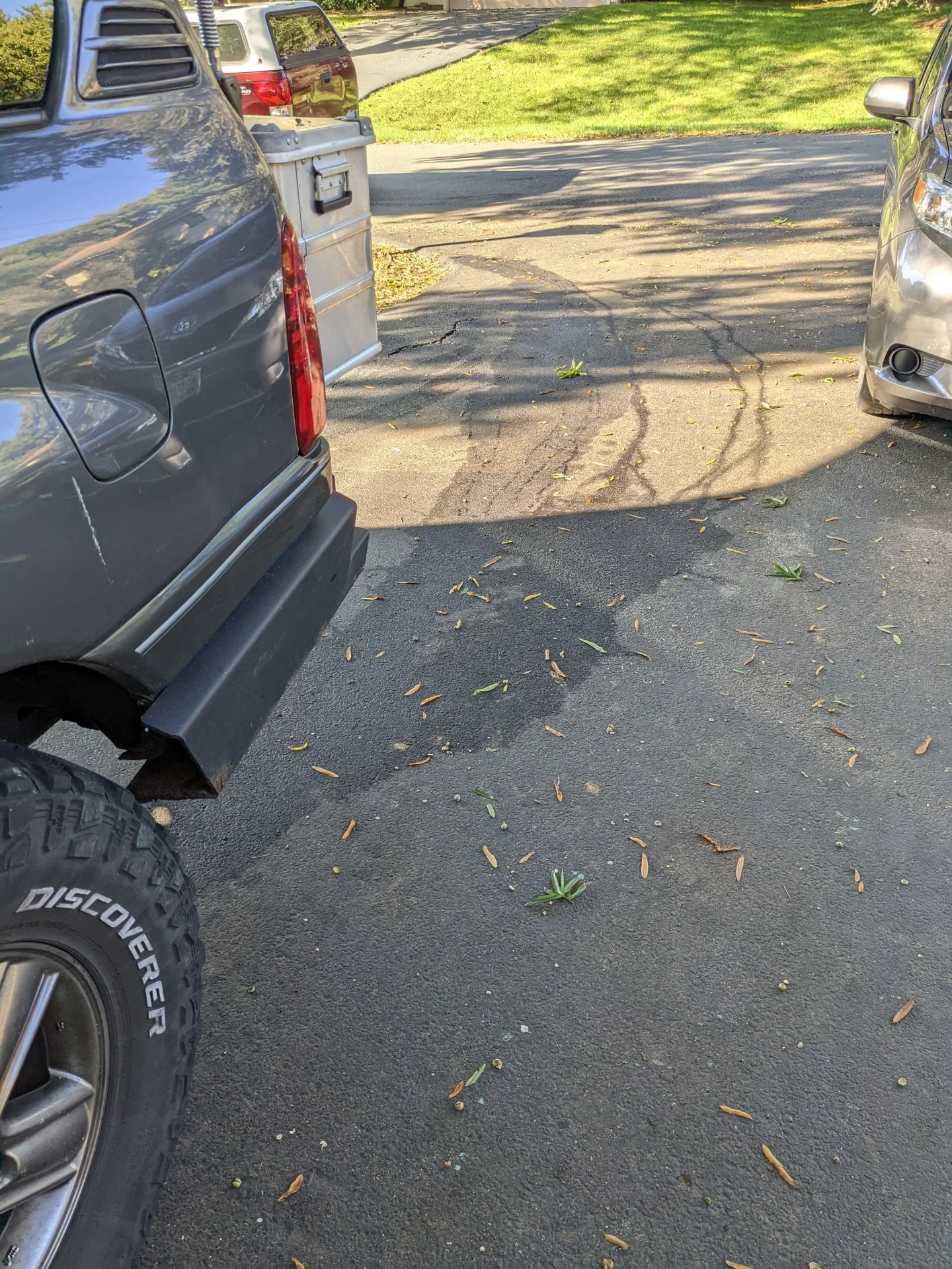

Well the LX noticed and she decided to speak up. I came out to this in my driveway.
Initially it was dark and raining and I didn't notice and drove it only to have the AHC turn off and have to drive back home very slowly .

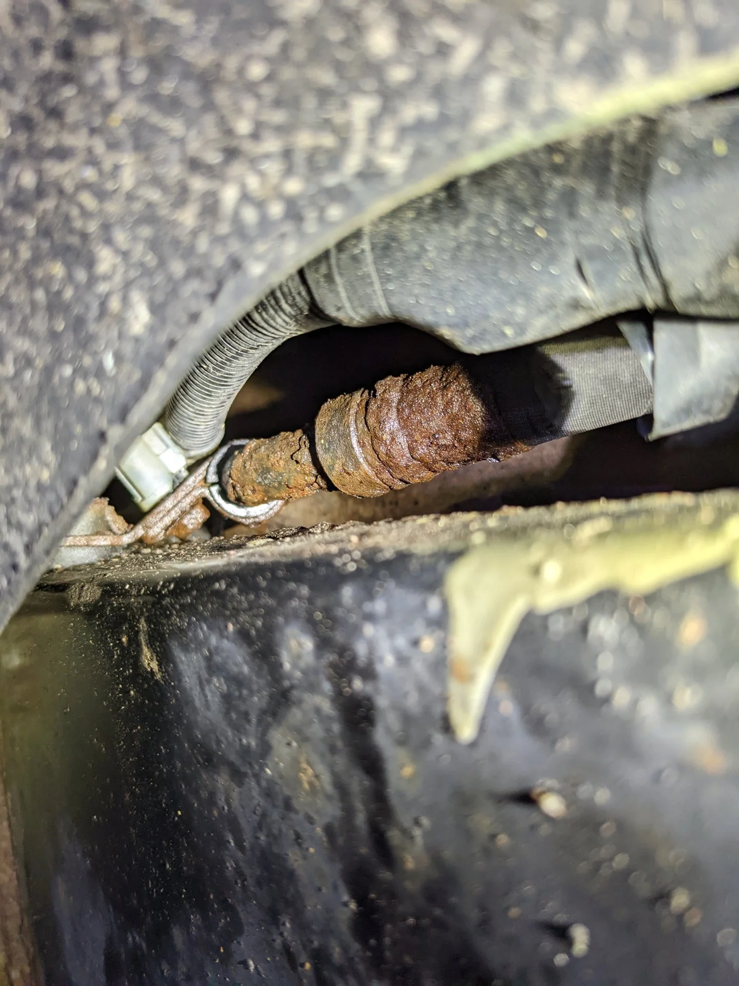

Here is the issue:
Funny thing is I refilled the reservoir a drove it a few times and it held. Then leaked again.
Other lines and the shock bodies are rusty too. I don't see a reason to spend the $ to fix so most likely going to swap out. Doing research now but learning towards Dobinson. Will document the removal of the AHC and install. Also need a new steering rack so will probably do that at the same time.
