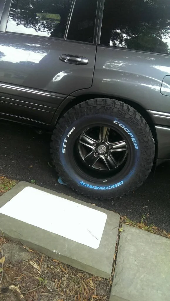

Tires Tires Tires
Specs/Setup
Make - Cooper
Model - STT PRO
Size - 295/70-18 (Manf stated size 34.6")
Suspension Lift - None
Body Lift - None
Initial Impressions
I only have ~70 street miles on them so far.
Fit - Only place I am getting contact is the passenger side plastic on the bottom edge when turning near to full lock. Keep in mind this is only street driving so far, I will update when I flex the suspension a bit. I will be cutting the plastic but may wait until I get my sliders on first.
Noise - Slight hum at low speeds. Surprisingly quiet at higher speeds. My nitto TG where much louder.
Power - I haven't noticed a drop in power yet. Again will report back with I do some more elevation changes. Highway driving is smooth with no noticeable down shifting. At lower speeds I definitely notice a heavier tire is on there.
MPH/MPG - Speedo is off by ~4-7mph. I have not calculated MPG yet.
Mounting/Balance - 2 out of the 4 balanced easily the other 2 I had problems with although I think it was more user error. I am going to try and re-balance the other 2 today.
