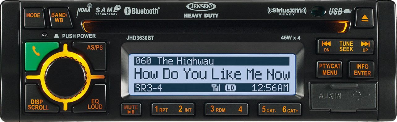

Here's a link to the latest Bluetooth JENSEN...
http://www.heavydutyradios.com/jhd3630btb.html
Once it pairs, shouldn't it automatically connect when you enter the car? Most bluetooth devices do this.
In fact, I can be talking on my iPhone, and as I enter my car and start the engine, my phone call will automatically switch over to the cars speakers. Will this not happen with this Bluetooth Jensen? I don't plan on using the Sirius, and will probably install this in a Tuffy console.
Anybody here have this bluetooth Jensen working as a hands-free telephone? But if I have to pair it every time I enter the vehicle, that's a deal breaker. I find it hard to believe, tho.

From the Manual:
"NOTE: If a Bluetooth device is disconnected due to the power being turned off or if the device is disconnected inadvertently, the unit will automatically search for the matching BT mobile phone when the power is restored."
http://www.heavydutyradios.com/jhd3630bt_owners_manual.pdf
I think a call to Jensen will answer your question.
Yup.. the product review on Amazon seems to confirm this. And, there's a big green phone icon button to answer phone calls.
