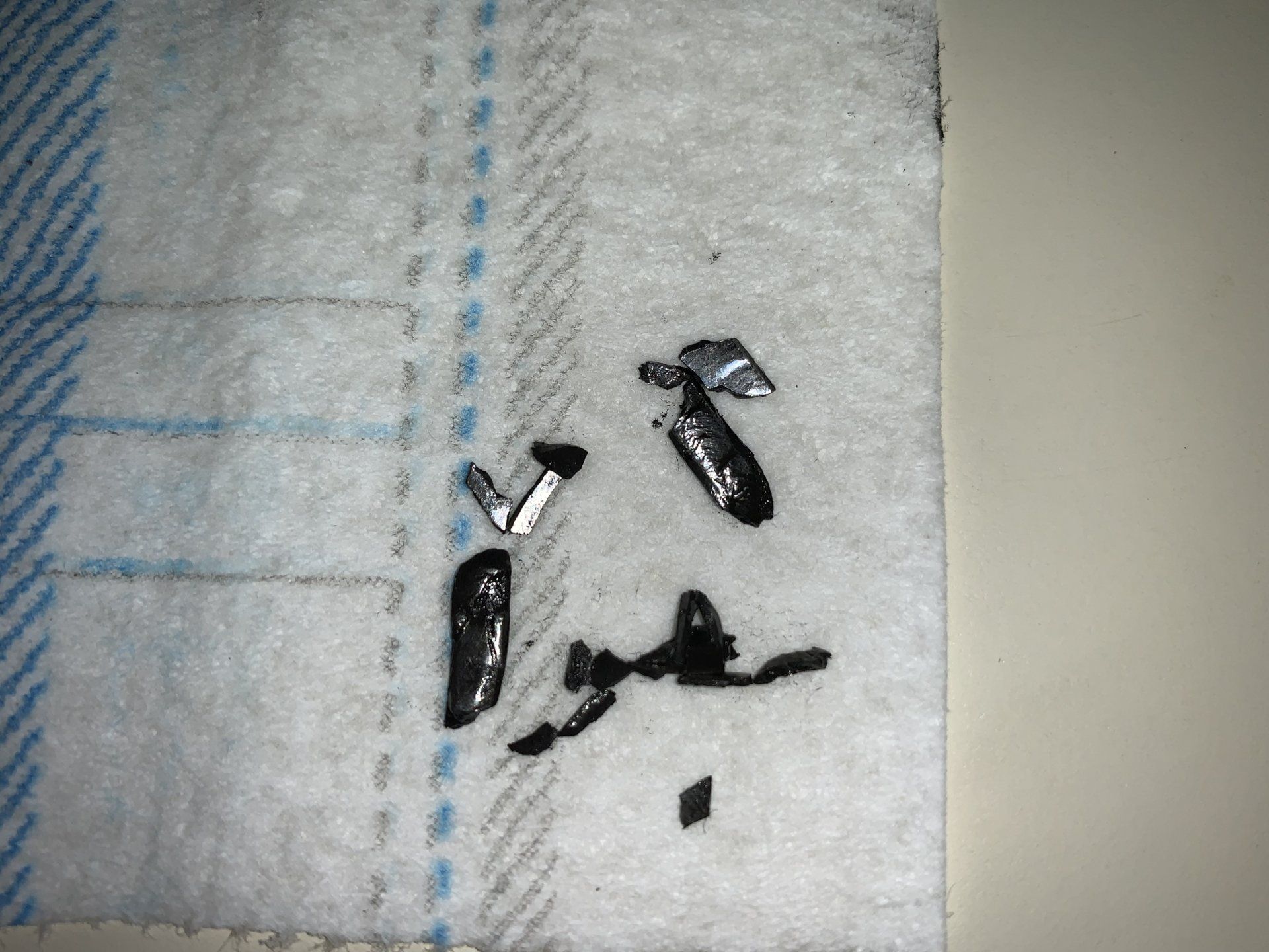

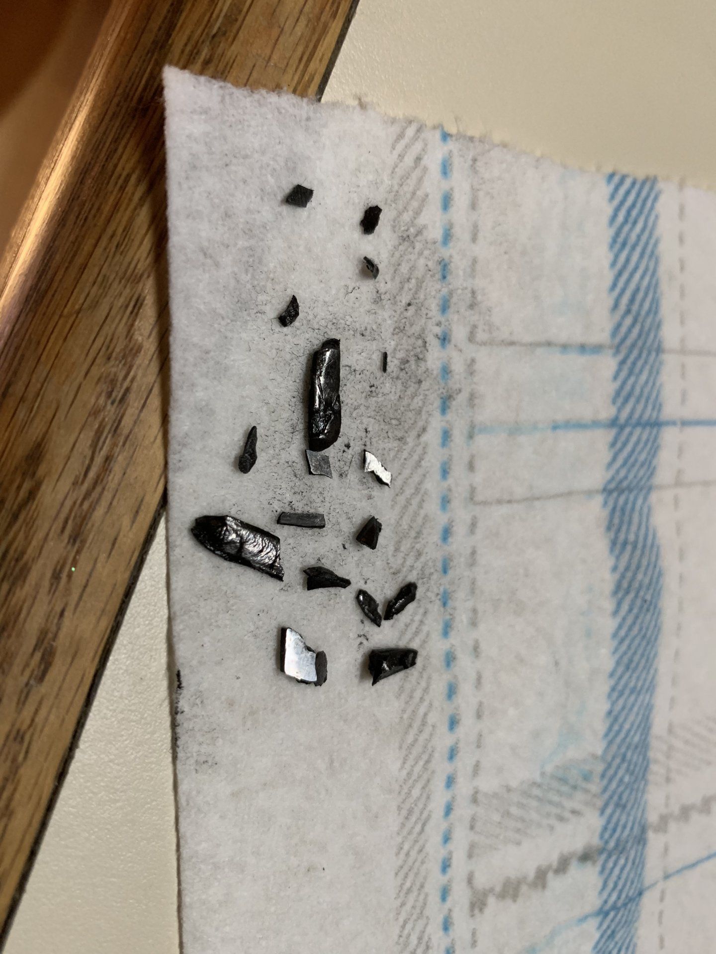

I decided to save the ~$150 per gearbox my oil changer wants, and do the diffs + TC myself. When I pulled the drain plug I found a mess of metal chunks ... exactly what you DON'T want to find. I've definitely put her through a few torture tests on rocks but its been at-least 5k since and I haven't noticed any issues except increasingly extremely poor fuel economy (11.3MPG avg).
So I'm asking - is there any chance everything is OK? am I just lucky as hell? Do I need to replace the diff immediately? Is it worth pulling the cover and inspecting further or do I just need to get this rebuilt?

I would definitely pull the cover and inspect further.
If it was me, I would rebuild the differential.
Yet first things first... pull the cover and take a look.
Well, no problems to date so it's probably not in imminent threat of grenading during normal daily use.
But, there is definitely some missing, or partially missing teeth on your gears so it should be addressed before you plan to test in the field again.

Those are not shavings... they are CHUNKS OF METAL.

Bad news is its probably done. You can inspect everything with the diff pulled, but there are probably small shavings that damaged the bearings as well. New gears and a master kit in your future.

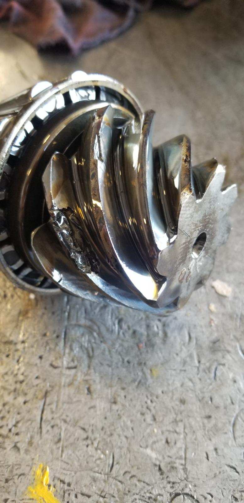

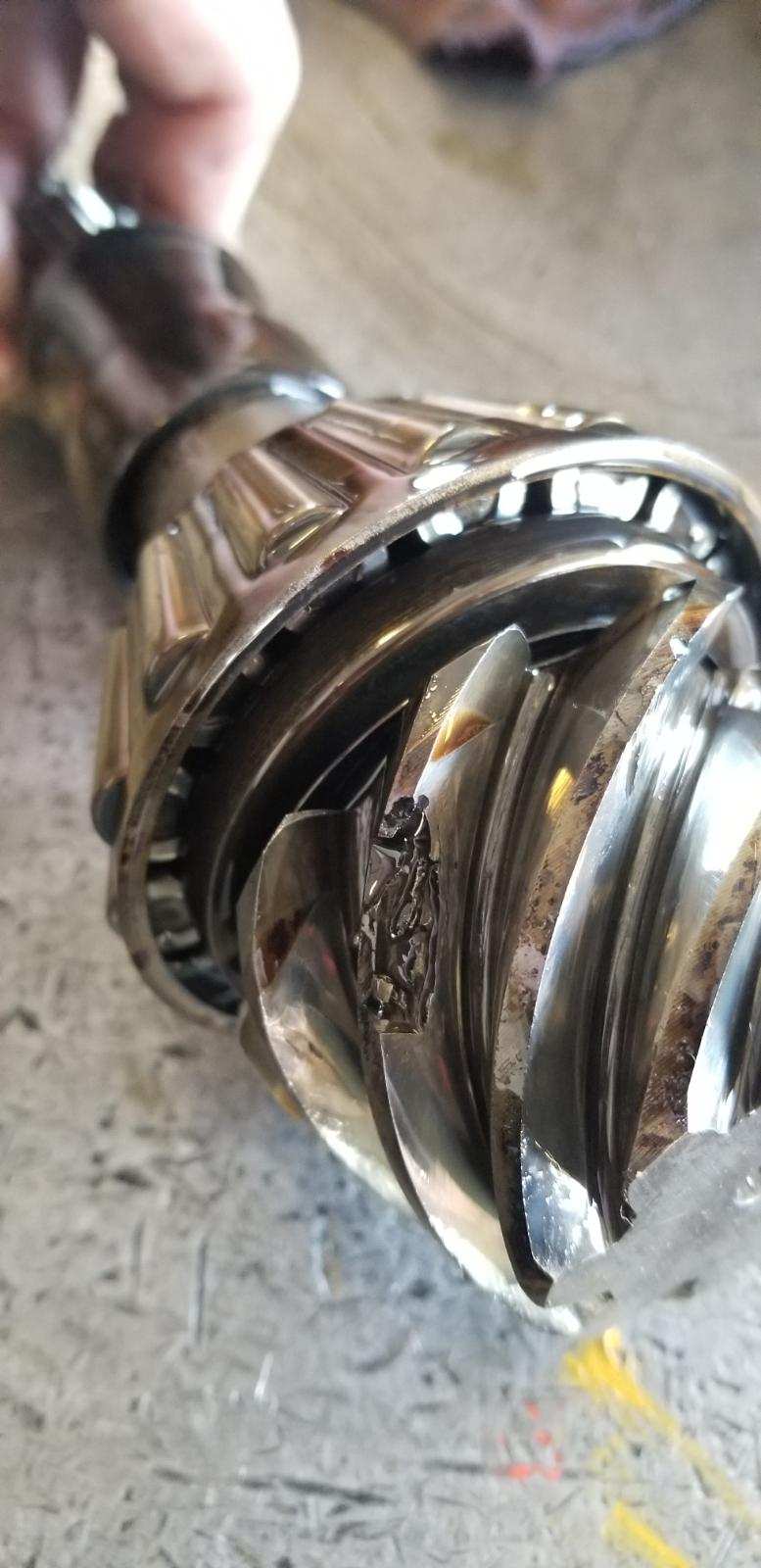

Thanks all. I would either stick with 4.11 or go up to 4.3 on both F and R, not attempt mismatched. I pulled the front diff this weekend and took a look at the ring gear. This makes sense why it still works without feeling anything. The whole diff is shipped off to Zuk for a rebuild and locker install. I'll wait for him to pull it apart to see if anything happened to the pinion. I'm also pretty curious what the backlash currently is and forgot to measure it.
