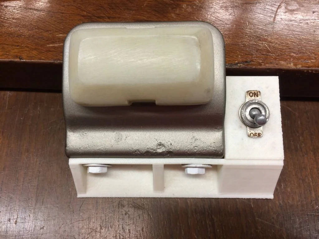

But if you're looking for a rattle can, over the counter match to oem pewter, the color found on a ton of trim parts. This is the one. Look no further.

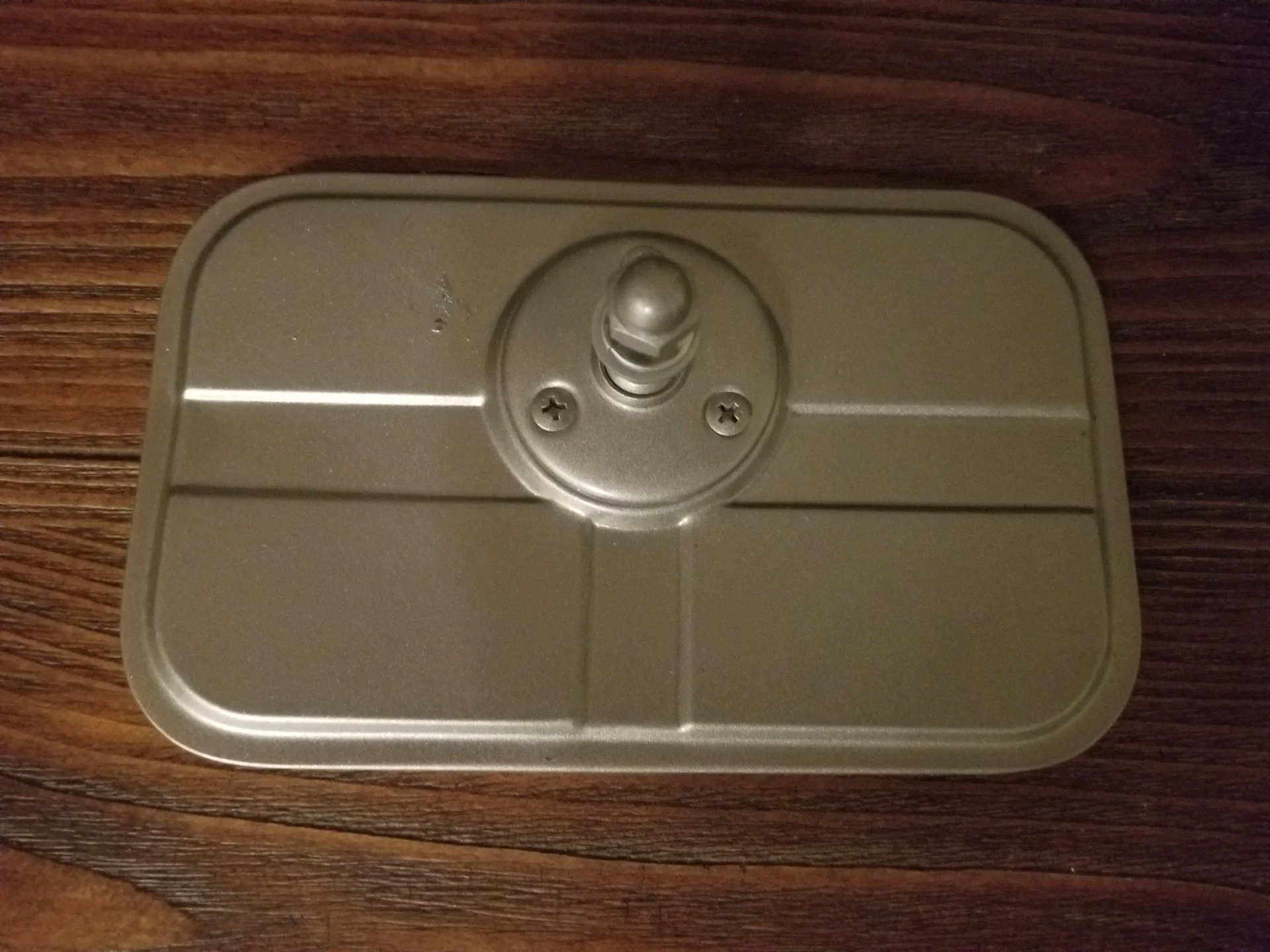

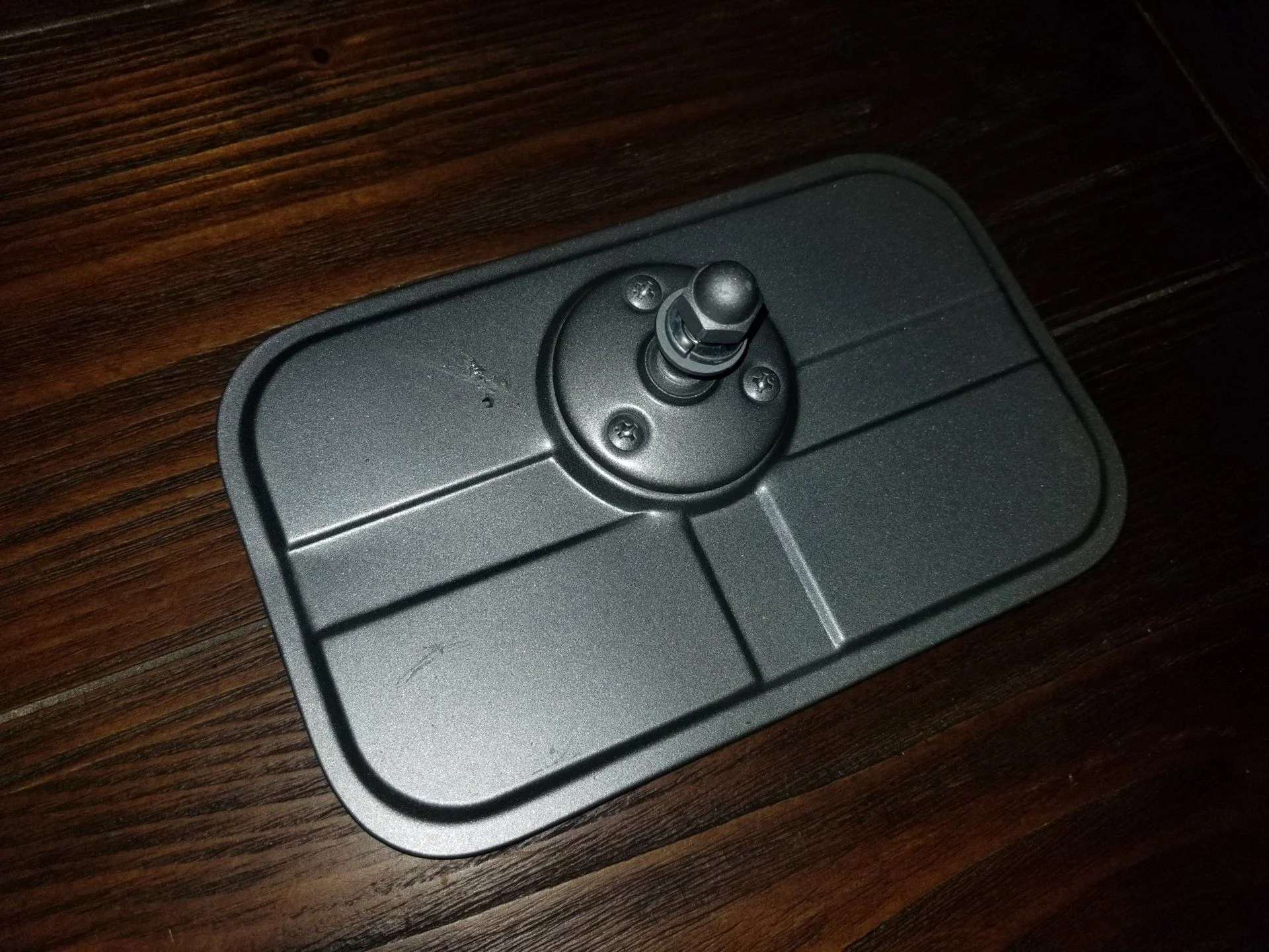

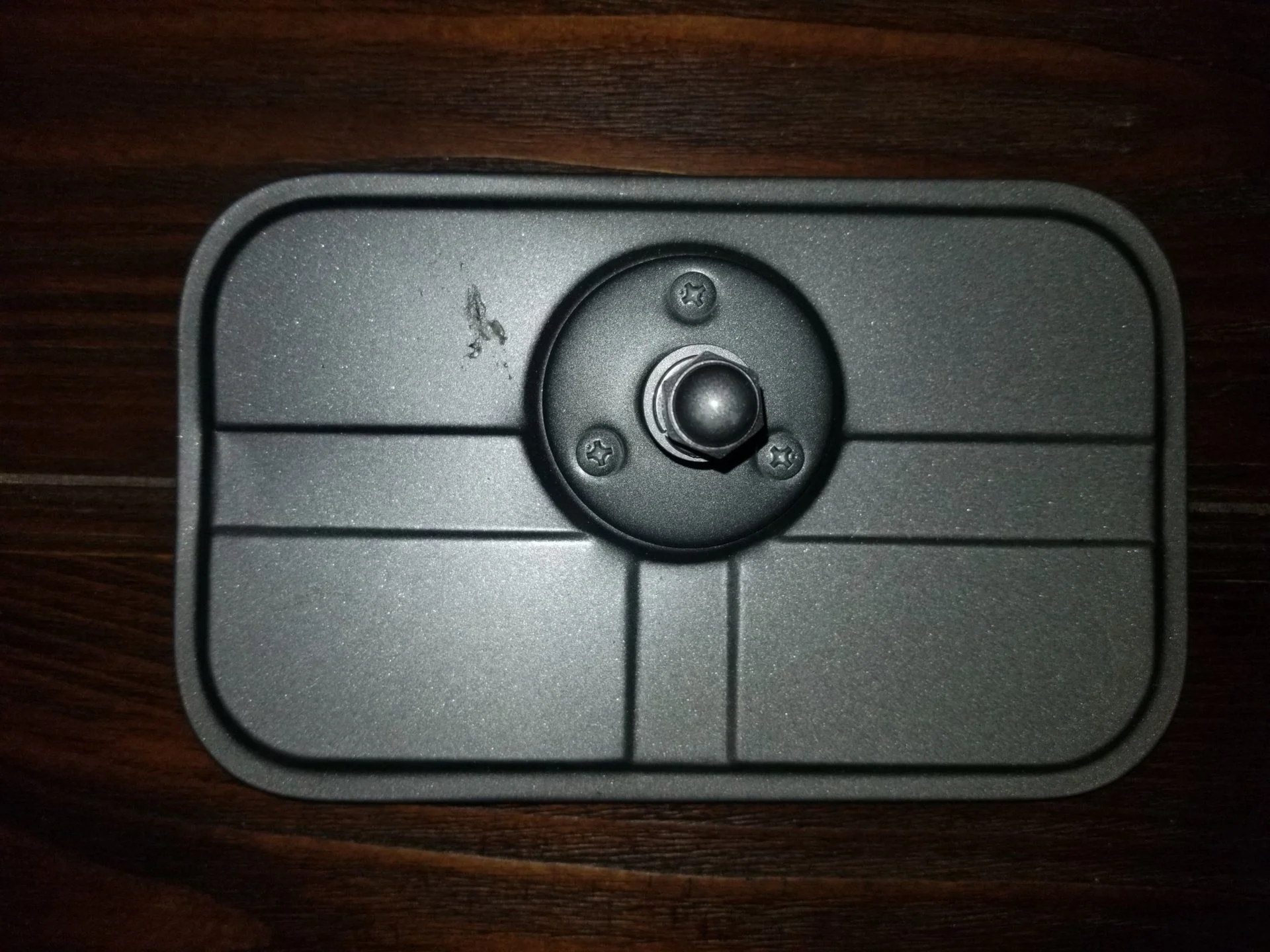

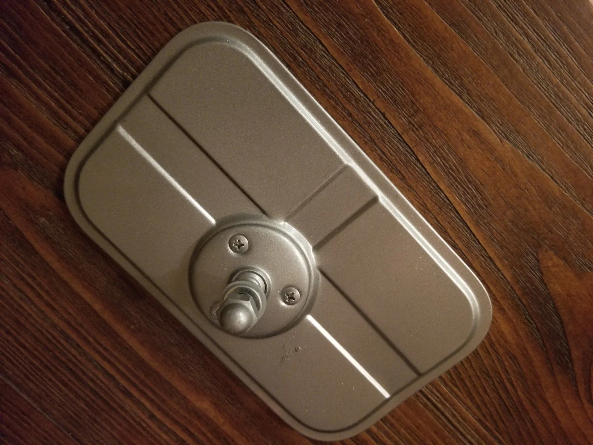

The picture is of an OEM mirror head that's been painted half way with this paint. I can't tell the difference from any angle or any light.
The paint is duplicolor stainless steel.
More pics in different light. Does a really good job of mimicking the metallic...
The key is to shake the hell out of the can...

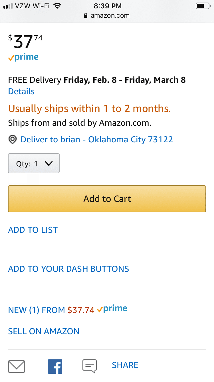

That didnt last long...
Somebody at Amazon is trying to figure out what just happened! LOL! Cases of this stuff being ordered all over the country within hours of each other?
