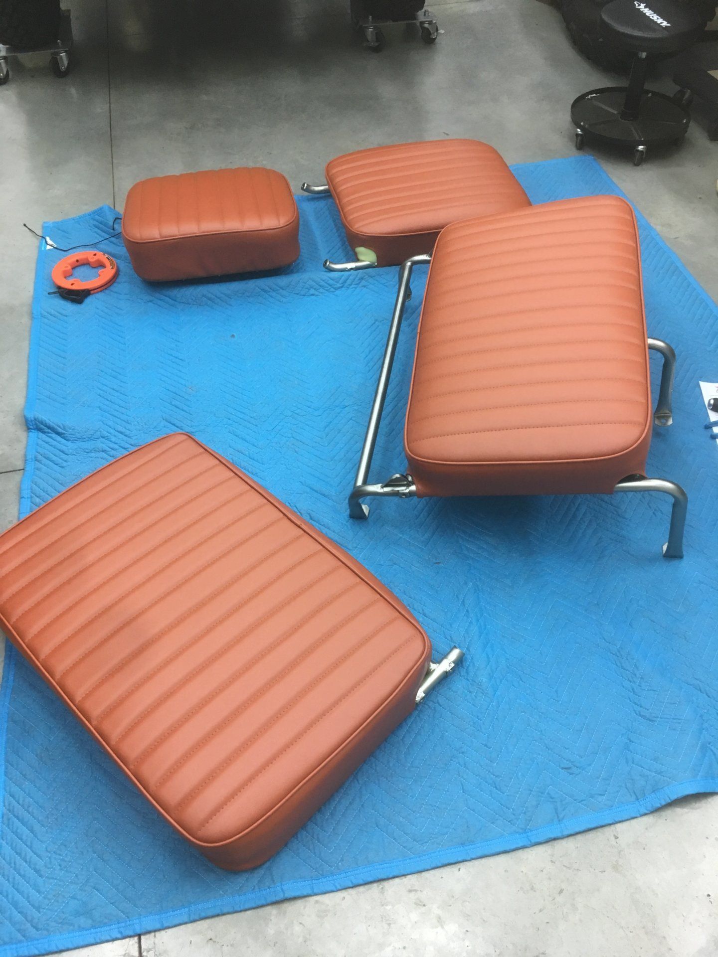

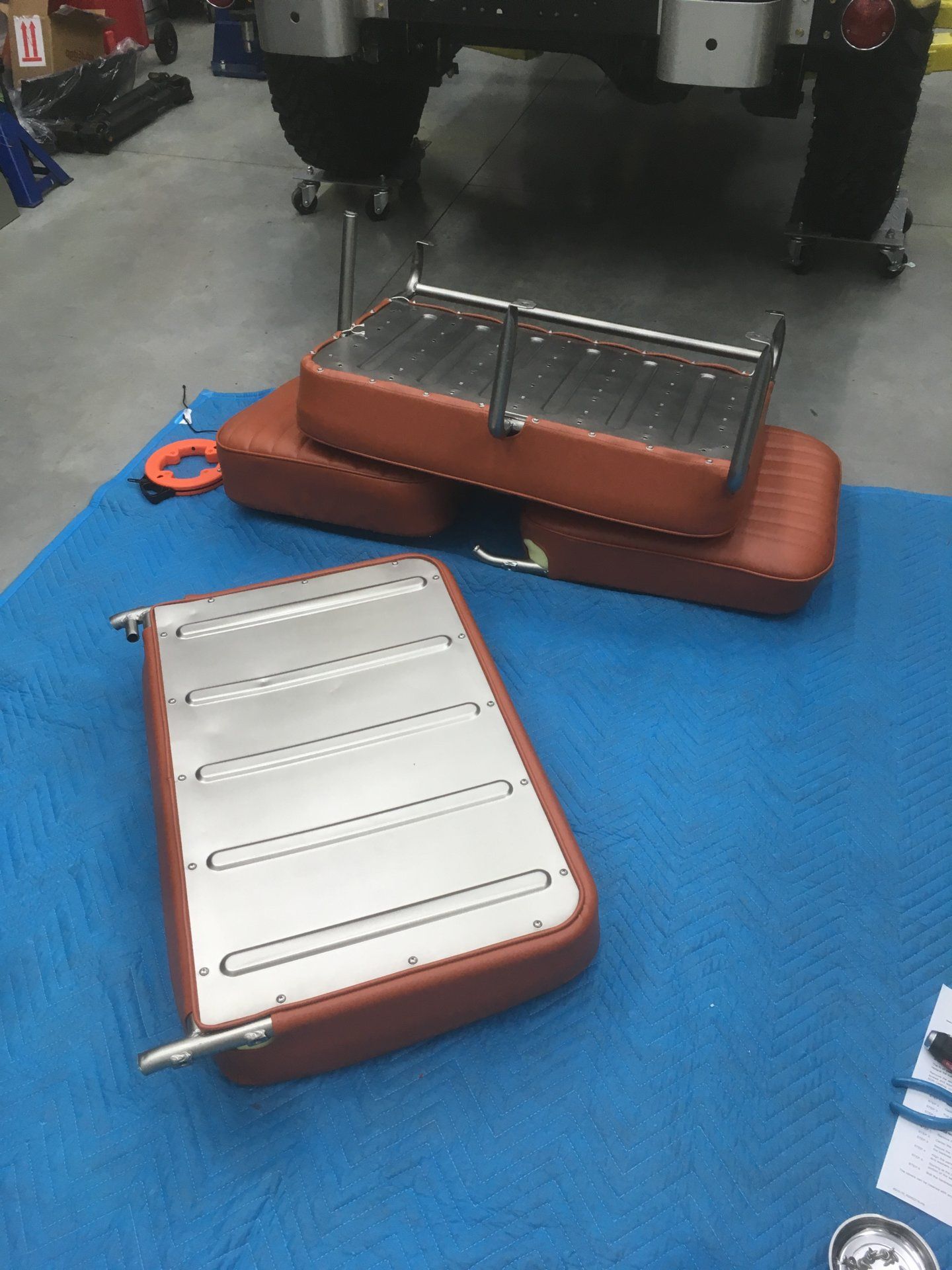

I've got OE seat frames, back panels, all parts, to paint and I'm a little hesitant to get the OE seat springs powder coated. This is my next move. While I'm at it I'm going to do the glove box and Ash tray doors.

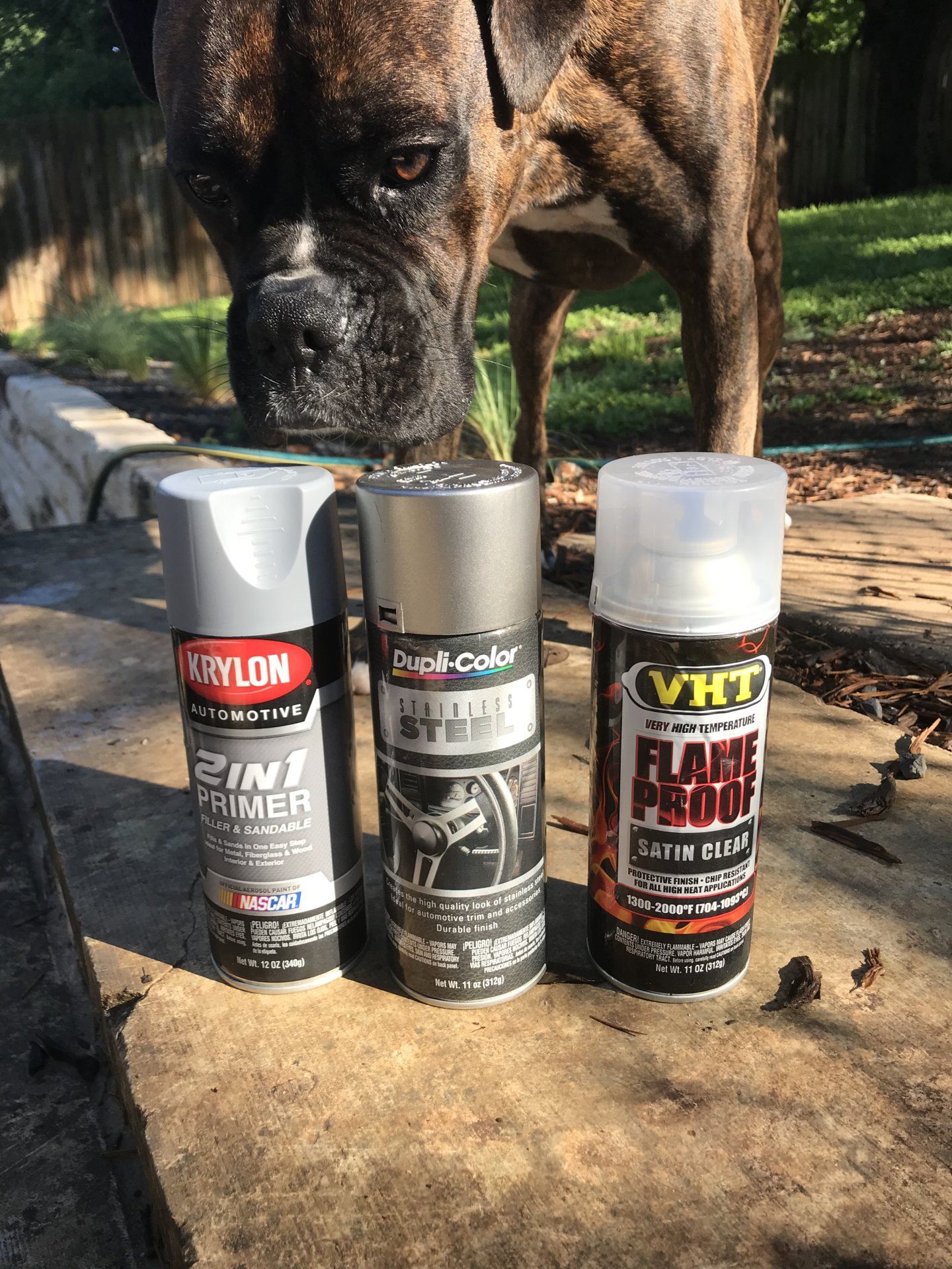

I called Dupli-Color, asked about priming bare metal because I am getting a winch bumper.
Primer - DAP16190 or DPP101 self etching primers. DPP101 is from their professional line, will probably bond a little better to bare metal.
SS100 is an enamel paint. They told me it's a very durable product and doesn't need to be clear coated, and a clear coat will turn the SS100 a more dull color. They wouldn't give me a timeline on how long it would last exposed to the elements, because there are too many variables in that. I asked if I could use DAL1695 Clear Coat over it if I was set on using a clear coat, and they said no because it's a lacquer based clear. They don't make a clear that can be used over SS100.
ETA I called again to confirm SS100 was an enamel because their website says Lacquer. Yes, it's an enamel product. Their engine clear coat might work over it, but it would need to be tested first.

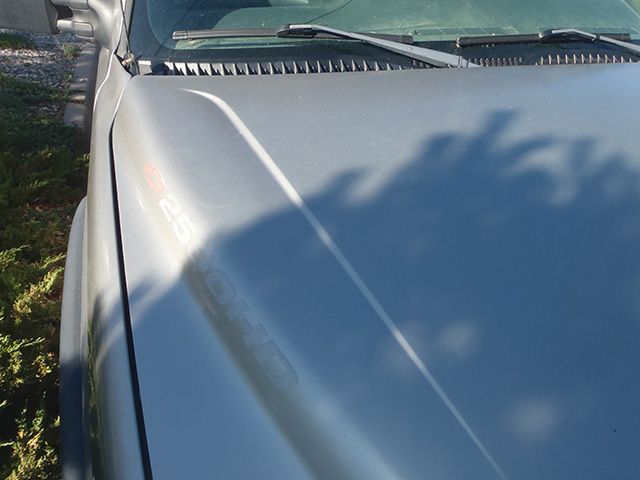

I thought the BGM0490 looked familiar. Here's what BGM0490 looks like in real life on my '01 Silverado 2500HD, after about 18 years in the Desert Southwest sun (GM color code WA382E, Pewter Metallic):
I might go ahead later today and pull a few parts off my '71 and '76 FJ40s and hold them up to my truck for a closer comparison.
