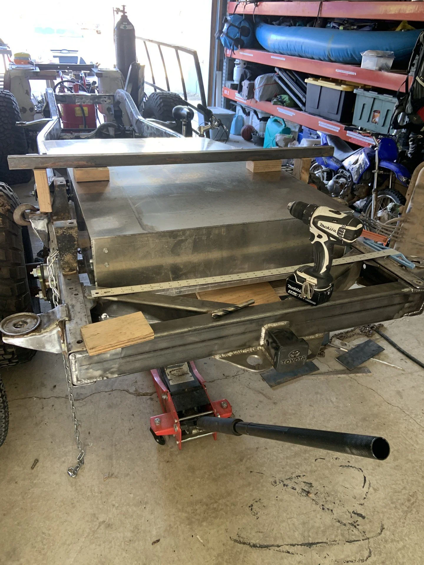

My dad and I mig welded a mild steel tank up for my Baja in the late 80s, in 99 we took it in our honeymoon on lots of gravel travel...man I changed a ton of fuel filters on that trip. Inside of the tank had chunks of rust falling off :(
On the list to fix if I ever get to it.
Tank welded out.
Mounts welded out.
Mounts drilled for bolts.
Gasket made for pump hat.
Pressure test next week, but I’m gonna cross it off the list and call it dun.
Time to start drinking.

How much clearance did you give between the top of your tank sheet of your tank and the bed of the rig?

So in post 17hundred and something, I had the lower half mocked into place with a jack and a come-along. The rest is blurry...
3-1/4” from the face of the tub mount to the bottom of the rib. 4” from the frame side mount to the top of tank. Subtract (or add) an inch for the rubber mount equals out to 1/4” clearance of the rib. Easiest way I can put it.

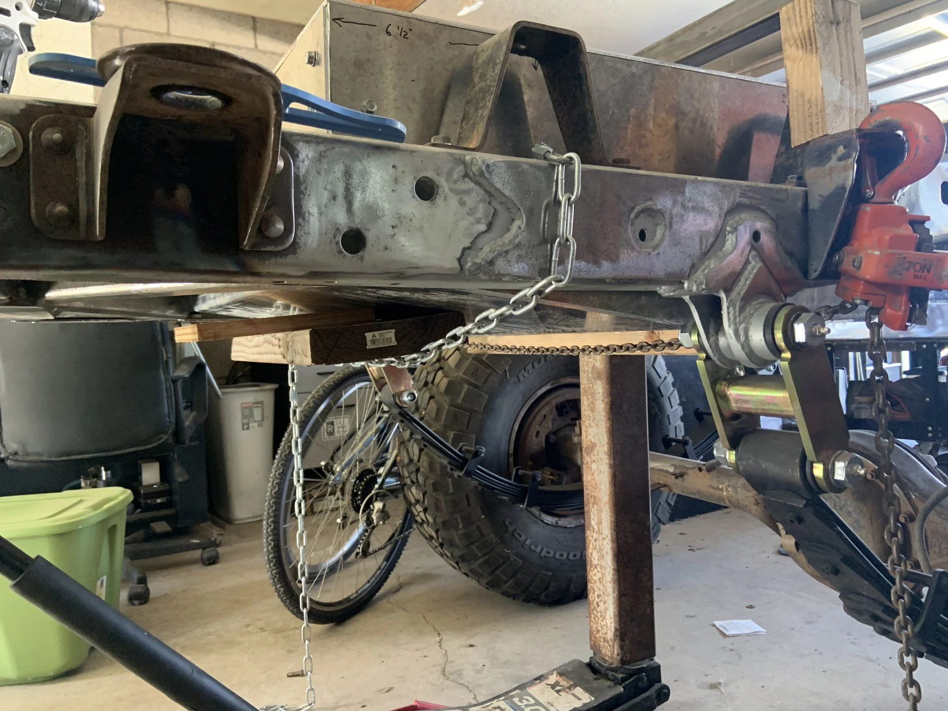

Mocked the tank up and measured out where the mounts will go.

I am trying to find the tank height without having yet bought my intank fuel pump. It seems like those hose connections might stick up a fair bit off the top of the tank?

The bulkhead fittings shouldn’t stick up more than 1-1/2”, at least I wouldn’t think. Won’t know until I get to that part. My contingency is either lowering the pedestal mounts or elevate the body as necessary. I have the material to make 1” body spacers.
