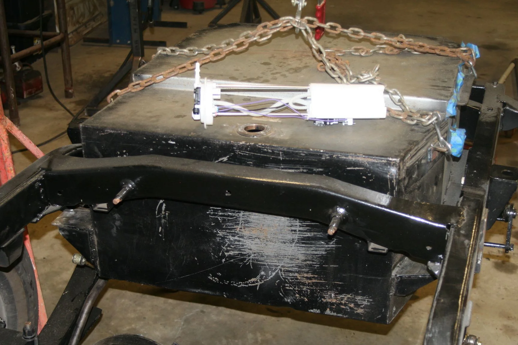

Ok, my tank is one inch behind the cross member and 2 inches from the pumpkin, but I use a Diamond axle, so might be different. It didn't hit the 60 axle though when I used one. Here's a picture of my tank with the step down for the pump lines. It is centered right under the trap door.
Damn, I didn't check that, be right back. 👣
Hard to get a good measurement with everything around it, but the step down area is at least 15" deep. guessing the step is an 1 1/2" and the tapered other end is 14 1/2" deep. She's a big girl! :)
Think that’s what I have. It’s huge. Let me know if you need measurement.
