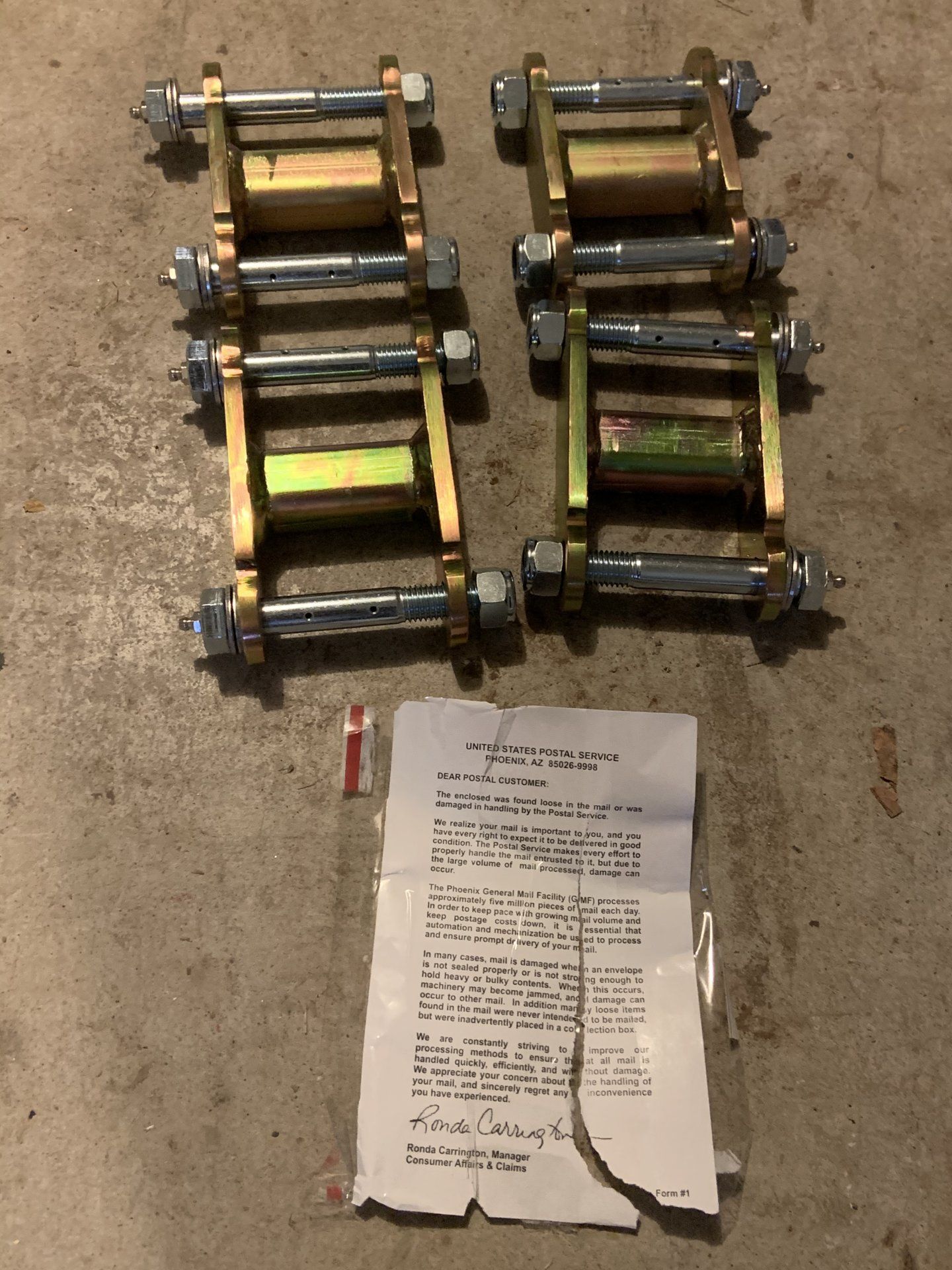

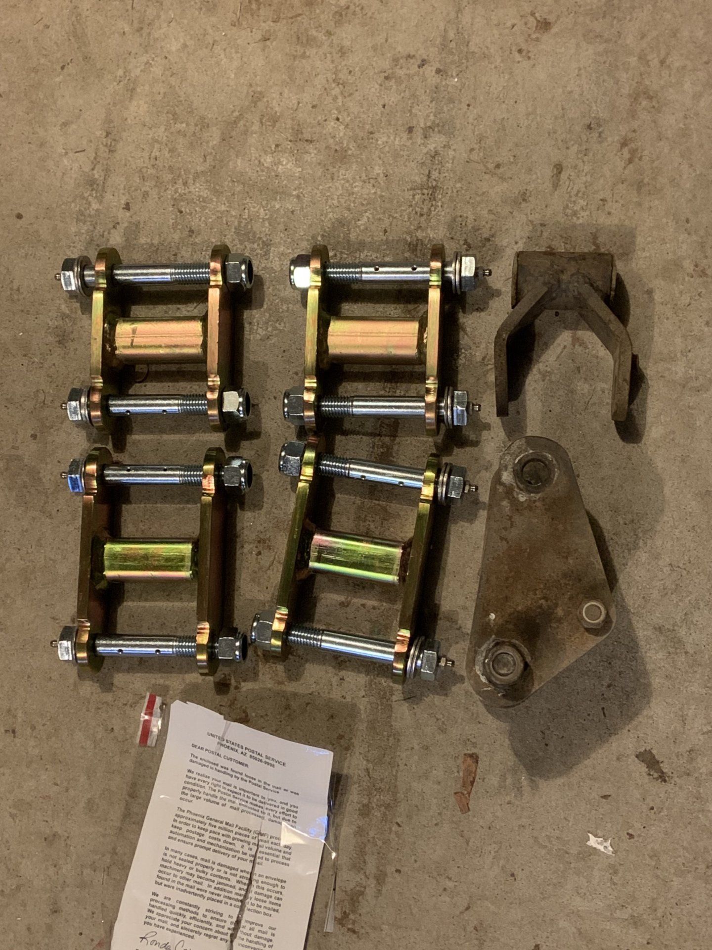

Yaay! Parts delivery for me today too! Oh boy - shackles😃 Along with a note from the US Postal Service saying the contents broke free from the packaging. No worries - don’t think you’re gonna hurt shackles too much. But c’mon CCOT shipping department, really?
Lower pic a comparison to what was formerly on the rig. Rear lengths are the same. The new fronts are only slightly longer, not enough to change much.

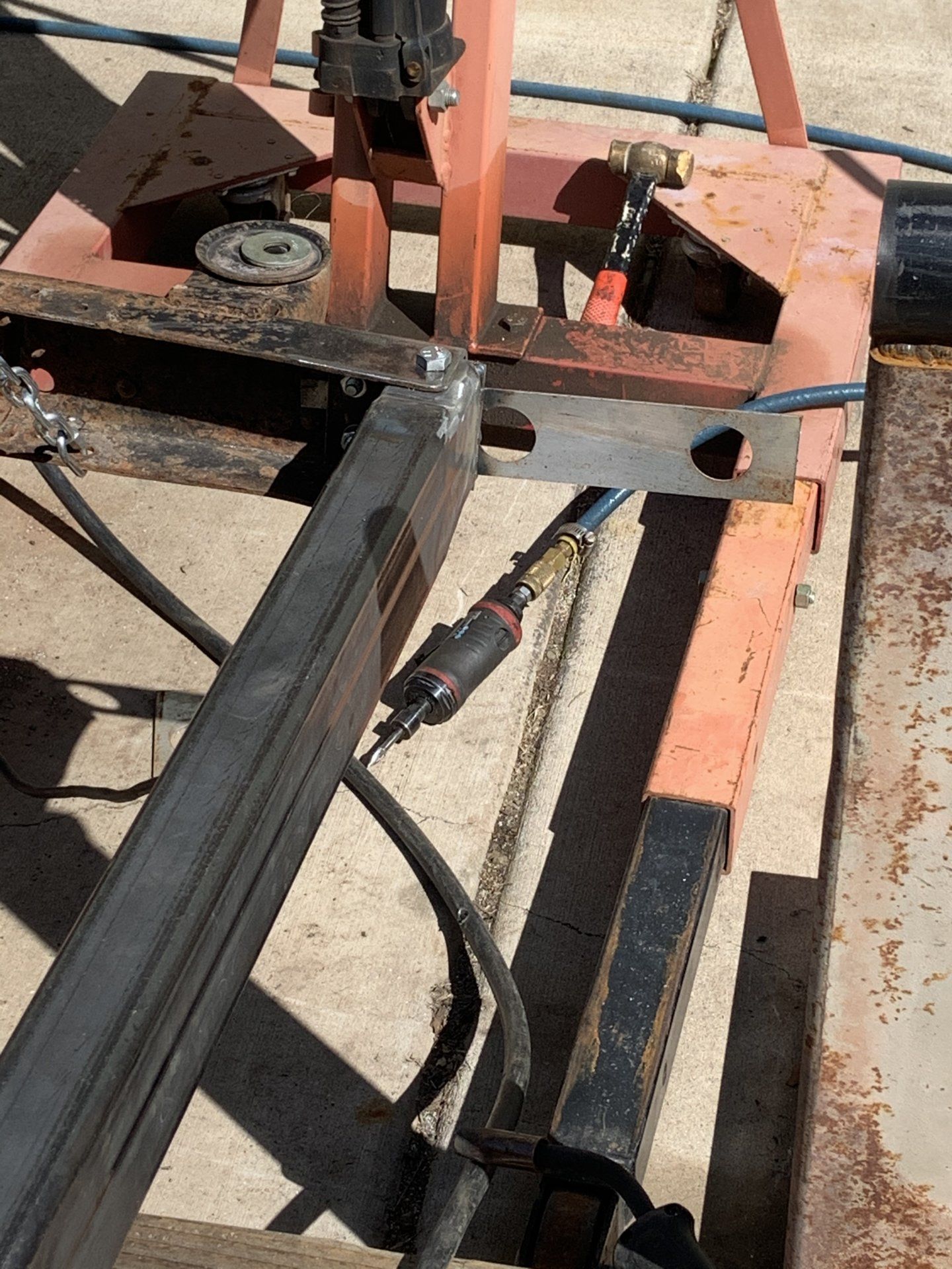

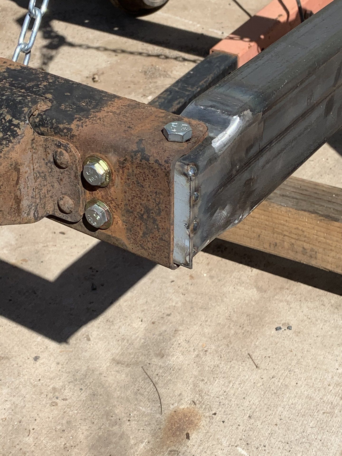

So nice to get rolling on some Cruiser work today. Put some end caps on the rear crossmember/receiver that will bolt through the closest holes in the webbing. Have always had fitment issues with pieces like this, so this time shimmed it out ~1/16”, bolted it tight then tacked.
Also tacked on the new passenger front scab plate.
