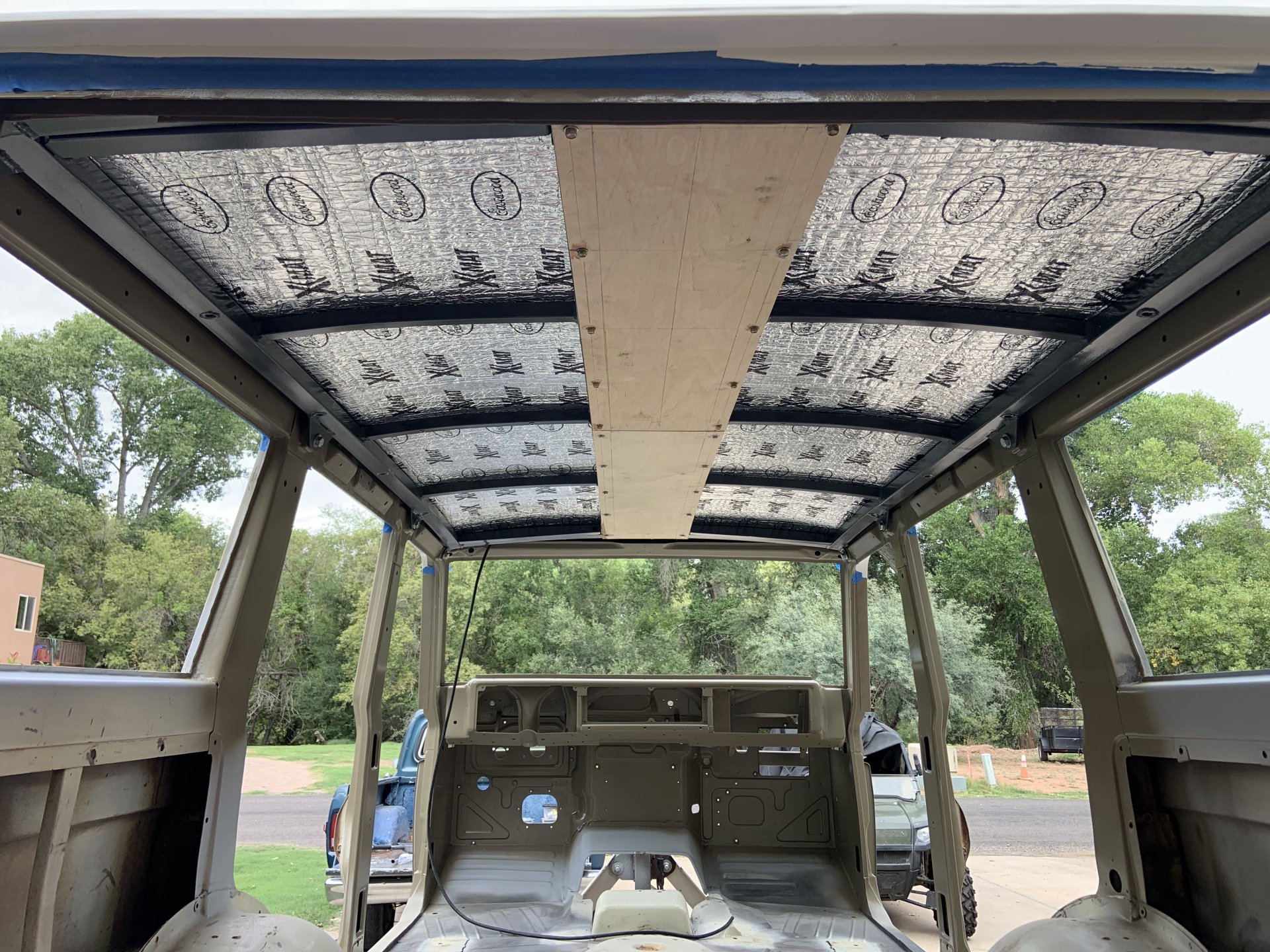

Picked up some of Eastwood’s X-Mat for the headliner (1/4” thick). Laid that in, put the overhead rack in for the last time. Filled the large voids with Dynaliner (3/4” thick).
Prior to all that, painted the underside and outer side of the drip rail with the “Pure White” Acrolon.
From this point, I’m done with doing anything else on the rotisserie. Need to gather everything for the fuel pump setup and get that installed along with the sending unit. Once that’s done, the tub goes back on the frame.
Whoa! Body is going back on the frame???
Isn't that crazy when the project goes from taking things apart to putting them back together?

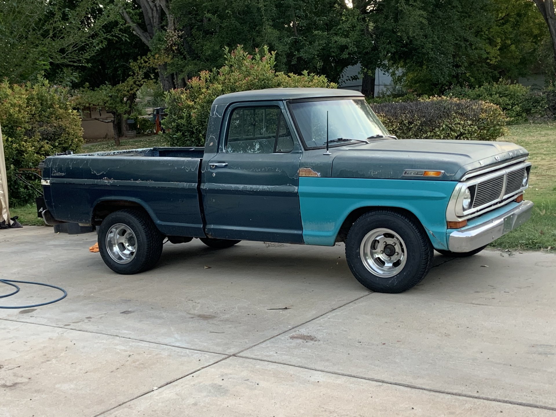

🤩 the Fords. What yours have for engine?? Who's Supercab ❤it. Got to go. Idaho potato 🥔 😋 truck just drove by 🤔😉🤪😳🙂🤣🤣🤣🤣🐷
390 FE yeah baby!
The extended cab is a guy’s here in town. Just finished putting a Holley Sniper kit on it. Think it’s a 400, but not 100%on that. Sweet truck.
