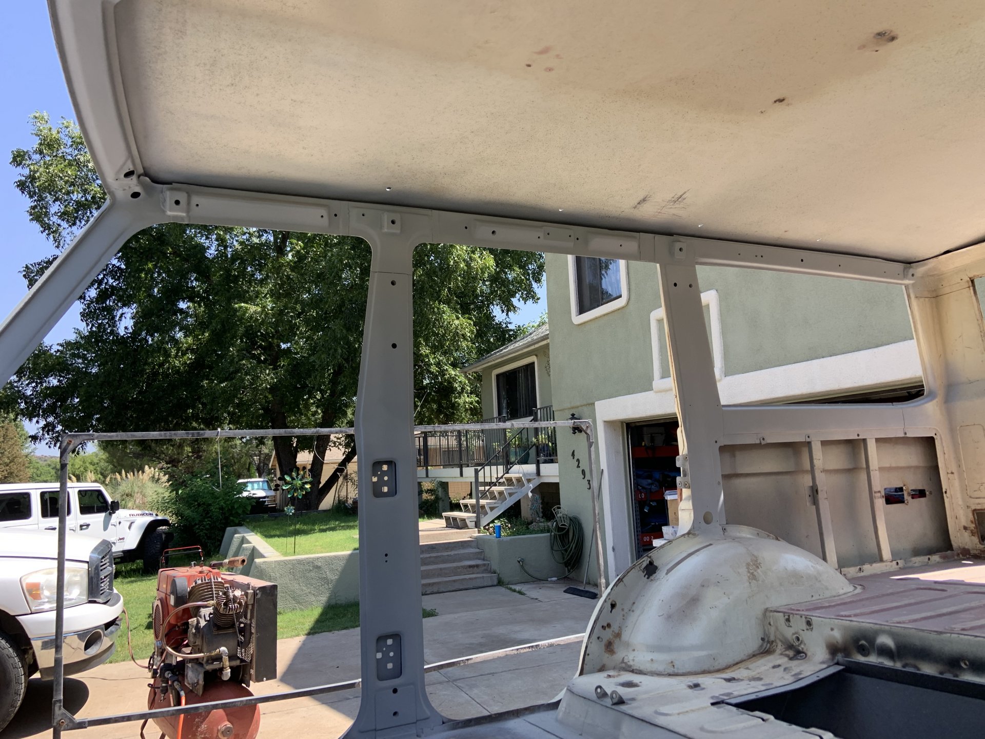

Finished off the first gallon of 2k primer on the dash, inner firewall, pillars and ceiling header. Filled in the old throttle linkage hole.

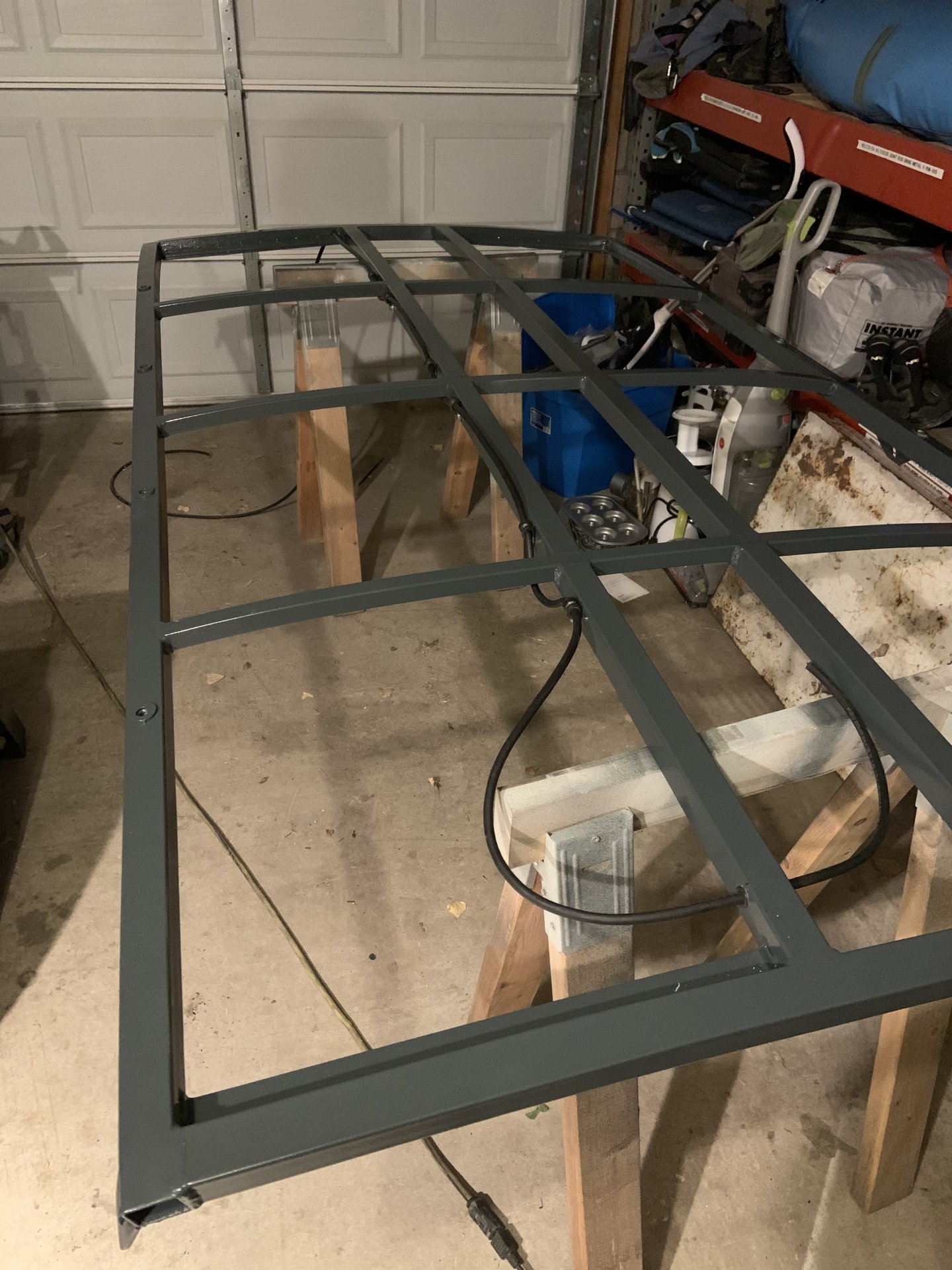

Finished up painting the internal rack and new front seat pedestals with Graphite Acrolon.
Just finished watching that video and wish I had known about that when I built my rack!
Yes, very helpful, as well as another video I watched about weld sequencing when fabricating that help reduce warpage. Being a welder for 20 something years, you think I would have been more savvy to that kind of stuff, but no, always learning.
Anyways, wouldn’t have been much of a deal if I weren’t planning on mounting a roof rack through the roof to the internal rack. That being the case, I wanted to try and get it as flush fitting as possible.

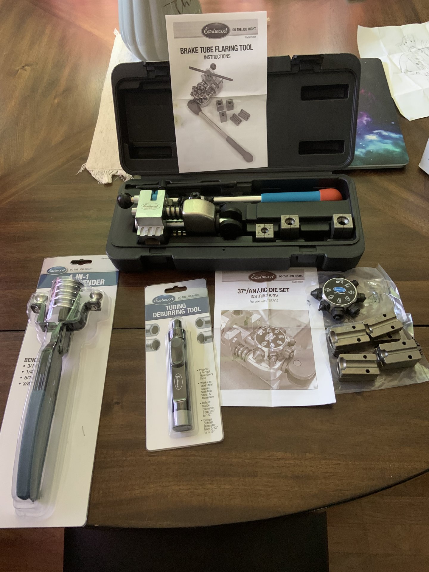

Doing it right the first time! good job. I've found some of my brake flares on factory 80 series hard lines are weeping at the unions..no doubt with that kit you wont have similar issues.. I also did not anneal the hardline before flaring which likely impacted my end result too
Now that’s something I haven’t heard of. Are you supposed to anneal the ends before flaring? I’ll be using the Fed Hill copper alloy line. Don’t recall seeing the need for annealing from either them or Eastwood.
I never annealed any lines that I built when restoring from ground up. News to me. No dead customers came back to sue me?
