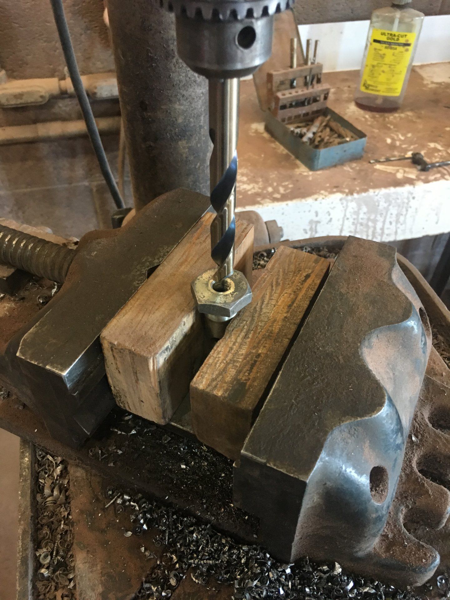

Drilled out the oil cooler banjo bolt (or whatever you want to call it) mystery threads (British Standard?) to 1/4” tapered NPT. Drilled down about 3/4”, threaded about 1/2”.
Get this put together when I get home.
